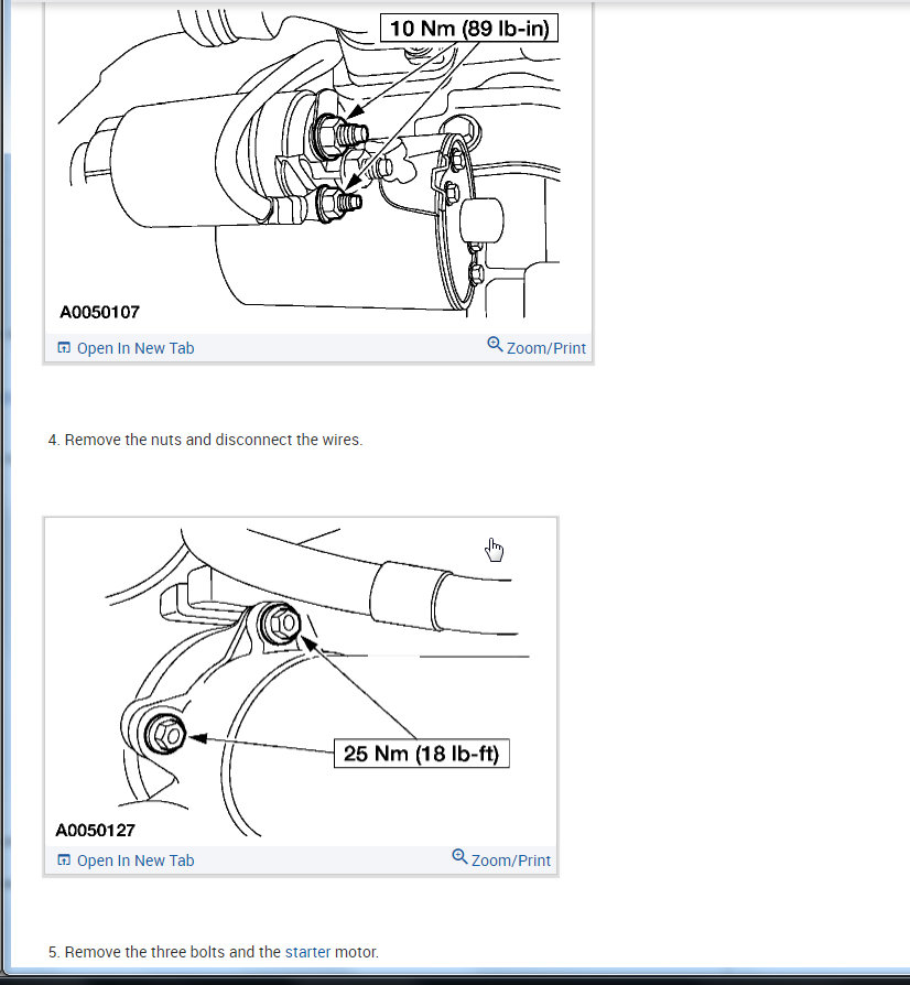

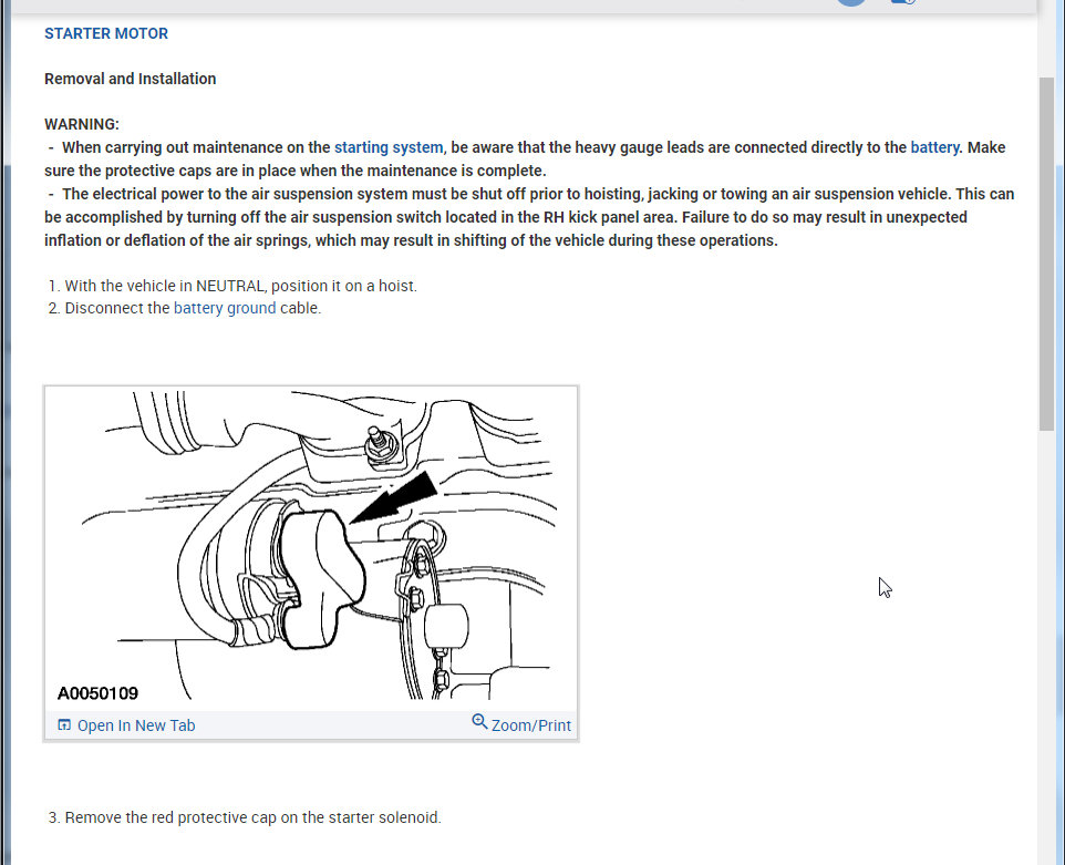

I attached the process for this just in case you need it.
