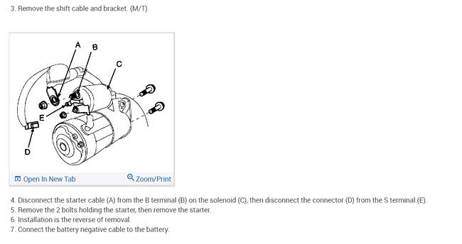

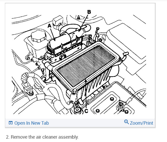

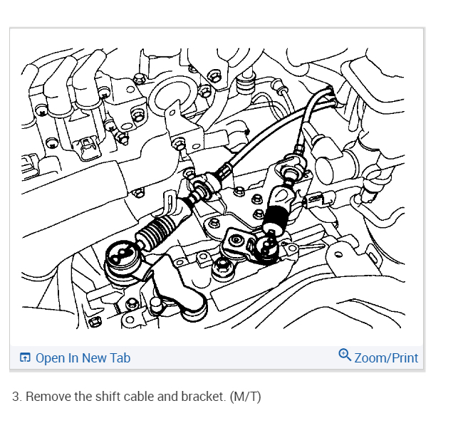

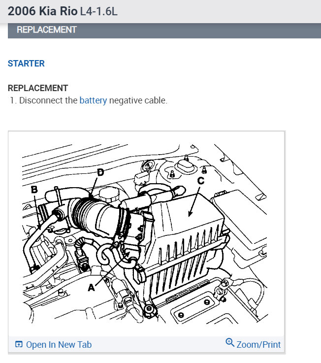

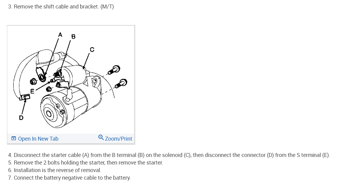

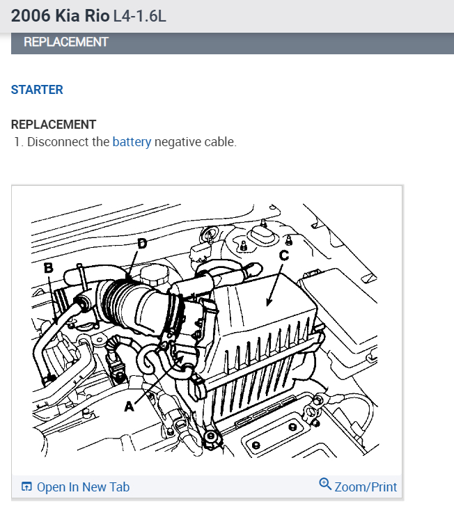

This is common when the battery gets low on charge, or it is bad or the starter has gone out. here is a guide to help you test the battery and I have included how to change the starter out as well:
Here is a generic guide to help walk you through the steps with instructions below for your car:
