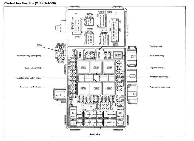

Can you help me identify if it possibly is the starter relay or fuse as opposed to the starter?
Like where is the starter relay?
I looked at the fuse box under the passenger side and I saw six or more relays, but the owner's manual doesn't tell me which one is a starter relay, and the fuses look okay. I pulled some and they look like they're not burnt course I should be testing with a multimeter which I can do.

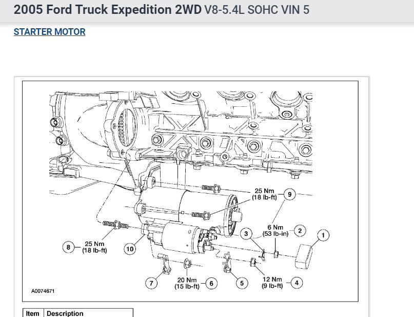

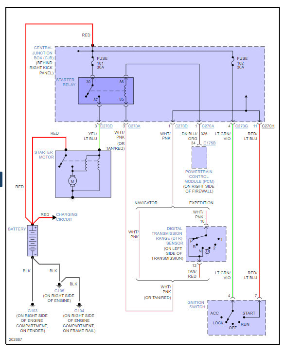

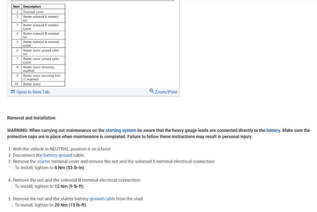

It does sound like the starter relay is bad or the starter motor itself, (the hammer trick doesn't always work). Here is a guide to help check the relay and the relay location along with the starter wiring diagrams in the images below so you can see how the system works.

I replaced relay. No help:(

Do you have power at the starter trigger wire when the key is in the crank position?
This guide will show you how:
