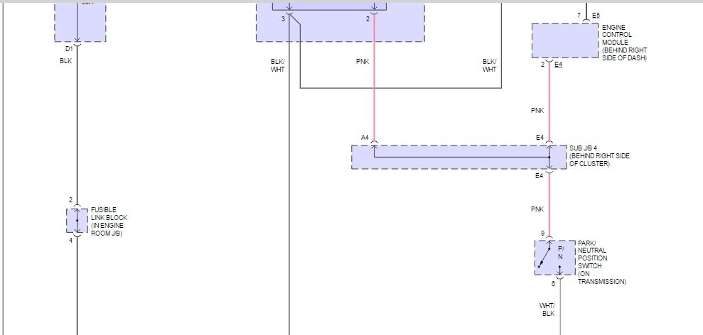

The trouble I am having is that I am not getting the starter to turn over. it has power to it and it works. it is not the relay switch and the motor is not locked up and neither is the flywheel. it appears that the electrical signal is not strong enough to turn the starter motor. Any suggestion?

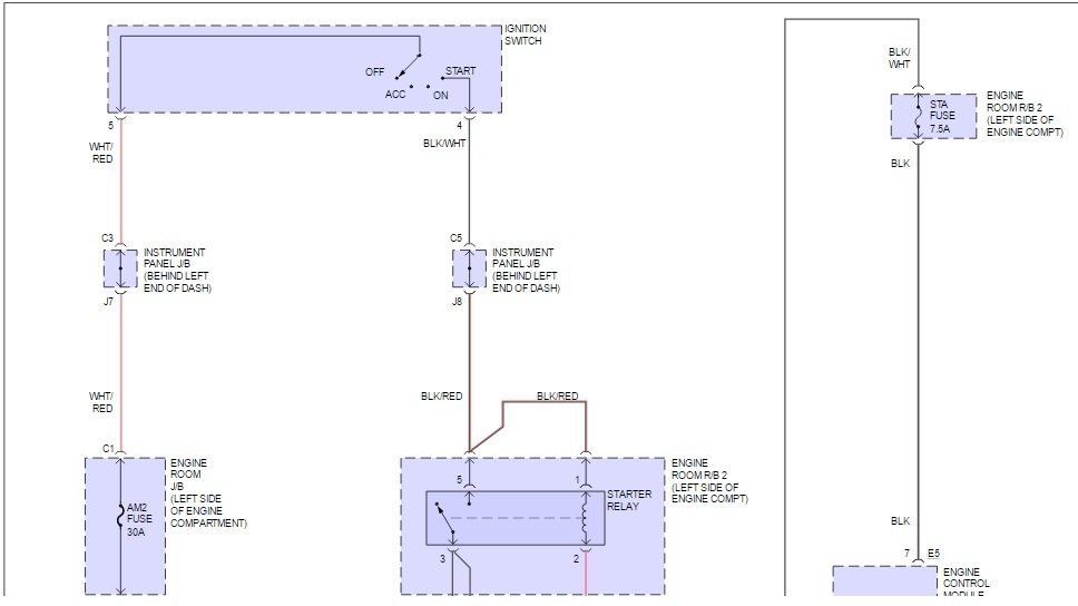

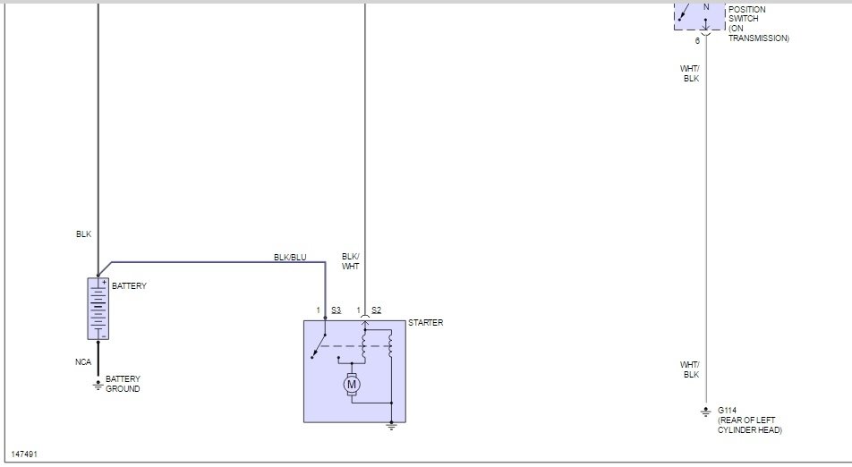

I am Baaaaaack!
I got one diagram
I had to make three screenshots to get it all (Prodemand will not just let you copy it, as they are a 'pay' manual)
So anyway at the bottom they look like one chunk, there are three pieces.
The first is the top, second is middle, third is bottom. I made sure that they overlap so nothing is missing, some is repeated.
You could print these and tape them together if you want to.
You have a neutral safety in there, some fuses, a fusible link. Things commonly that fail.
Prodemand gives the names, numbers and locations to find the items in the diagram.
