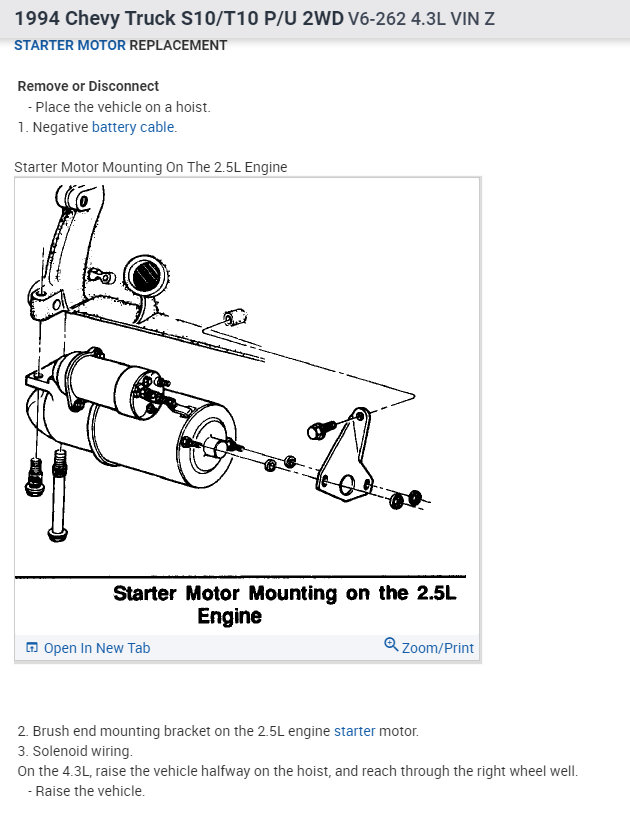

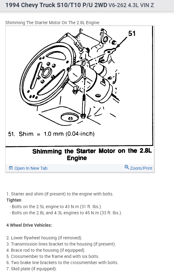

One screw is easy to get, but the other screw is pinched up against the metal and cannot get a socket or wrench around to turn it?

Are you talking about the mounting bolt?
Both of the bolts mounted vertically, and you can get a socket on both.
Take a look at this video:
https://youtu.be/UwqggihXHFE
Let me know if it is different or you have any questions.
https://www.2carpros.com/articles/how-a-starter-and-solenoid-works
