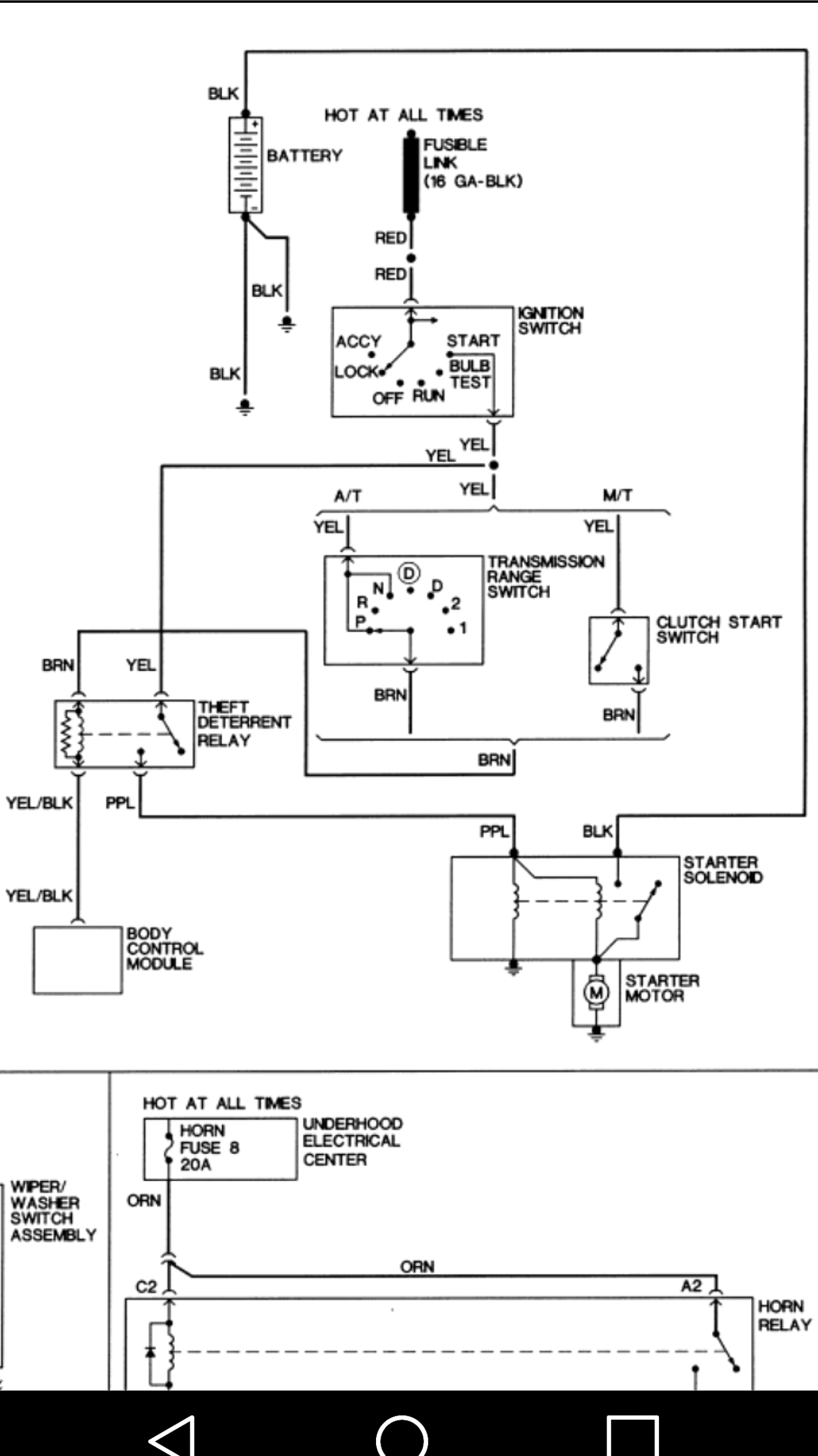

Please tell me where the leads which connecy to the starter are coming from. Thank you.

Maybe this image can help you.

Is the black lead attached to the positive battery post? Thank you for your prompt answer!!

No ground goes straight to negative post on battery and your welcome
