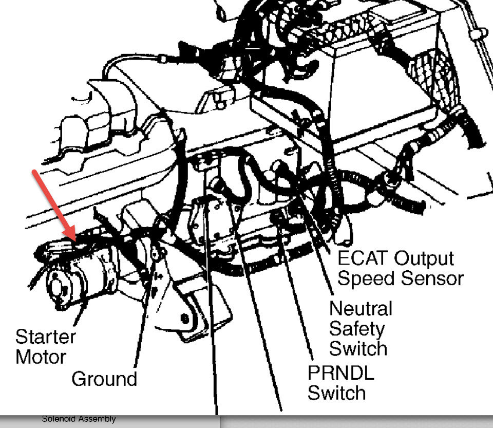

How do I change the starter? More importantly where is it located?

see picture for location which would be front of engine. you need to remove negative battery cable from battery, remove cables from starter and remove bolts that hold it in. reverse for reassembly.
