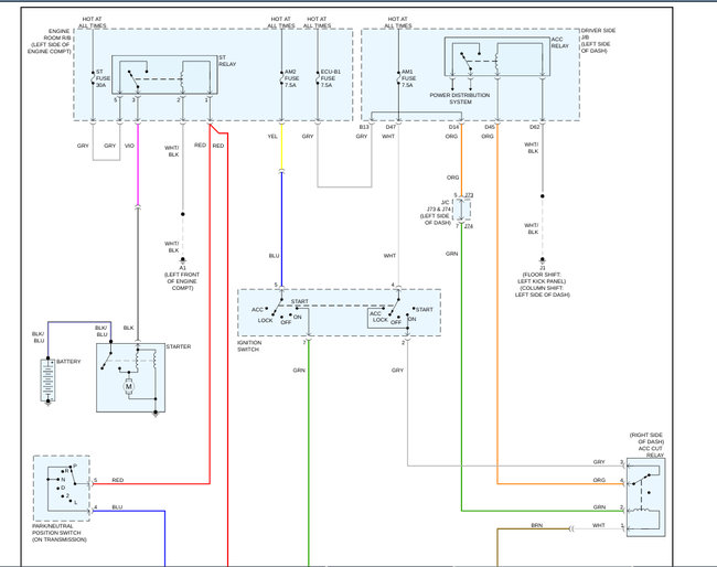

I recently replaced my battery. Truck ran fine all day yesterday until I got in my truck last night and it would not turn over. This morning I checked all of the fuses and relays switching some out without any luck. The battery terminals are fine. Any ideas?
Mar 2, 2020 at 11:01 PM
SCGRANTURISMO
  • 4,897 POSTS

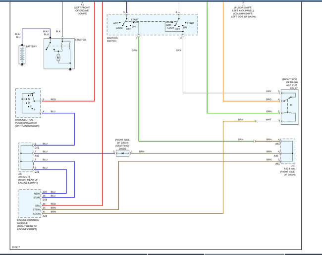

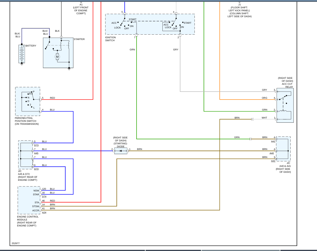

I would recommend double checking the connections to the battery. Make sure that there is a good connection from the frame to the negative battery terminal. In the diagrams down below I have included the starting diagram for your vehicle. Please go through this guide, check the connections and get back to us with what you find out. We can go from there if needed.
Thanks,
Alex
