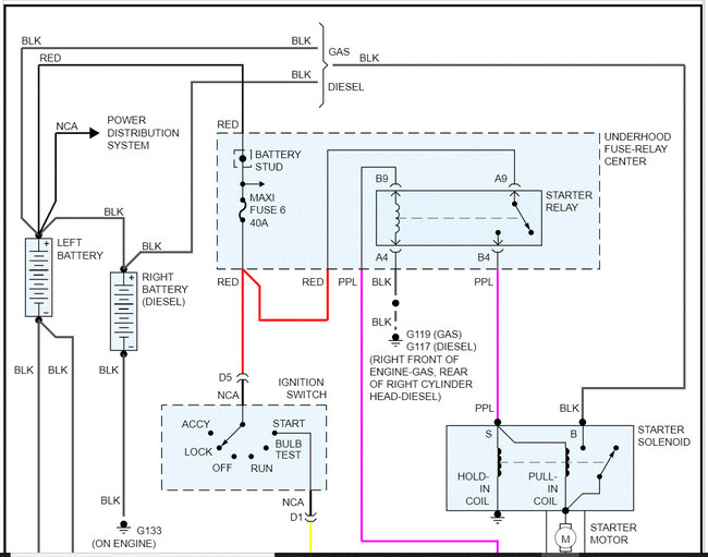

Where is the starter located for replacement?
1996 CHEVROLET SILVERADO
125,000 MILES • 5.0L • V8 • 2WD • AUTOMATIC
WAYNE IRVIN
Need to replace relay where it is located?
Feb 2, 2022 at 5:10 PM
  • 110,240 POSTS

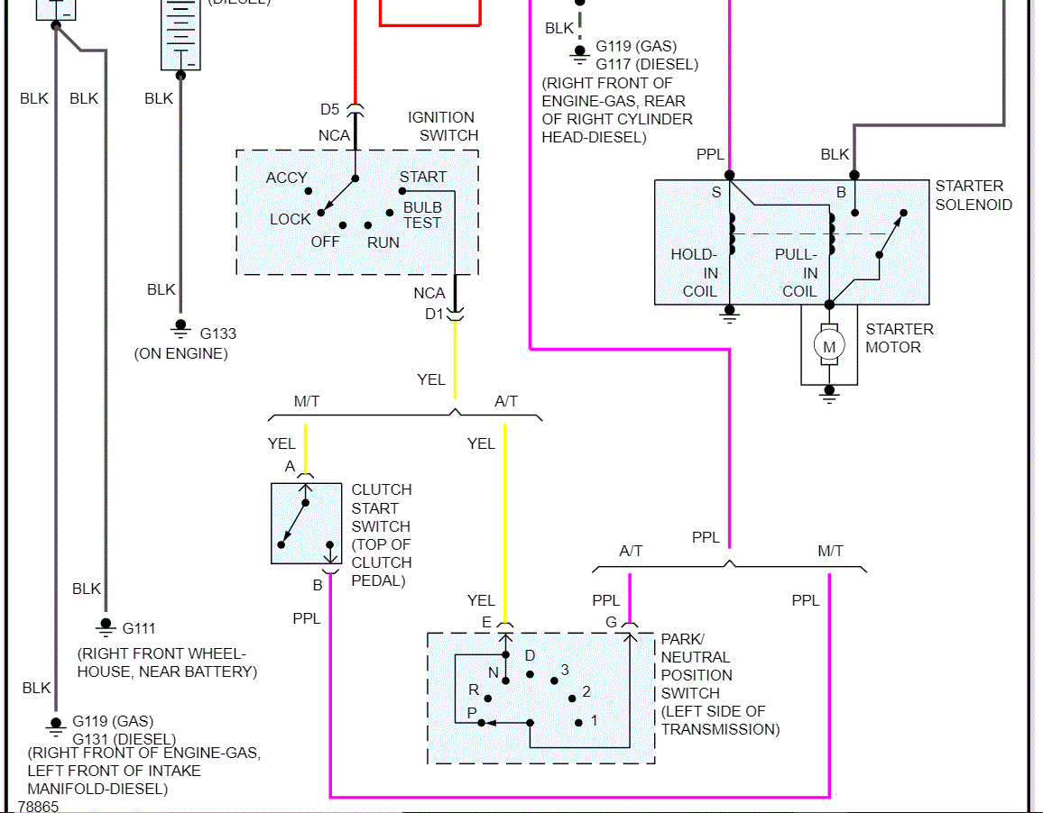

The starter relay will be located in the under-hood fuse/relay box. If you look at the two pics below, that is the wiring schematic for the starter circuit. I had to cut it in half to make it readable for you, but I did overlap the two so you can follow from one to the next.
Also, if you are having starter issues, take a look through this link. You may find it helpful.
I looked in my manual for the specific location of the relay and it isn't indicated. However, there should be a label on the underside of the fuse box indicating what each component is for.
If you suspect a problem with the relay, switch it with one that has the same part number. If there isn't one, here is a link that explains how to test a relay.
Let me know what is happening. Hopefully, I'll be able to point you in the right direction.
