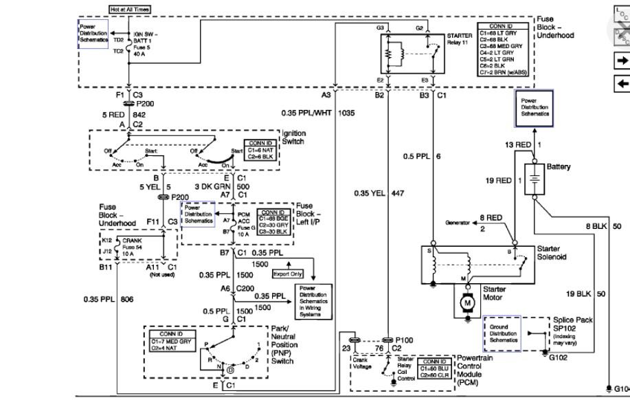

Yes finally figured it out. I got starter changed, but turn key and nothing. i am getting all dash lights and gauges. Maybe ignition switch?
Mar 25, 2018 at 9:25 AM
Could be but the system needs to be checked first.
I attached a diagram for you. there is a fuse in the underhood fuse box. you need to check for voltage on both sides of the fuse in the start position. that will tell if it is the ignition switch.
Mar 25, 2018 at 9:30 AM
MOLLYDAD
  • 28 POSTS
How do I check? I do not have my own meter.
Mar 25, 2018 at 9:35 AM
You will need either a voltmeter or test light to perform these checks. you can get a cheap one at a parts store. I would get a test light. easier to work with this tool.
Mar 25, 2018 at 9:37 AM
MOLLYDAD
  • 28 POSTS
Like for testing for voltage at an electric outlet?
Mar 25, 2018 at 9:39 AM
that is correct. it will need to read a low voltage such as twelve volts.
Mar 25, 2018 at 9:44 AM
