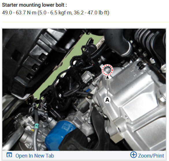

Where is the Starter located?
2020 KIA SOUL
185,000 MILES • 2.0L • 4 CYL • 2WD • AUTOMATIC
SHANEH124
Starter just clicks but I can't find the starter.

The starter motor is at the left side of the engine down low near the transmission bell housing. I would watch this video to check out the easy fixes that will cause the engine not to crank over.
https://www.youtube.com/watch?v=6YRW8fyNudY
Here is an image of the lower starter bolt. Check out the images (below). Please let us know what happens.
