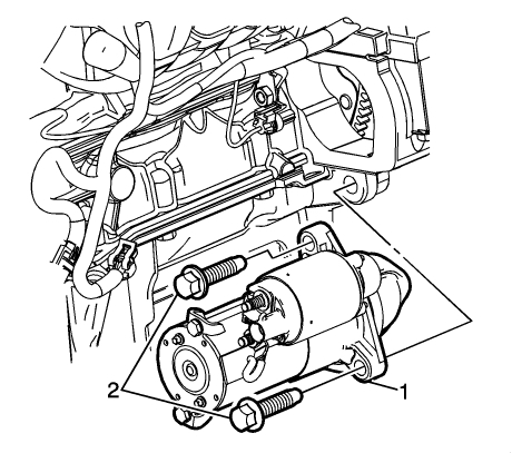

Car went through deep water. Engine is not locked. Spark plugs oil and filter has been changed. Air filter was wet.

Hi and thanks for using 2CarPros.com. I have to be honest; I am not sure what you need. I will provide removal and replacement directions for the starter. If you need something different, please let me know.

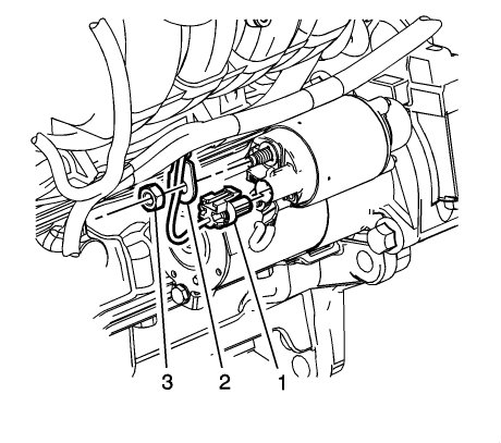

Disconnect the engine harness connector (1) from the starter.
Remove the starter solenoid fastener (3) and the battery positive terminal (2) from the starter.
Remove the starter fasteners (2).
Remove the starter (1).
Installation Procedure
Position the starter (1) to the engine.

Install the starter mounting fasteners (2) and tighten to 58 Nm (43 lb ft) .
Install the positive battery cable terminal (2) to the starter. Ensure that the anti-rotational tab is correctly located into the indexing slot.
Install the starter solenoid terminal fastener (3) and tighten to 11 Nm (8 lb ft) .
Connect the engine harness connector (1) to the starter.

I hope this is what you were looking for. Let me know if you have other questions.
