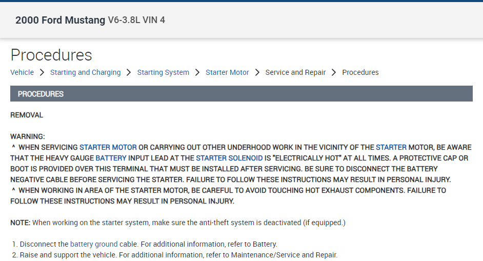

I need to know where the starter is located.

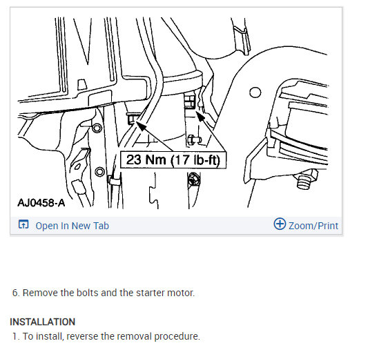

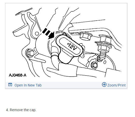

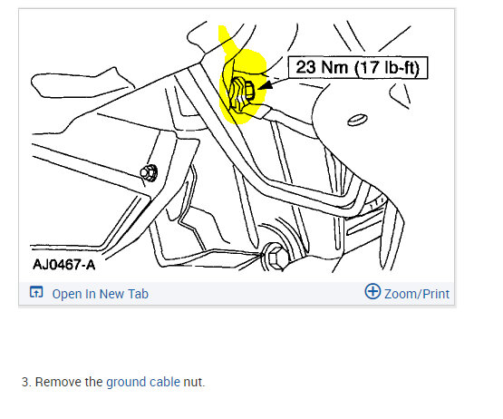

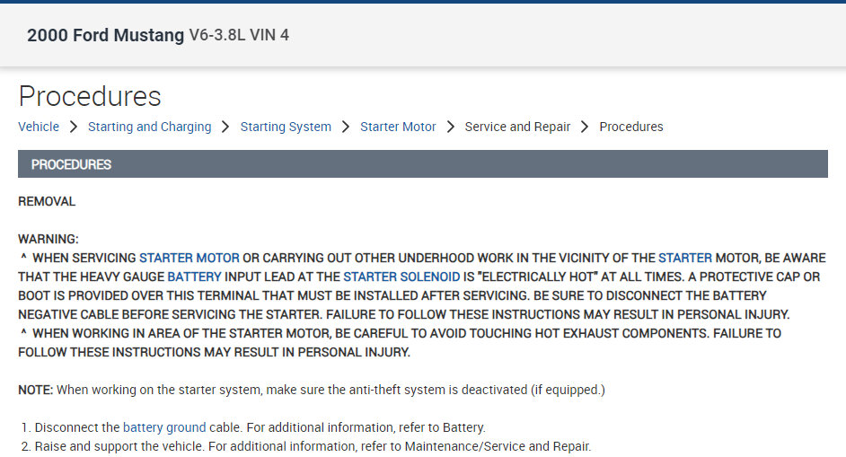

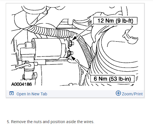

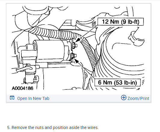

The starter motor is on the passenger side of the engine at oil pan level and where the engine and transmission meet.
I attached the directions specific to your vehicle below. However, here is a link as well that explains in general how it is done. Whatever you do, make sure the battery is disconnected before starting this procedure.
