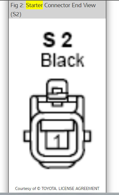

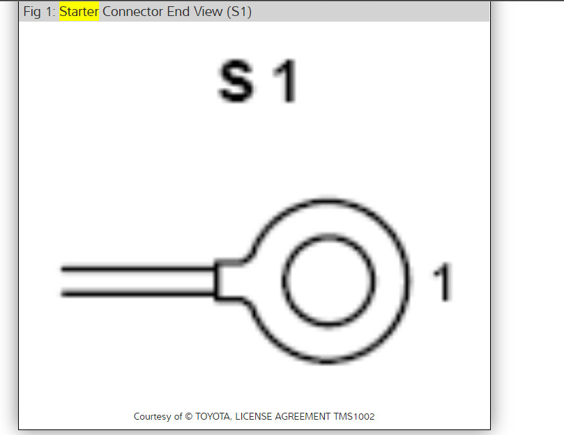

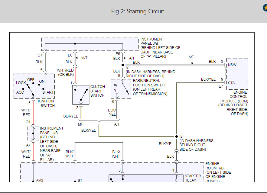

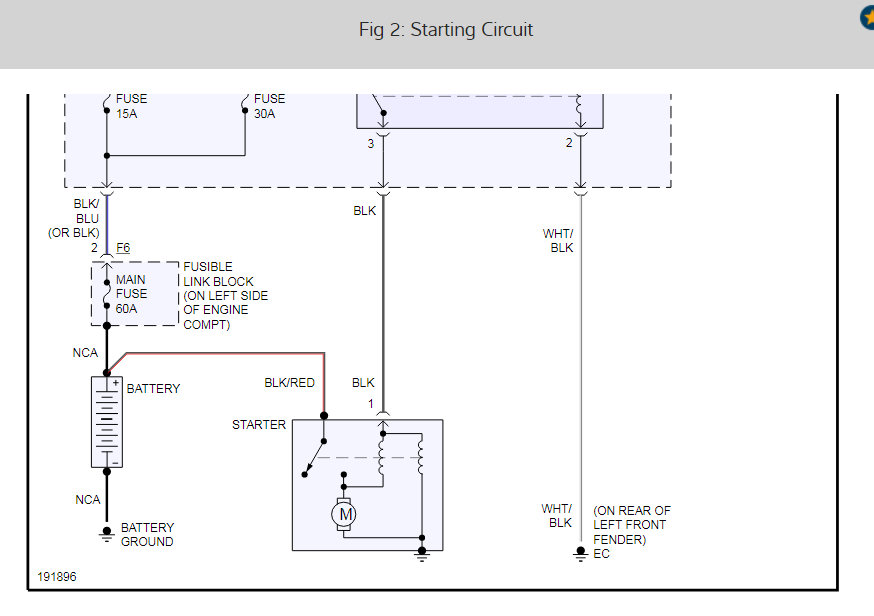

Got in my car tried to start it and nothing. Won't even turn over. All lights come on. It has a new battery. replaced the starter with a new one. started right up. then three days later it is doing the same thing. it won't turn over? Help!
Aug 6, 2019 at 11:27 AM
ANGELMASI
Connections to the battery are good. haven't checked the connection to the starter.
Aug 6, 2019 at 11:29 AM
SCGRANTURISMO
  • 4,897 POSTS
The connections at the starter are a good place to double check to make sure that the connections are good and tight. In the diagrams down below I have included the two starter connectors for you for reference, as well a wiring diagram of your vehicle's starting circuit, again, for reference. Please get back to us with what you are able to find out.
