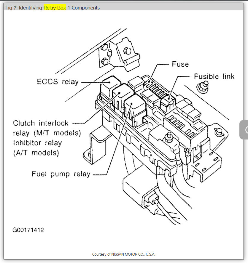

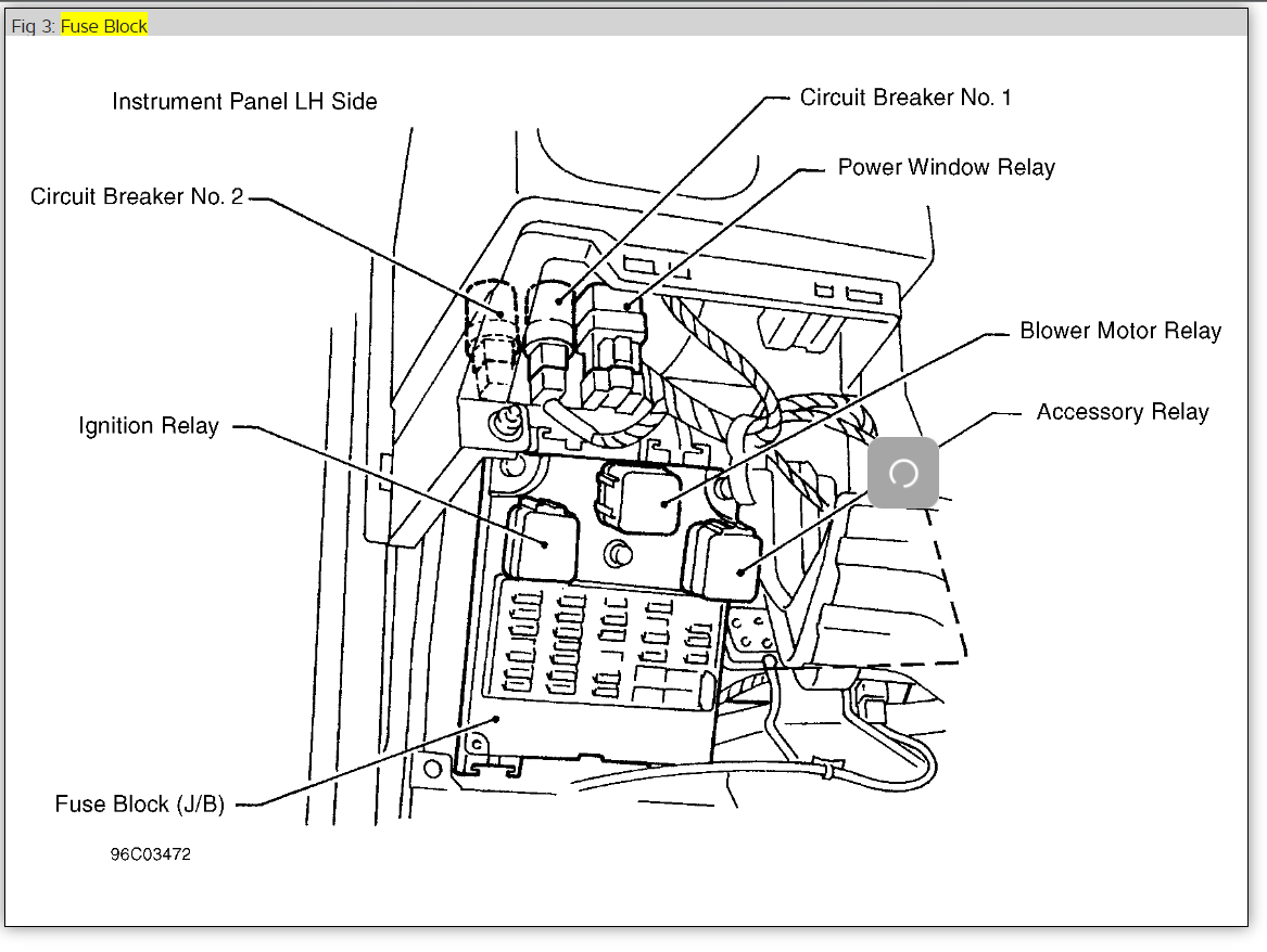

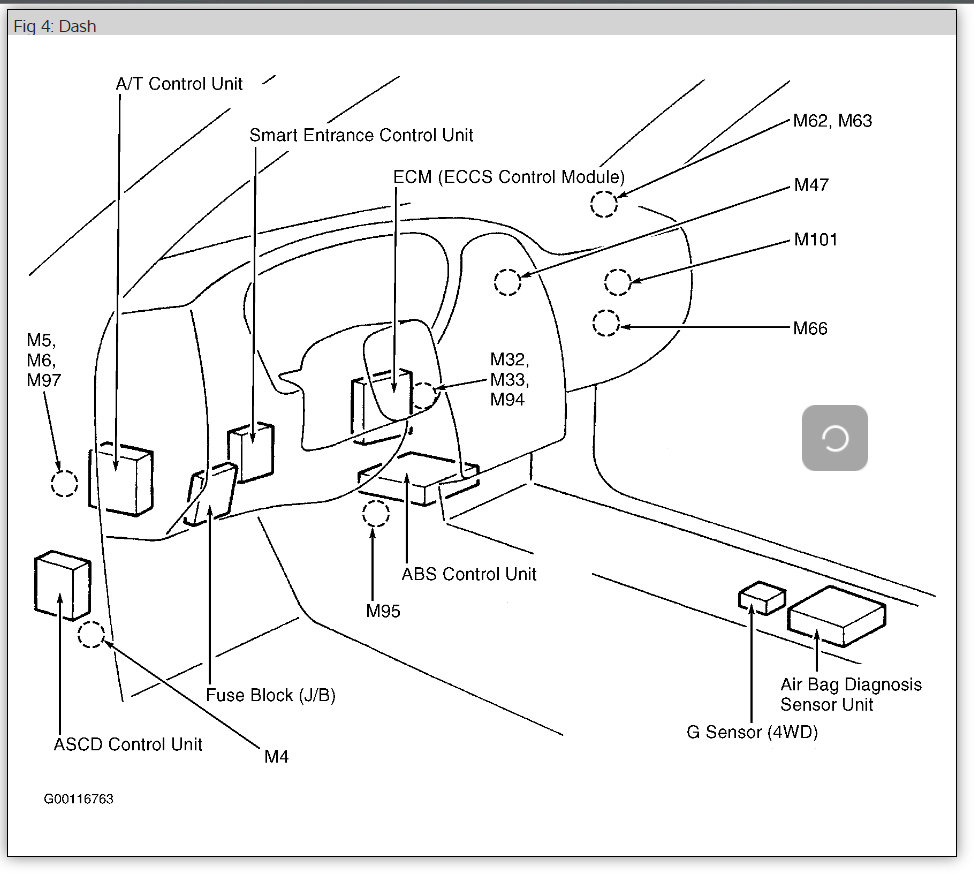

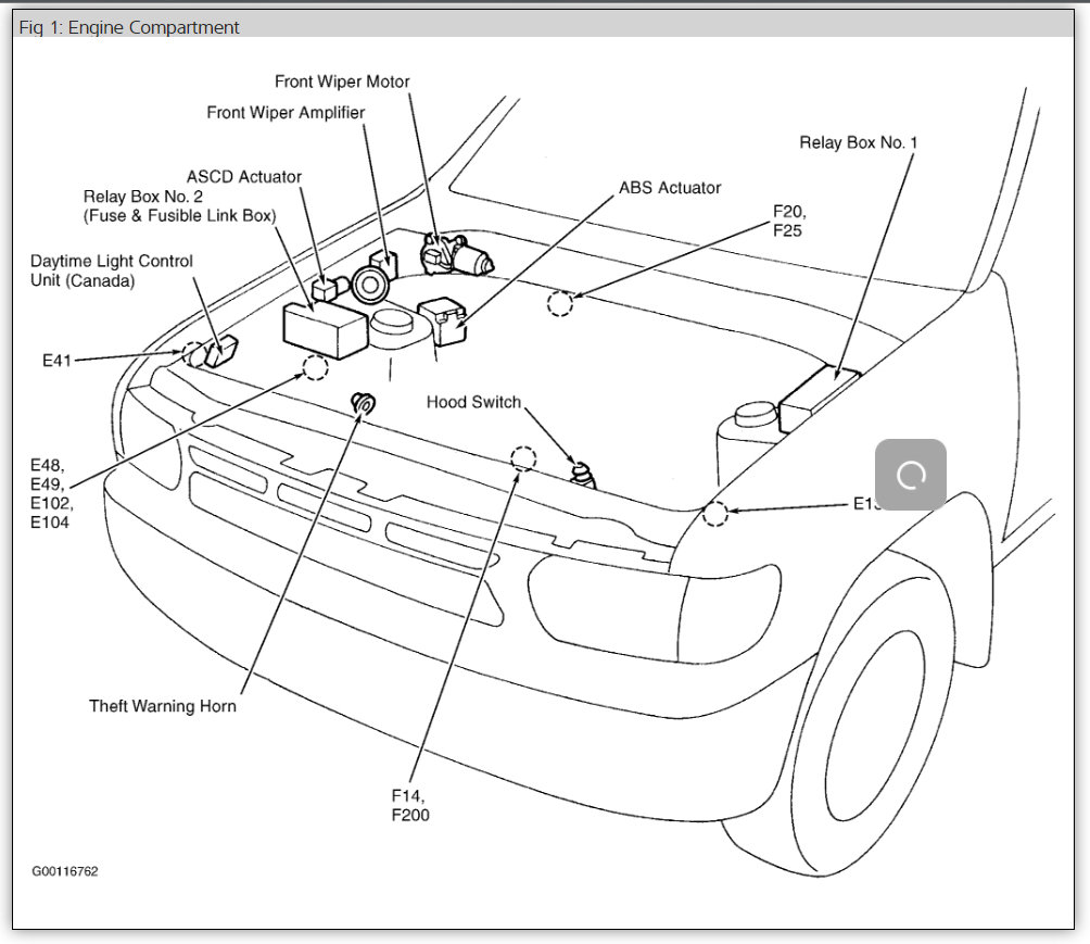

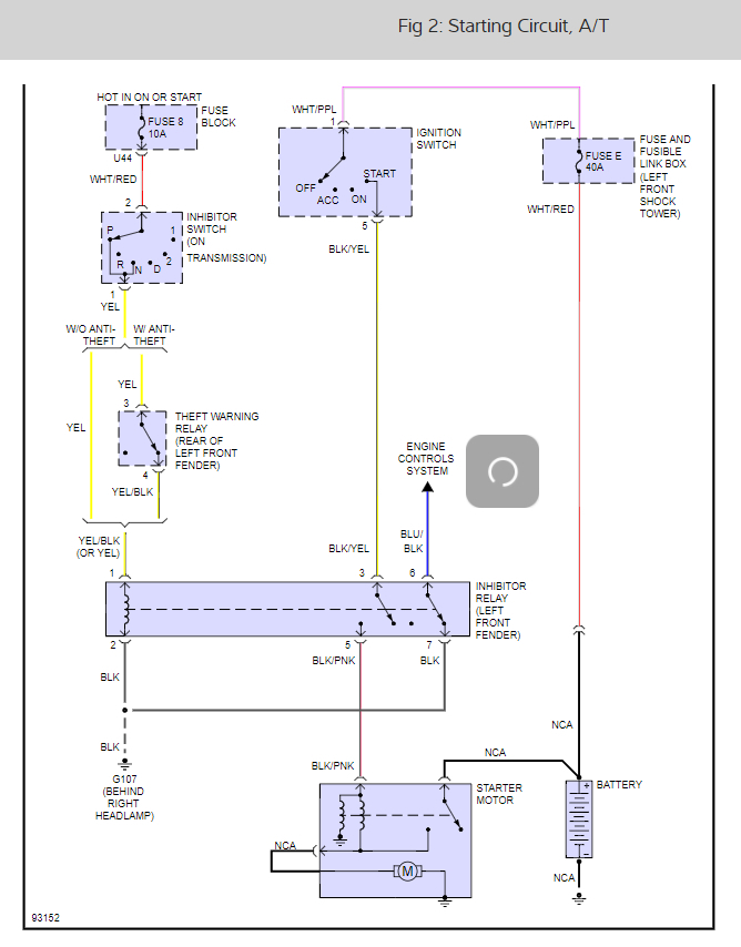

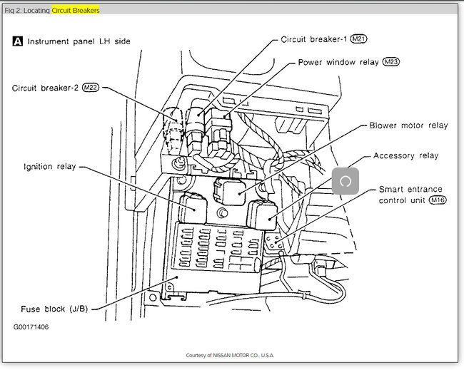

Put new starter on and truck still does not start. battery works fine.
Sep 21, 2017 at 3:08 PM
  • 54,832 POSTS
It sounds like you have a neutral safety switch that could be bad.
Here is a guide to help you test it and the rest of the system:
https://www.2carpros.com/articles/how-a-neutral-safety-switch-works
and

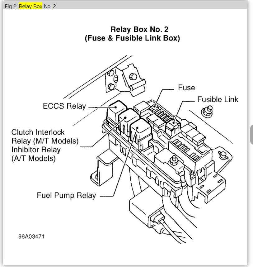

There is an inhibitor relay that can be bad as well.

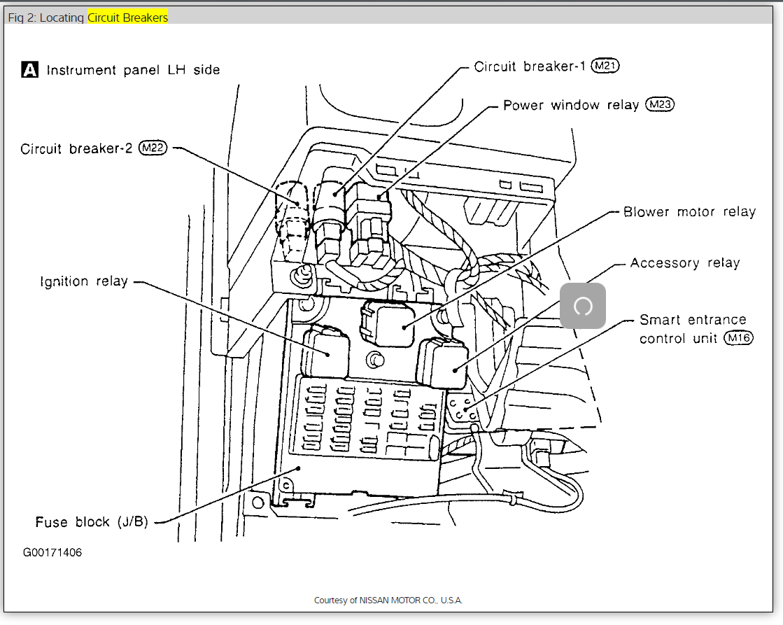

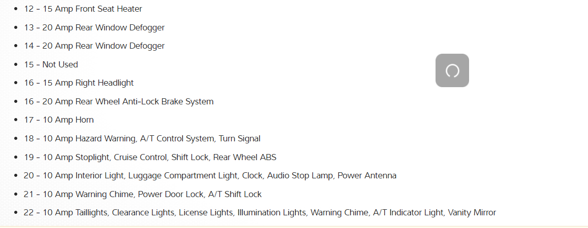

Below are some diagrams of your car check them out to help fox the problem.
Please let us know what happens and upload pictures or videos of the problem.
