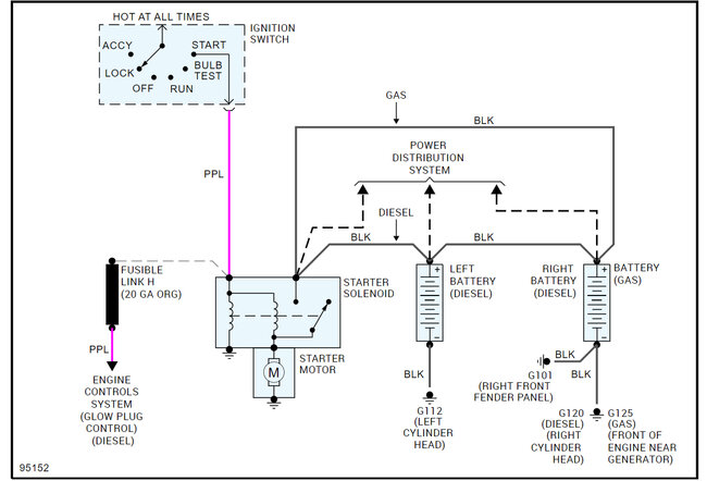

I'm rewiring my starter and ignition switch from scratch, and I was just wondering if I could get the wiring diagrams for the starter ignition and etc., etc. thank you

Sure, here is the wiring diagrams and a guide to help you with any testing you may need to do.
Check out the images (below). Let us know if you need anything else.
