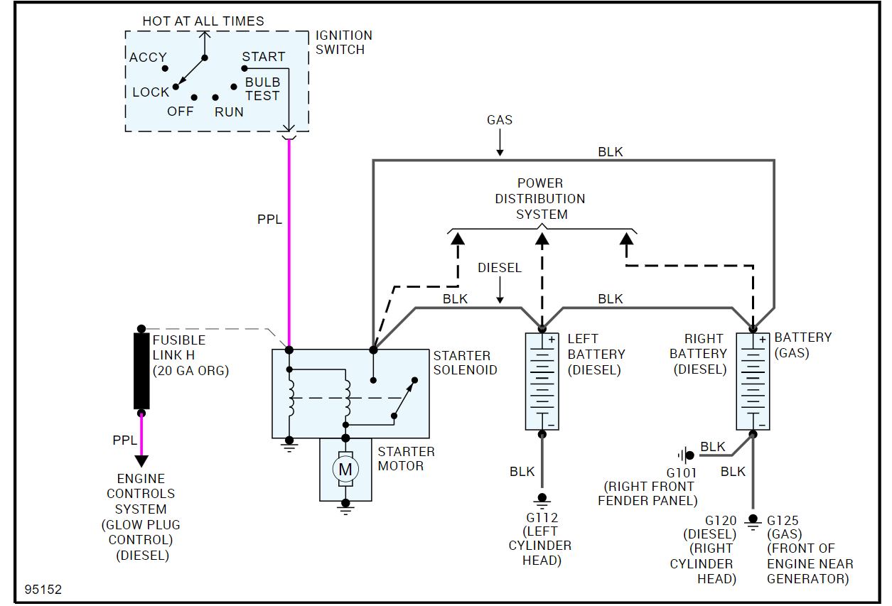

Can I get the wiring diagram for the starter?
1985 OLDSMOBILE CUTLASS
150,000 MILES • V8 • 2WD • AUTOMATIC
PIMINHS3500
  • 11 POSTS
I'm rewiring my starter and ignition switch from scratch, and I was just wondering if I could get the wiring diagrams for the starter ignition and etc., etc. thank you
Oct 1, 2024 at 2:05 PM
  • 55,051 POSTS

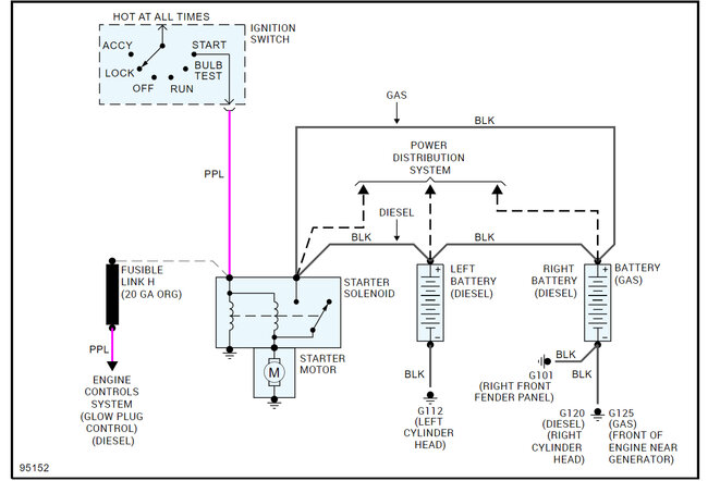

Sure, here is the wiring diagrams and a guide to help you with any testing you may need to do.
Check out the images (below). Let us know if you need anything else.
