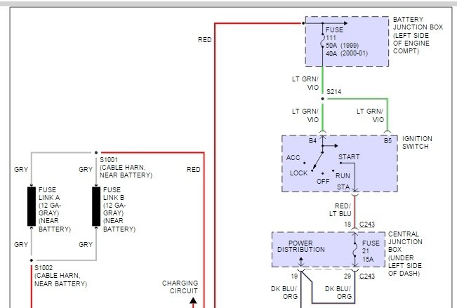

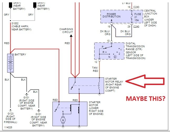

Starter won't disengage but does when you turn off key. Burnt up two starters and replaced the cylinode and ignition switch. Don't know what else to do
Jan 20, 2016 at 10:11 AM
CJ MEDEVAC
  • 11,000 POSTS
GOT YOU 2 SCREENSHOTS OF THE SAME DIAGRAM (ONLY WAY I COULD GET IT FROM "PRODEMAND"
1st ONE SITS ON TOP OF THE SECOND ONE (YOU WILL SEE THE OVERLAP OF THE DIAGRAMS)
LEMME KNOW IF THIS HELPS
