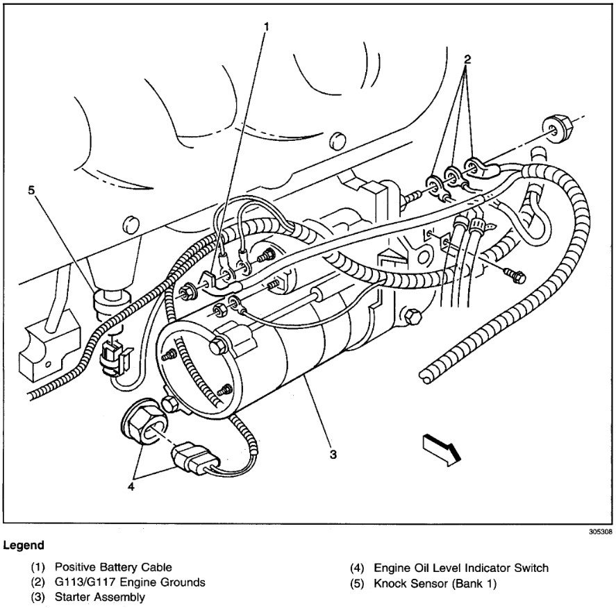

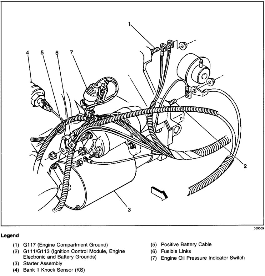

Where is the starter located?
100,000 MILES • V8 • 2WD • AUTOMATIC
CYNDIE THIGPEN
Exactly where is it located on the car listed above?
May 28, 2022 at 10:20 AM
STEVE W.
  • 15,405 POSTS
Both the 3.1 and 3.8 V6 engines have the starter located at the lower edge of the engine block at the rear of the block at the transmission flange. On the left side which on that car is the "front" or radiator side of the engine.
