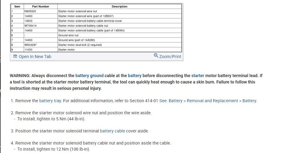

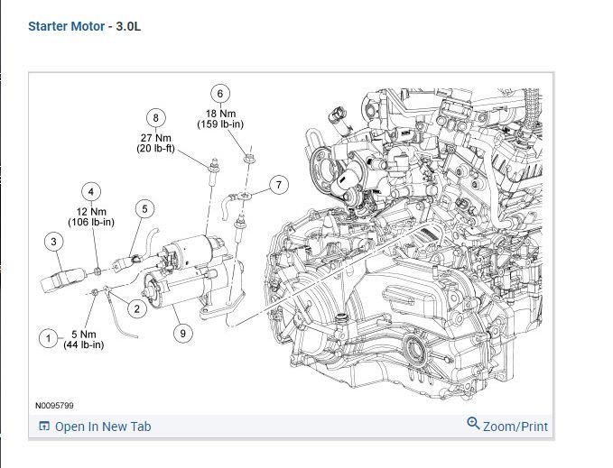

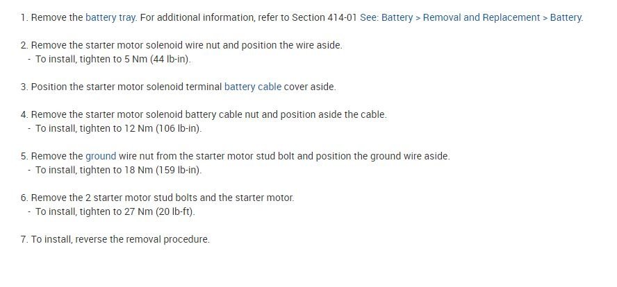

Car will not start.Was barely starting for about a week. Took it to get diagnosed at auto part store and now it just clicks. How do I replace it?
Jun 4, 2021 at 8:16 AM
Experienced Mechanic
52,796 POSTS
Good afternoon,
I attached the procedure for you for the repair. I also attached a guide for you below.
