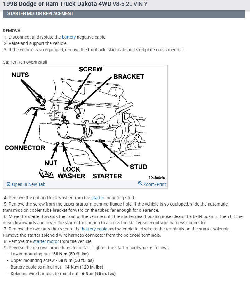

Starter on a 2002 Dakota V8 (4.7L) will not fit on a 1998 5.2L V8 Dakota.
Here is the OEM part number for the starter that you will need 56027702.
Helpful guide on starter replacement:
I have attached a diagram below for your reference.
Let me know of any questions.
