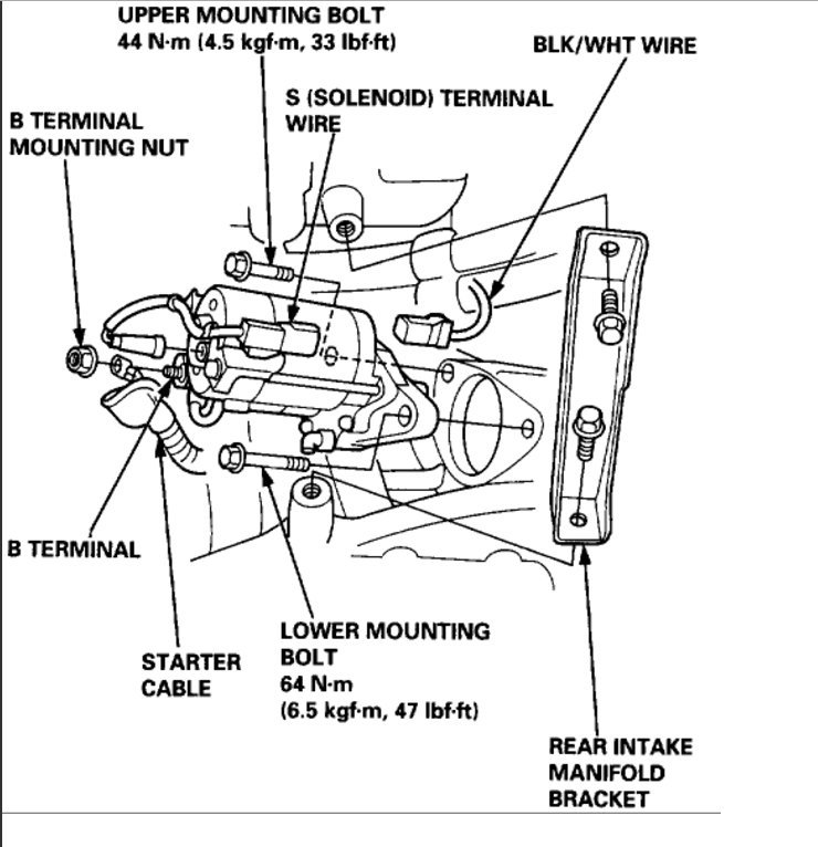

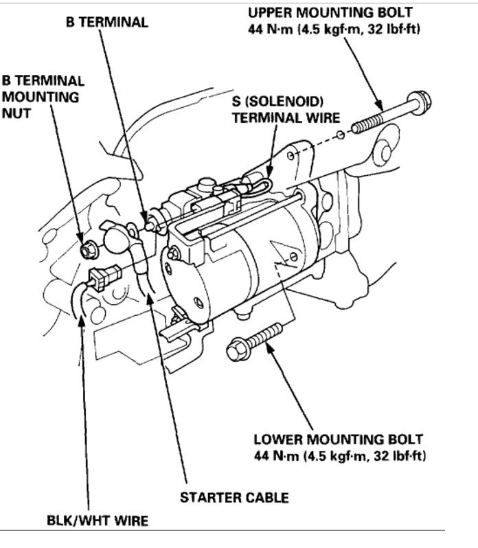

How to remove starter?
May 29, 2017 at 5:14 AM
  • 55,421 POSTS
This starter is located at the side of the engine, it shows two different engines so I have included diagrams (below) of both and a guide to help you see what you are in for when doing the job.
Start by disconnecting the battery
