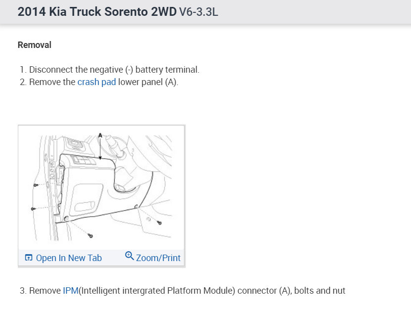

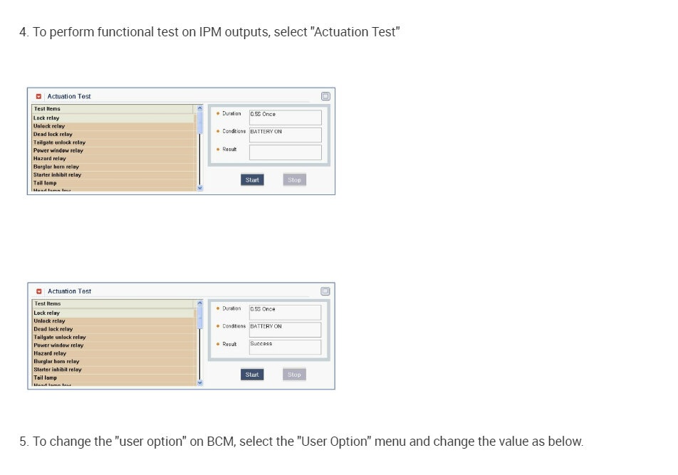

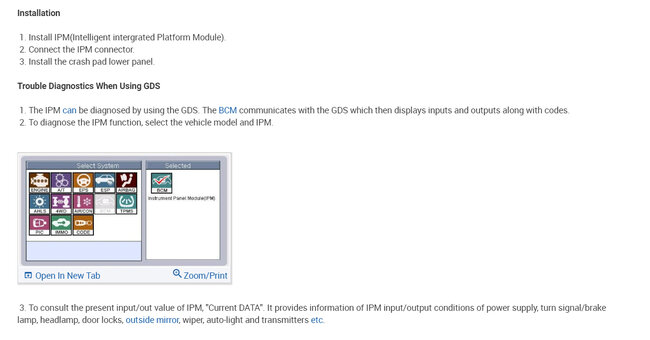

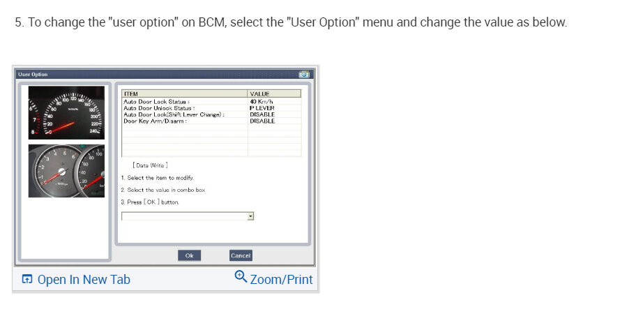

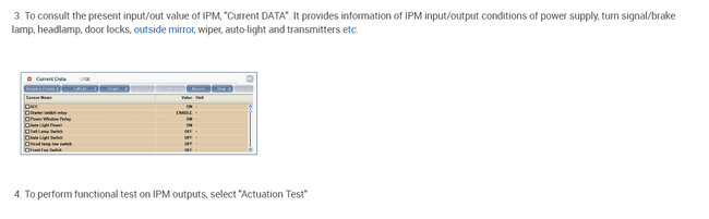

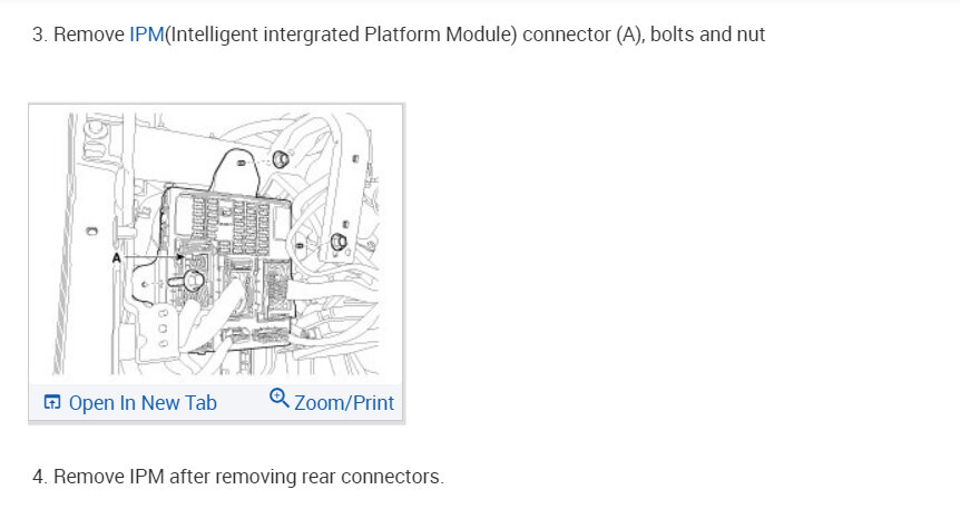

It sounds like the BCM has gone out, but to be sure we need to start by checking the system by doing a CAN scan which is easy to do. You can get a CAN scanner (Controller Area Network) which will work on most cars from Amazon.
here is a video to show you how:
https://youtu.be/u-4syLc-ifQ
Here is how to change out the IPM (Intelligent integrated Platform Module) (BCM), you can get a preprogrammed unit by searching Google or Ebay. Check out the images (below). Please let us know what happens.
