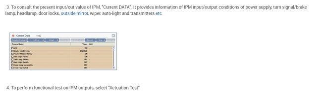

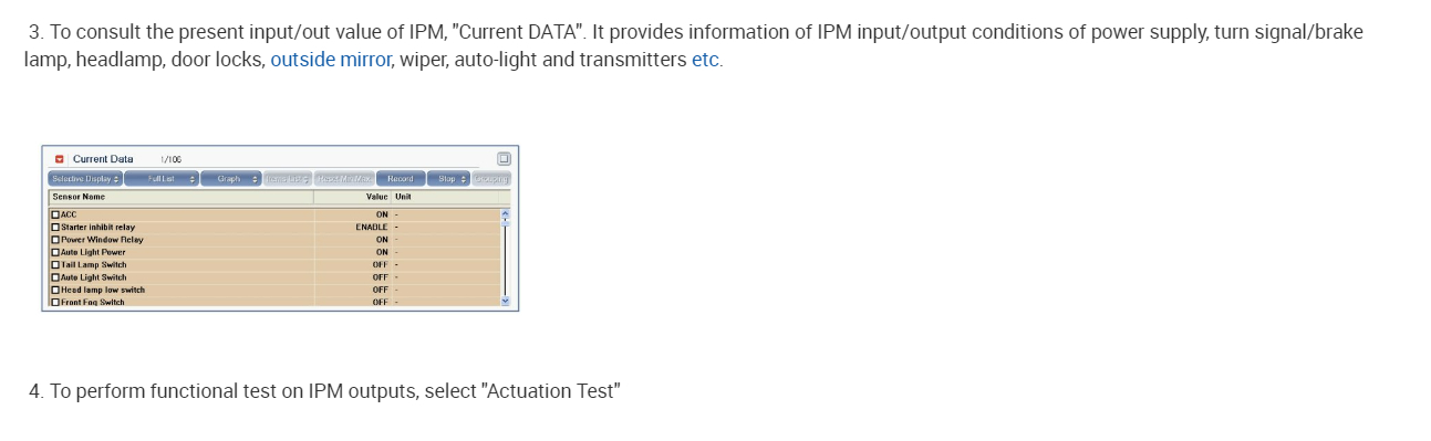

So, I was driving down the road and all of a sudden, the car was acting like I was lightly pushing on the brakes. So, I looked down and the traction light was blinking, then the ABS then it said check ABS. So, I turned car off then restarted it. Now the all-wheel drive light came on and an exclamation kind of light came on and power steering is no longer working so I turned it back off then it wouldn't start.
Jun 14, 2023 at 9:57 AM
  • 55,397 POSTS

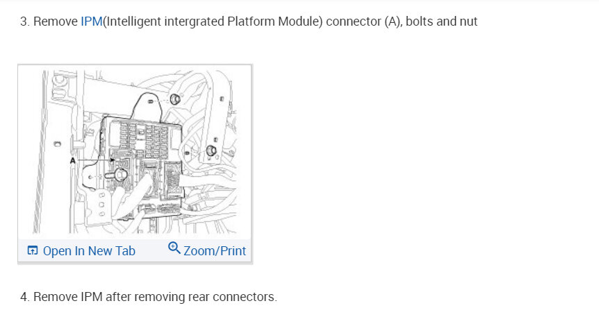

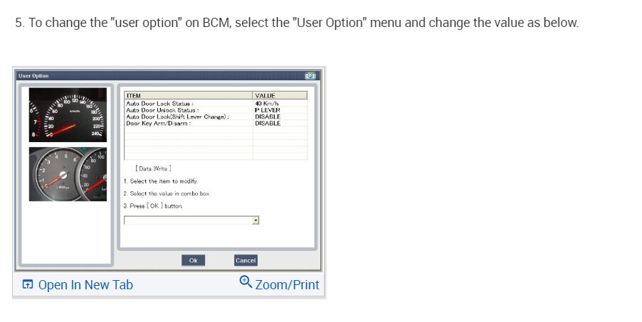

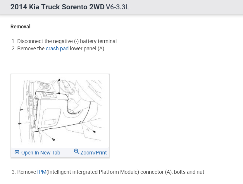

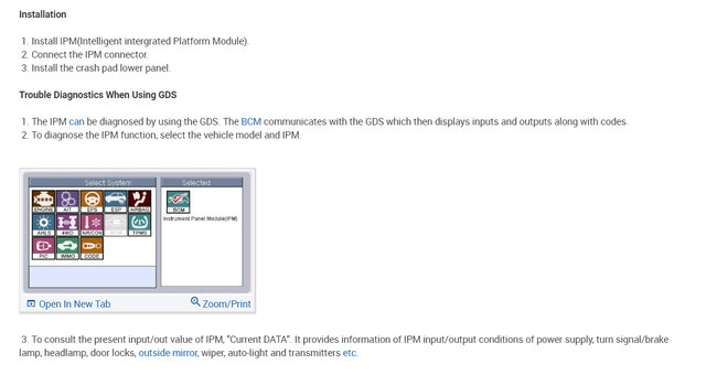

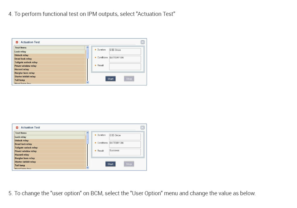

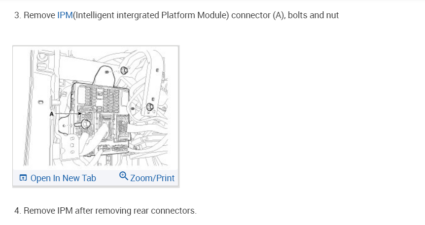

It sounds like the BCM has gone out, but to be sure we need to start by checking the system by doing a CAN scan which is easy to do. You can get a CAN scanner (Controller Area Network) which will work on most cars from Amazon.
here is a video to show you how:
https://youtu.be/u-4syLc-ifQ
Here is how to change out the IPM (Intelligent integrated Platform Module) (BCM), you can get a preprogrammed unit by searching Google or Ebay. Check out the images (below). Please let us know what happens.

It was the alternator but thank you i appreciate you answering my question.

Well, it was doing good up until now and it's starting to do the same thing again. After I changed out the alternator it fixed it, but today all of a sudden, the check BSD system came back on the traction light and the ABS light came back on but when I started moving again it went away again but came back when I turned down my street? Could it be the battery now? In was also told it could be the relay for the alternator, but I didn't know alternators had relays.
I'm kind of old school these newer cars have more technical issues than what I have knowledge for.
My battery is only 6 months old.
Jun 20, 2023 at 5:06 AM
  • 55,397 POSTS
I would refer to my first post and do a CAN scan because it sounds like the IPM is bad. Let me know how it goes.
Jun 21, 2023 at 2:41 AM
ARNEYLADONNA
  • 6 POSTS
Well, it ended up being the alternator again I got a remanufactured one the first time and evidently buying those are like gambling lol at least that was what O'Rielly's told me he said, "sometimes you win and sometimes you don't". So, I bought the more expensive one and it's been running like a champ now.
