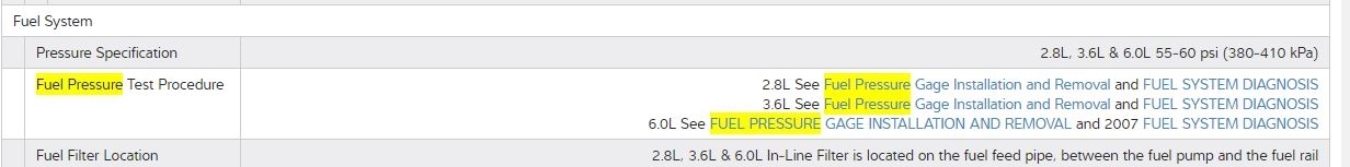

When in idle is very rough, started smoking black.
Jul 9, 2018 at 6:54 AM
  • 110,248 POSTS
Based on your description, it sounds like the engine is getting too much fuel. There are several things which can cause this. Also, black smoke is usually the result of a very rich fuel mixture.
The first thing I would recommend checking is the fuel pump pressure and the fuel pressure regulator. Here is a link that will walk you through the process:
Lets start with that test first. I have attached a picture of what the fuel pressure should be.
