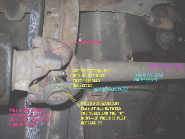

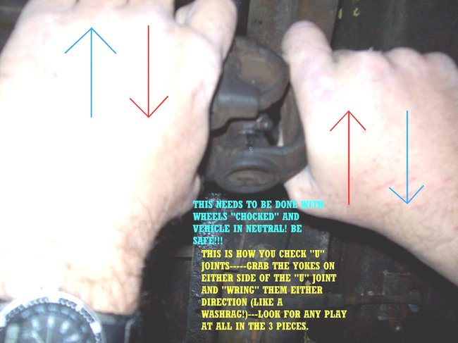

CJ MEDEVAC
  • 11,000 POSTS
Different and better looking person.
While you are under there,
Might check them Universal Joints too!
Level ground/ chock the wheels/ out of gear.
The Medic
Mar 11, 2017 at 9:34 AM
