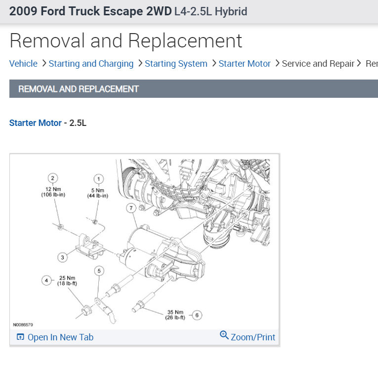

Trying to figure out where a starter is at on the vehicle listed above, hybrid. Mileage did not take correctly it has over 50,000 miles.
Jul 25, 2018 at 12:06 PM
STEVE W.
  • 15,404 POSTS

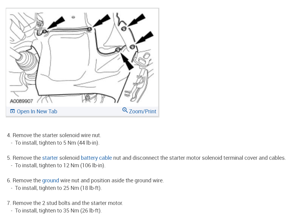

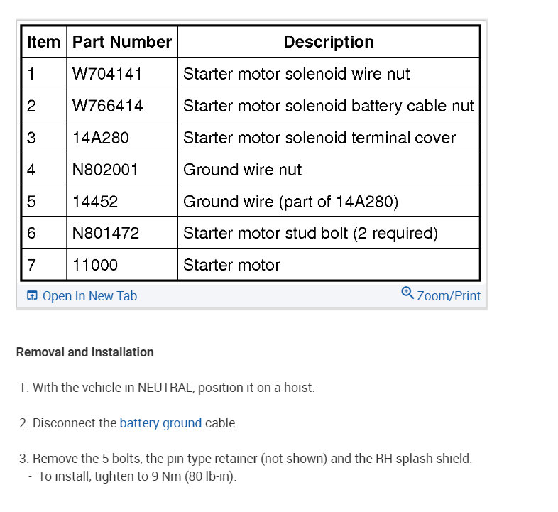

It is hiding in plain sight. If you remove the right hand splash shield from the engine the starter is behind it. If yours has an issue the first thing I would check is the ground connection that attaches at the starter stud itself, have seen a few that corroded there and gave the appearance of a failing starter. Cleaned the crud off and tightened things back up and it returned to normal. The shield traps dirt/water and causes issues. But it does protect it from direct water /snow splashes. Check the images below.
