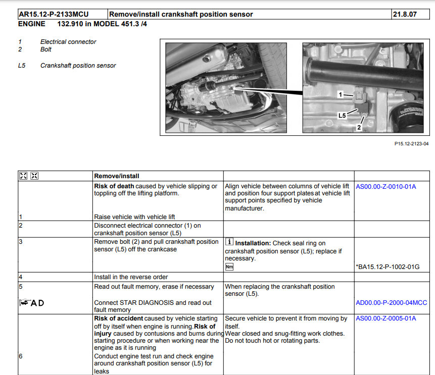

hi, i have injector pulse for about 5 cranks, then no pulse, turn the key off, then back on has injector pulse, good spray for about 5 cranks. What sensor controls the injector that would cause this?

This would be the crankshaft sensor, but it sounds more like a bad PCM, SAM control unit or main relay. Have you run the codes?
This guide can help:
Check out the images (below). Please let us know how it goes.

no codes, has spark will run till injectors stop tested crank sensor test good it seems to me if the ECM sprays the injectors for 3 to 4 cranks. why would it quit working don't have a scan tool and can't find what else could cause it with no codes.
