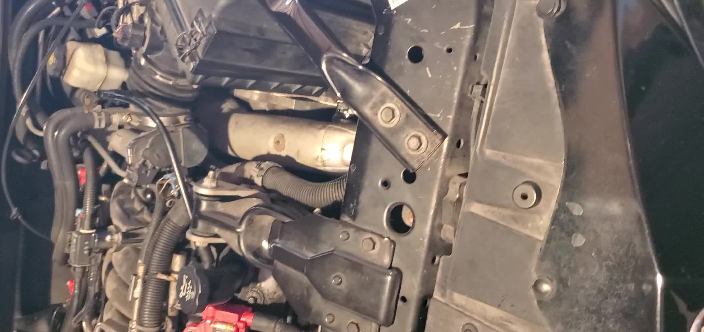

I'm having a start issue, so my problem is; I have all light power but once I turn to start the car it clicks only once. Then I check my battery. It's around 12.3V. All my door locks work as normal plus my factory alarm system will not crank up for nothing, only one click it's coming from the starter area. I thought changing back to my old ACDelco Starter it will crank but still only one click only. This all started after my oil pickup tube job. Once the job was completed my car started up immediately but once it idled for a while then drove around the corner it shut off and will not start back up. My light power is good, battery good, alternator good but starter area something not right and no it doesn't click, click it just clicks once. Never heard of this problem before.

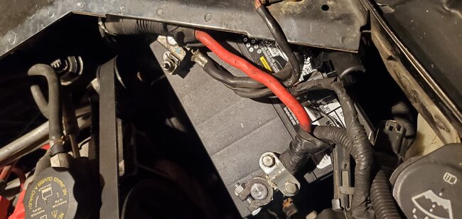

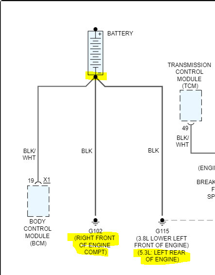

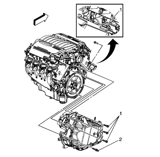

What you described sounds like a weak connection. When this happens, do you notice the lights in the vehicle dim or go out for a second or two? If so, first confirm the battery terminals are clean and tight.
If you replaced the pickup tube, I have a feeling the ground to the engine block wasn't properly tightened or connected. On the V8, it is on the rear of the engine block. See pic below.
Check that ground and let me know what you find.
See pic below.

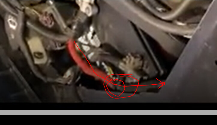

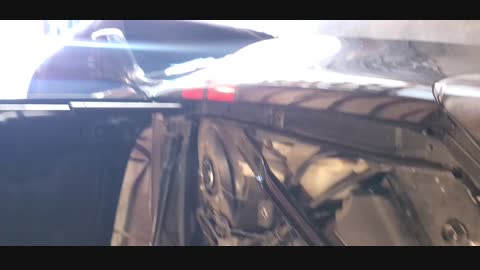

it's something going on here to be honest i didn't check the ground issue yet but it smoke coming from the side of the starter smell like a wire somewhere causing my issue to not start, so i did all the basic to check to crank my car like replace battery it was dead tested at oreilly auto parts got another one still no crank, starter good its just a bad smell down there to be honest, heres a video of what its doing before i take off the cover below...i need all the help because it was fine before but after this oil pickup tube job im having major problems.
Nov 25, 2022 at 5:04 AM
  • 110,240 POSTS
Did it ever start since the repair work was done? I hear the starter trying to engage. If you are smelling something burning, it certainly could be the starter. Keep in mind, the larger wire on the starter has 12v at all times. If the only time you see smoke is when starting it, check the smaller gauge purple wire on the starter. Make sure it isn't shorting to something. Also, how was the starter checked?
Listening to the video, it sounds like the circuit is complete and it should be working. Here is what I suggest:
1) Check the wires on the starter motor and make sure they are tight and not pinched or damaged in any way. Do the same with the battery. It looks like the terminals are new, but make sure the wiring that was installed on them is making good contact and tight.
2) Check to make sure nothing is preventing the engine from turning. See if you can turn it manually at the crankshaft using a socket and a breaker bar.
3) Remove the starter and have it bench-tested at a parts store. Most will do it free of charge.
If you have already done all of these things, let me know. Also, if you are seeing smoke, be careful. It can catch fire. Check to see if either of the battery terminals is hot.
I have a feeling either we have a loose connection, a bad starter, or the starter wasn't reinstalled correctly and is preventing the starter from turning.
I just watched the video again. I copied a portion of it and have attached it below. What am I looking at in this pic? Is that power to the starter? I can't tell for sure, but it looks like the positive cable goes from red to black. Let me know.

Do me a favor. See if you can turn the engine by hand. Something may have come apart. Also, please be careful. Remember, the power from the battery to the starter is direct. There are no fuses. If it gets hot enough, it can catch fire.
Something isn't making sense. Chances are we are missing something simple. I assume the starter is tight. Also, when you had the oil pan off to replace the pick-up tube, did you remove the front timing chain cover to access the oil pump for anything?
It sounds like the engine is unable to turn. The starter is trying but can't turn it. That's why I'm suggesting you see if the engine turns by hand.
Let me know if you can turn it by hand. If you can, disconnect the negative battery terminal and remove and reinstall the starter to make sure it is going in correctly.

never mind my engine is over with its crazy because after the pickup tube job i should of install the oil pump as well. just click from starter area and crank pulley it's hard to turn be hand. Looking into another engine i can't let my GXP go its darn near new brought it when it was 95,000 miles now, I'm at 137,000. it's just crazy how this job created this major problem. Is there no other step to turn that harmonic balancer?

Hey, I'm sad i tried with a breaker bar it will not turn at all. I knew once I heard it sound funny once it was started to shut it off immediately, the oil light came on with the car I could of save it but instead I ran it and drove it. that's when my car just shut off on me. I'm not giving up on my car just other option to pull this engine out.
Nov 27, 2022 at 2:09 AM
  • 110,240 POSTS
That isn't good news. However, listening to the videos you sent, I had a feeling the engine locked up. I didn't realize there was a funny sound prior to it stalling. What did it sound like?

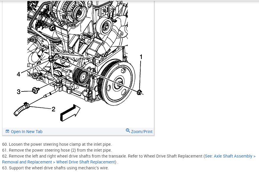

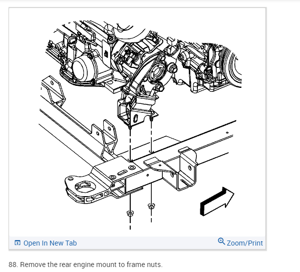

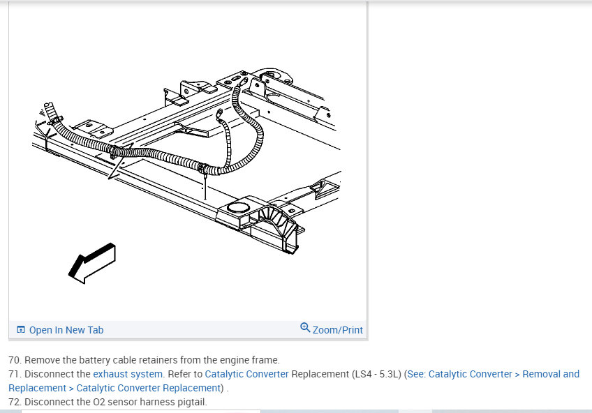

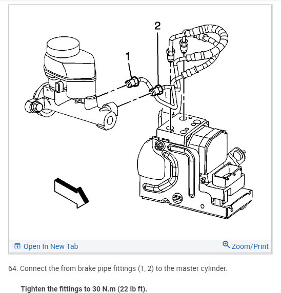

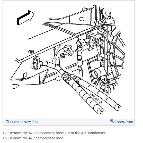

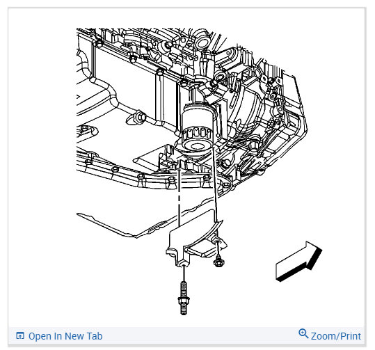

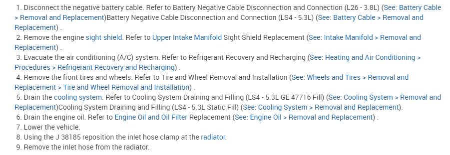

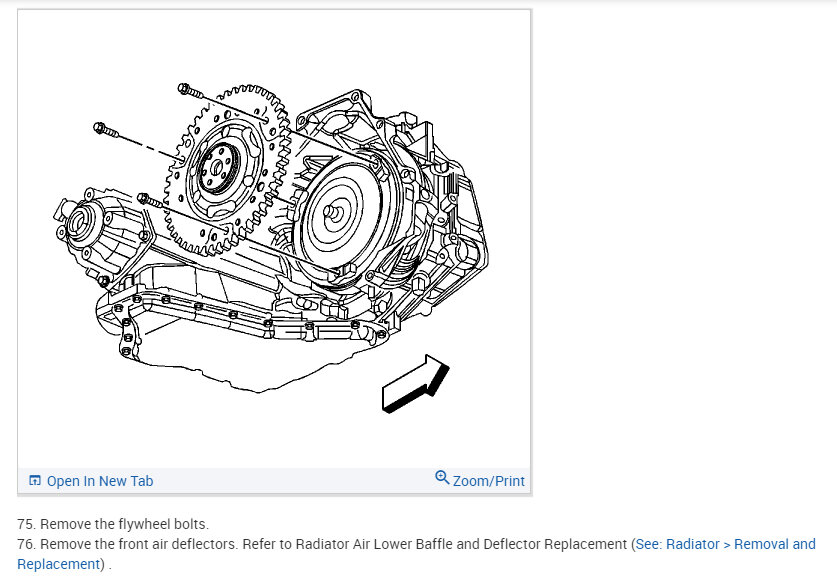

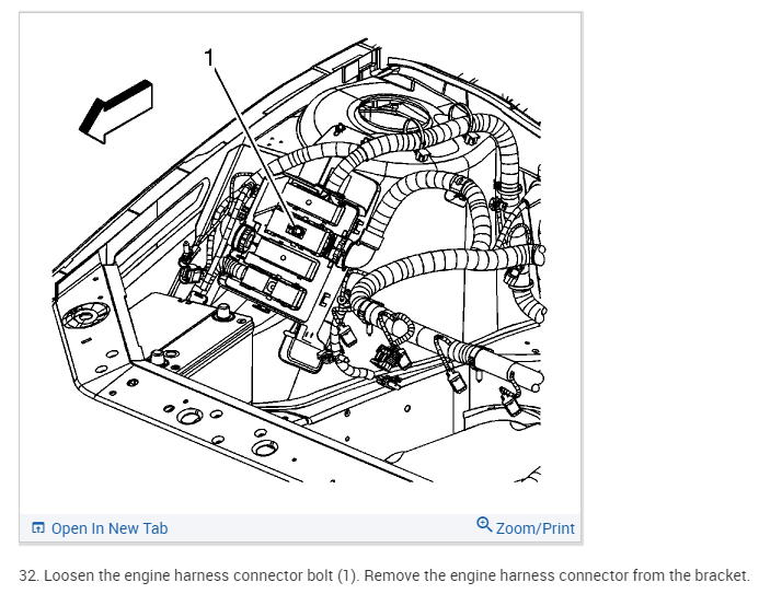

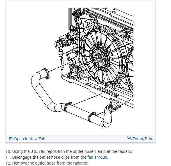

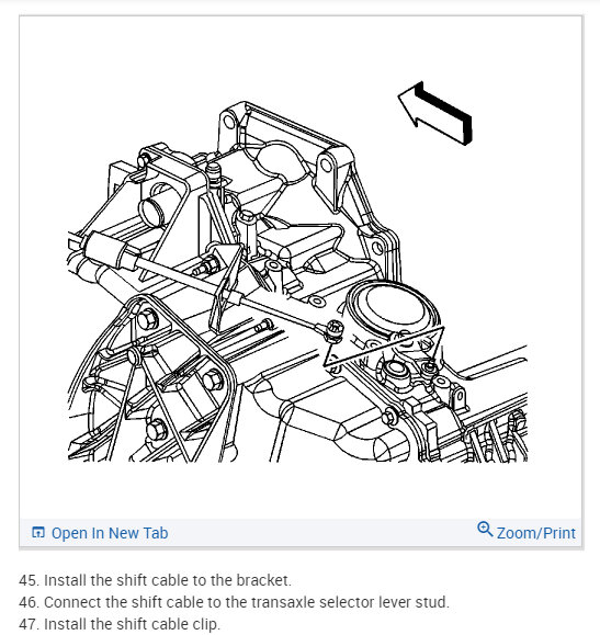

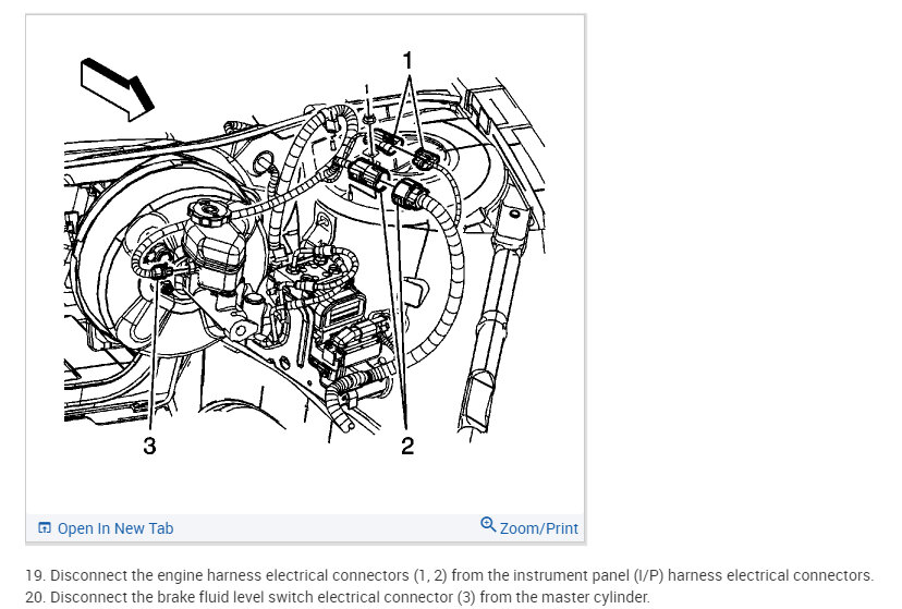

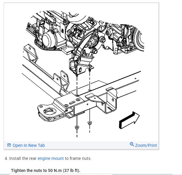

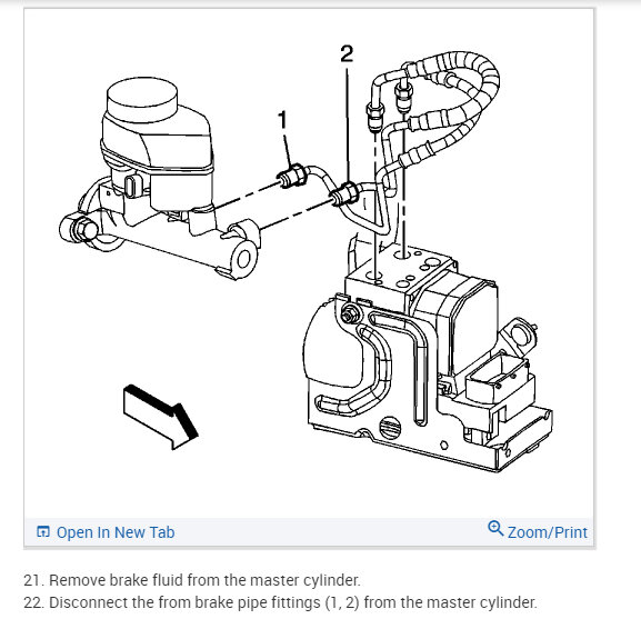

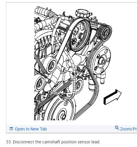

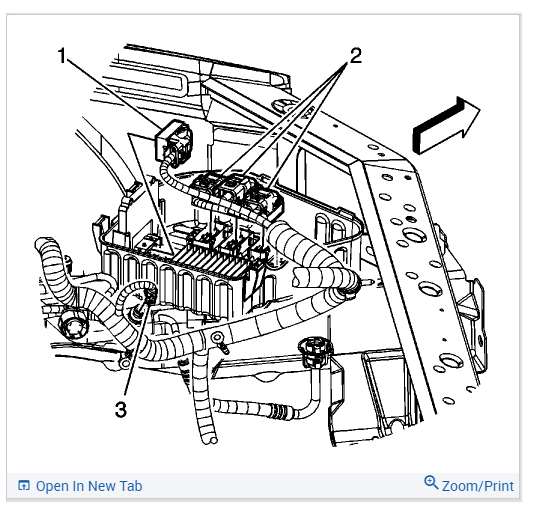

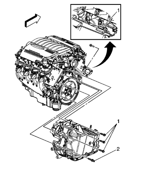

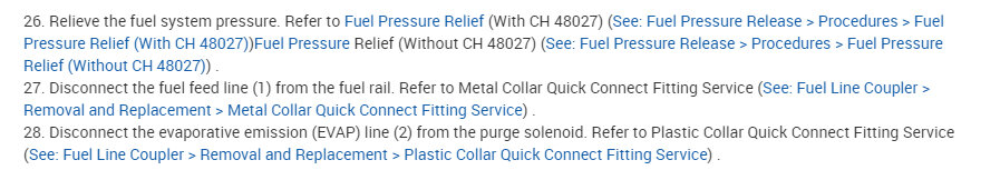

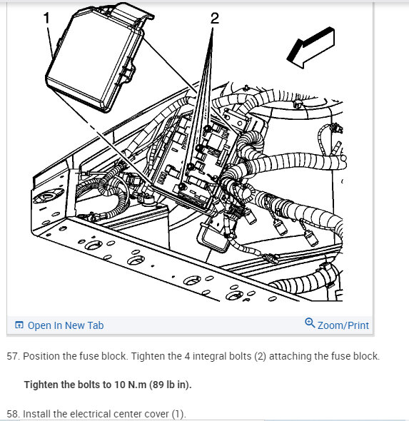

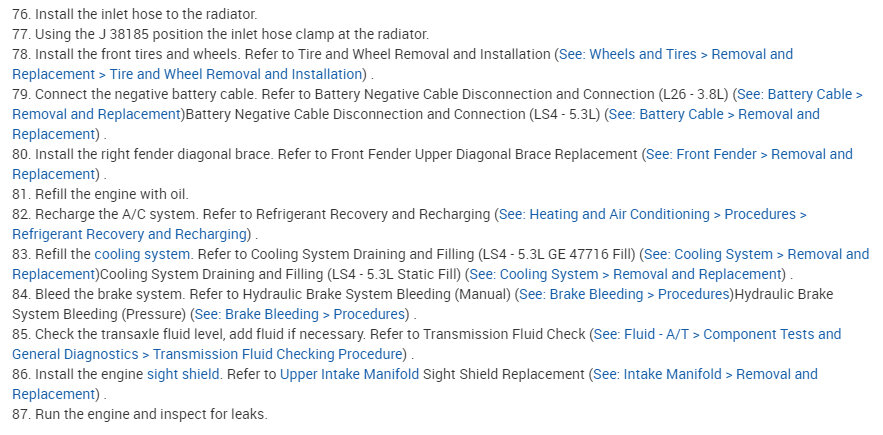

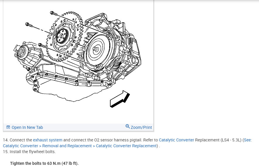

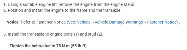

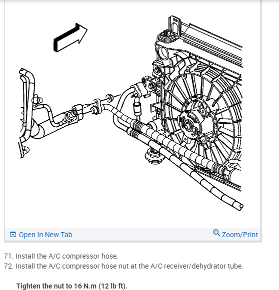

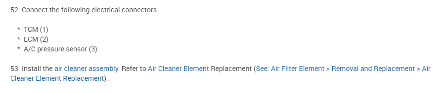

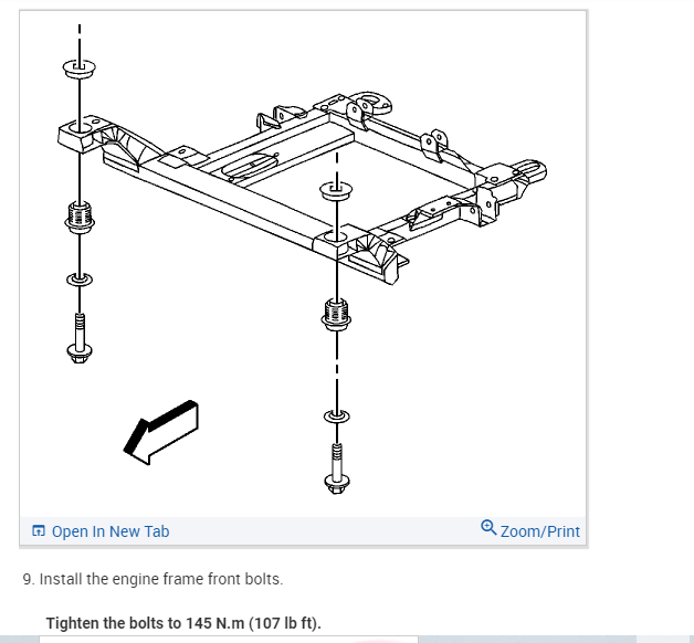

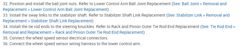

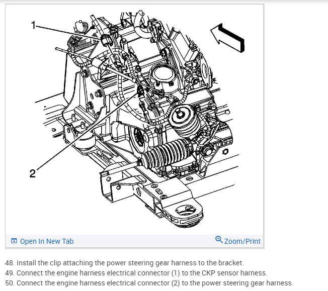

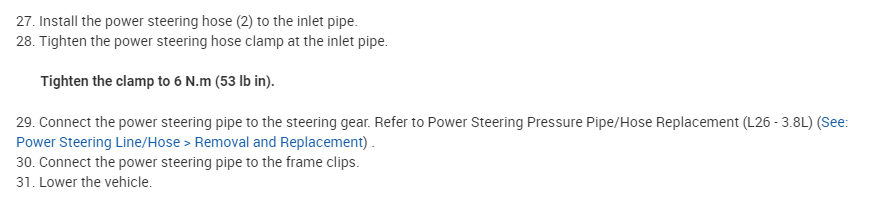

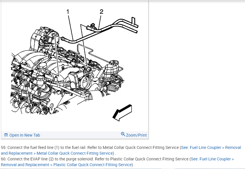

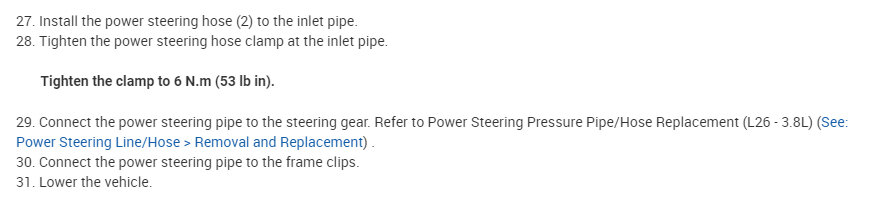

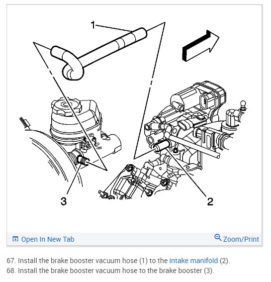

Do y'all have instructions on how to remove my engine from my car?
Dec 1, 2022 at 6:07 AM

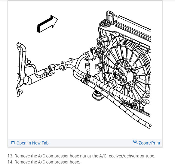

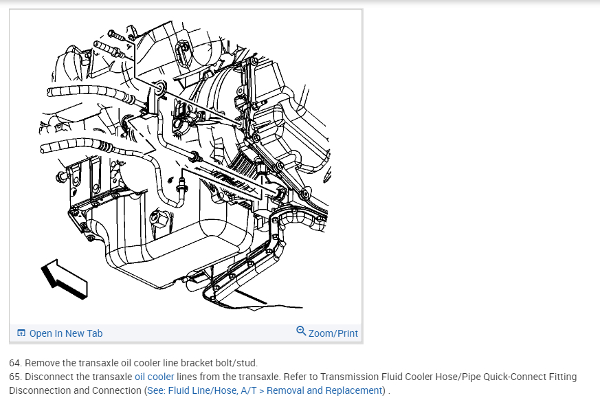

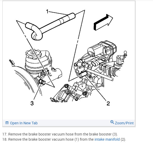

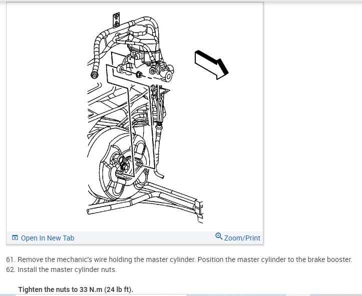

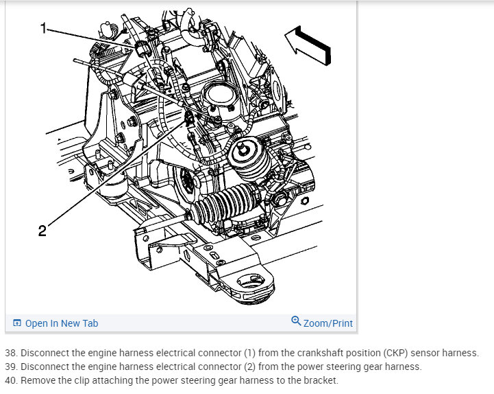

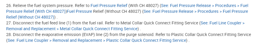

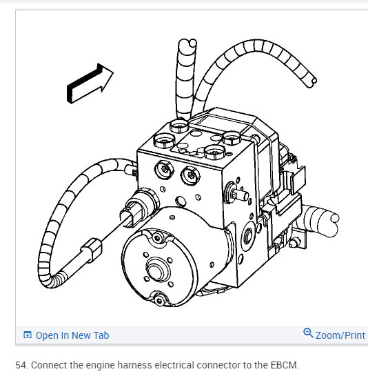

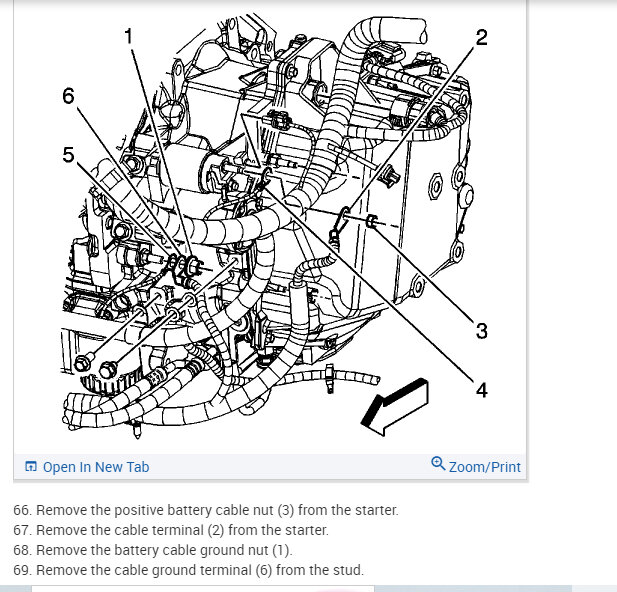

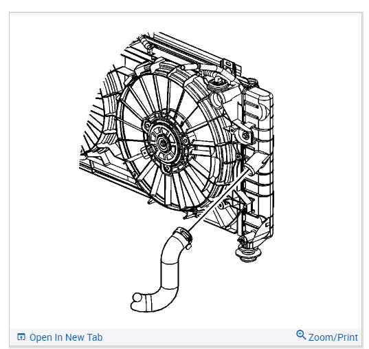

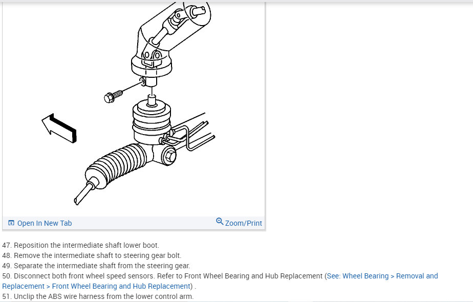

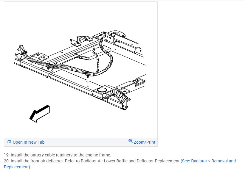

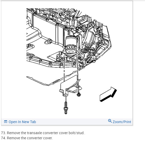

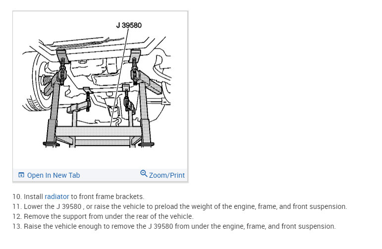

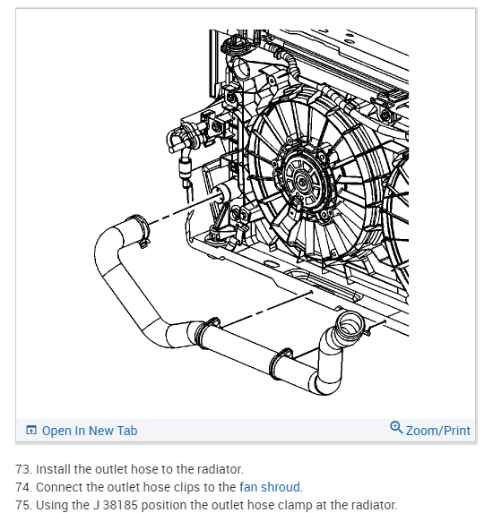

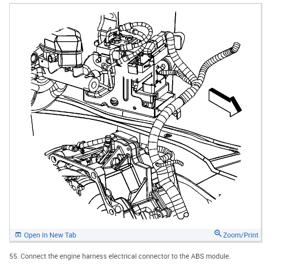

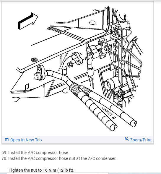

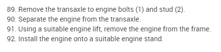

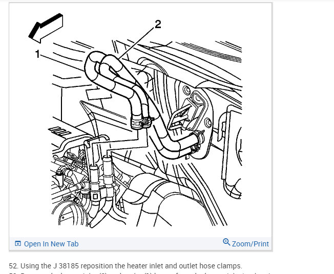

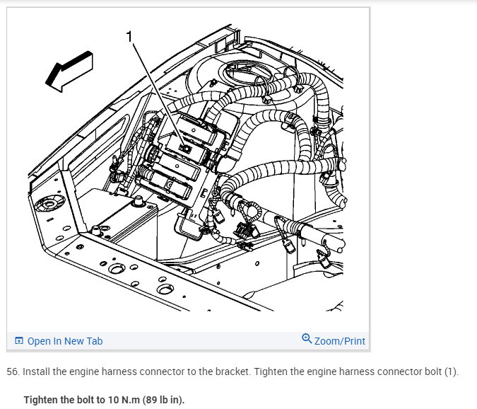

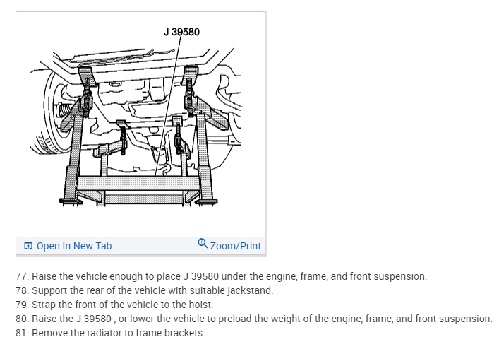

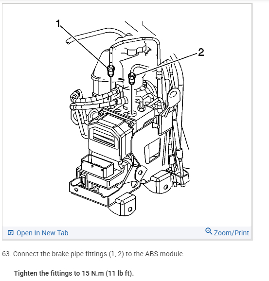

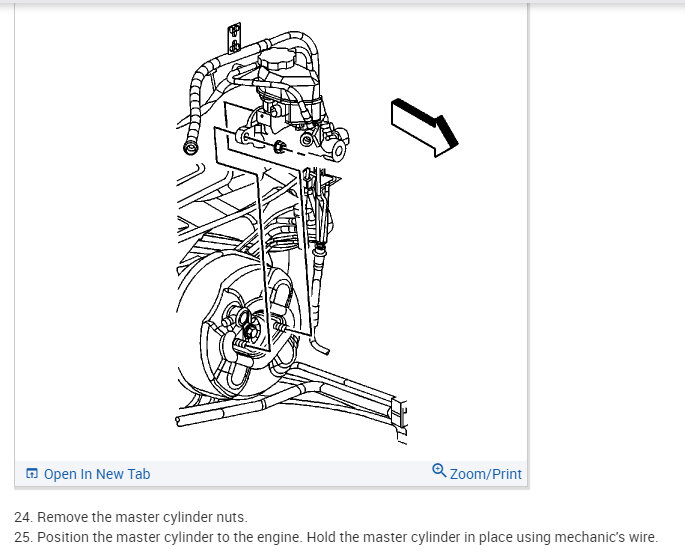

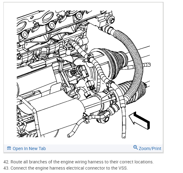

  • 110,240 POSTS

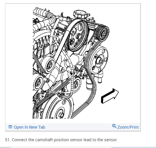

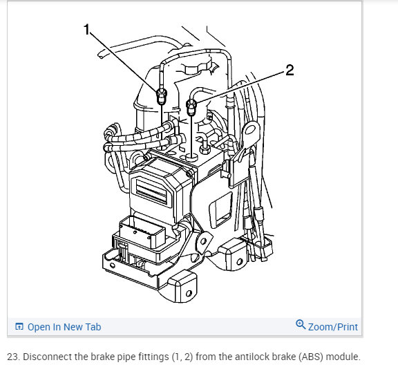

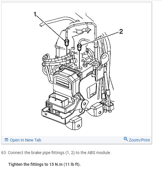

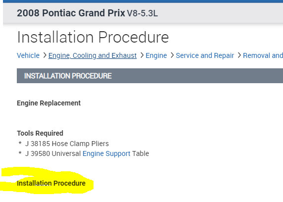

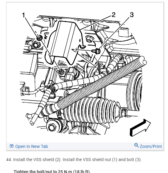

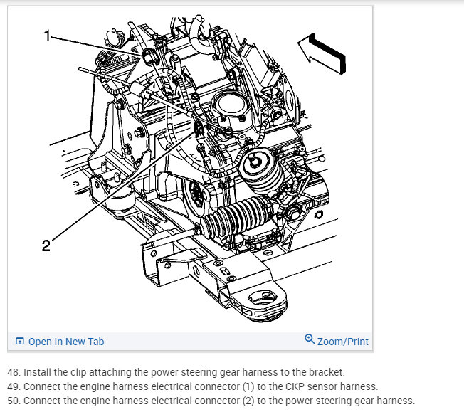

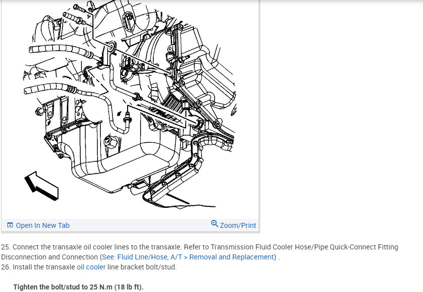

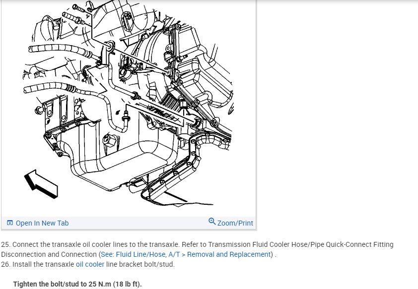

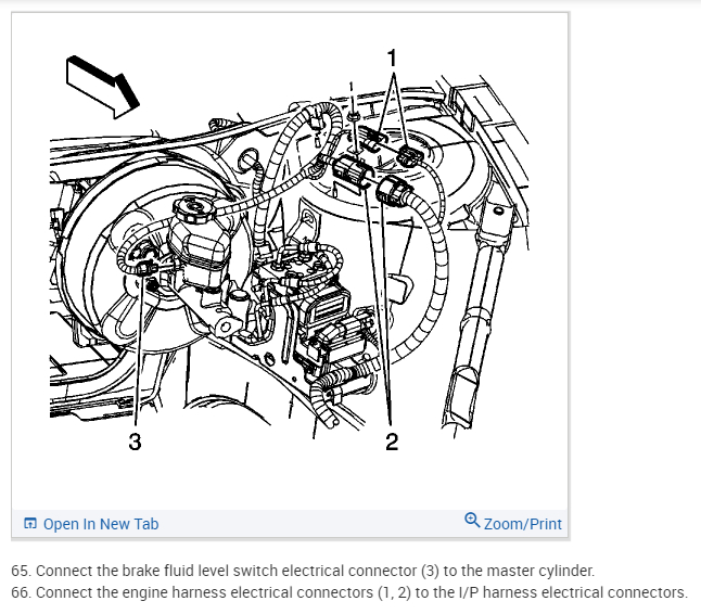

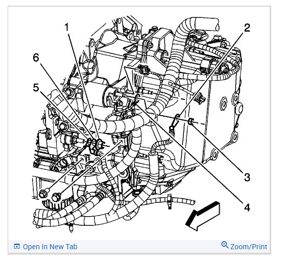

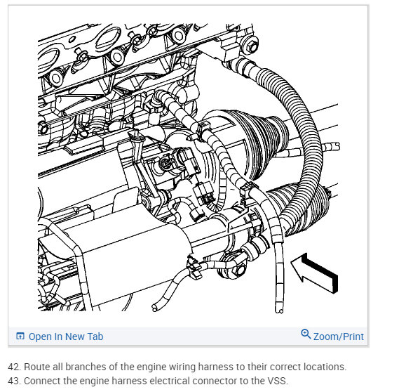

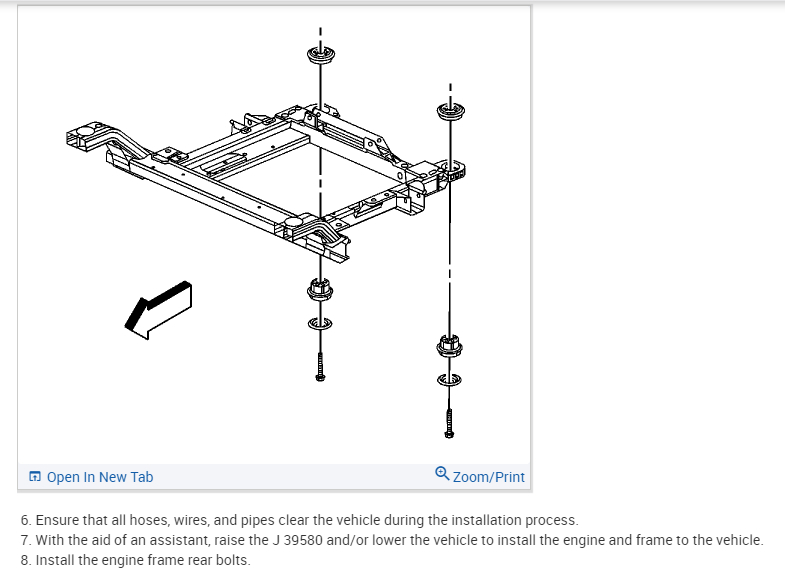

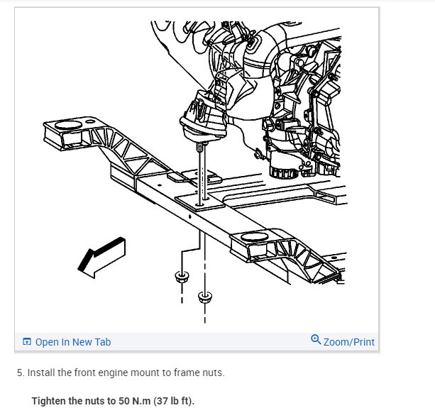

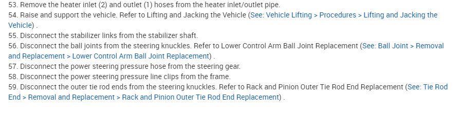

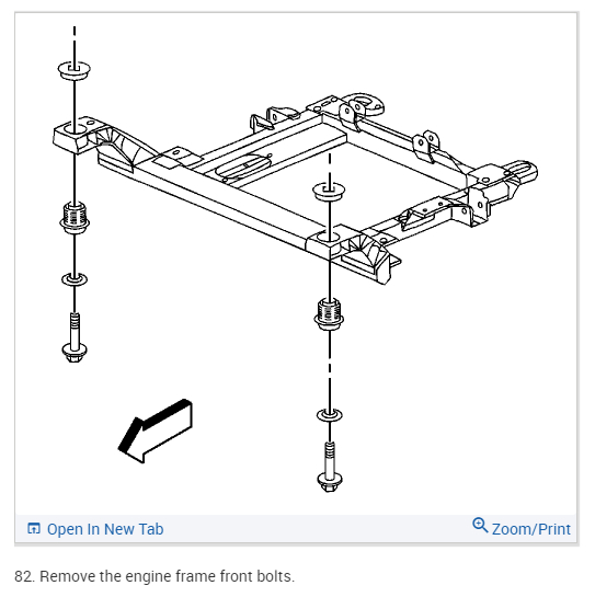

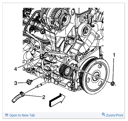

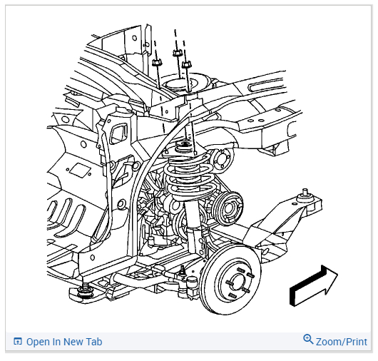

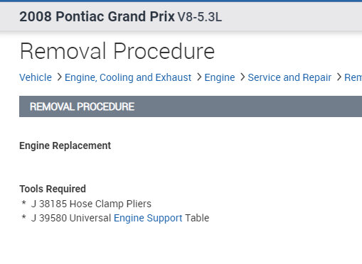

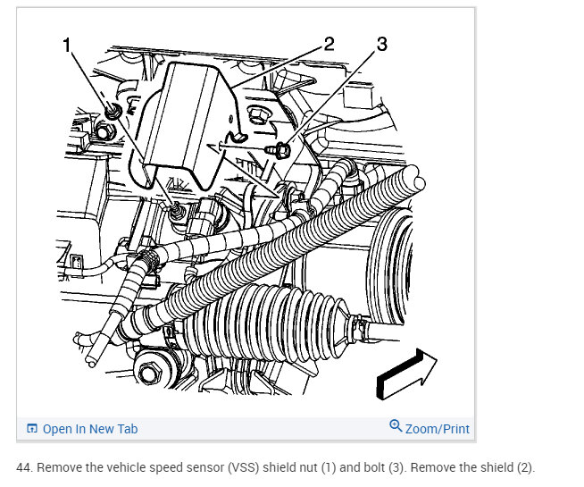

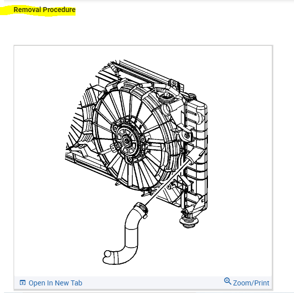

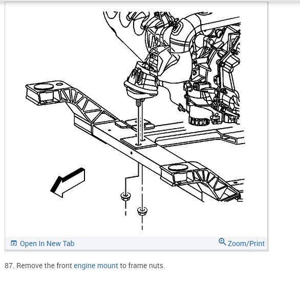

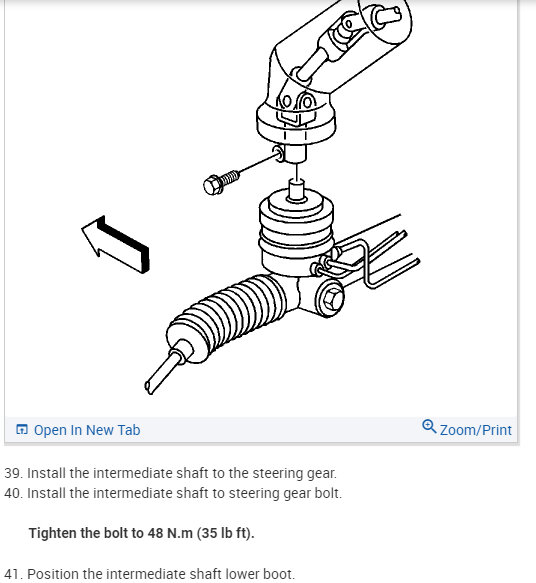

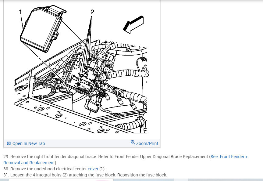

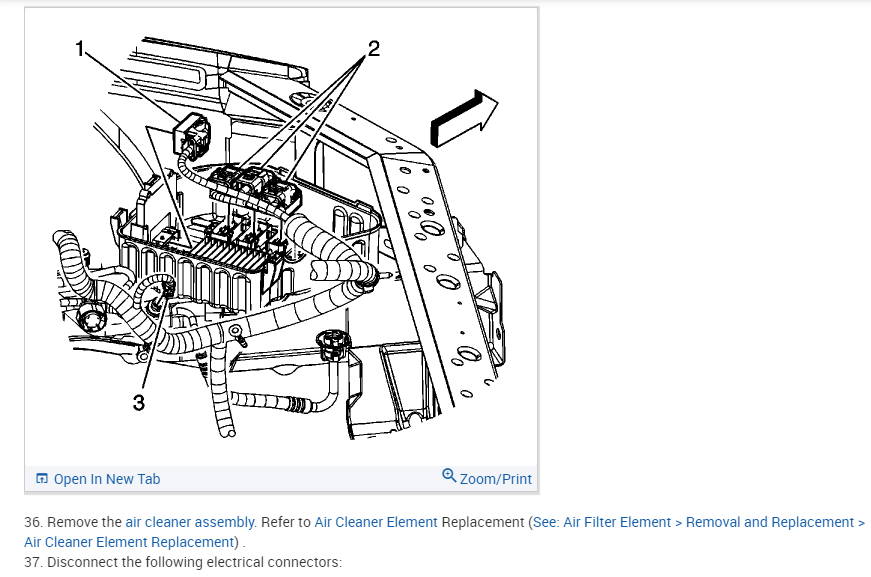

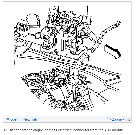

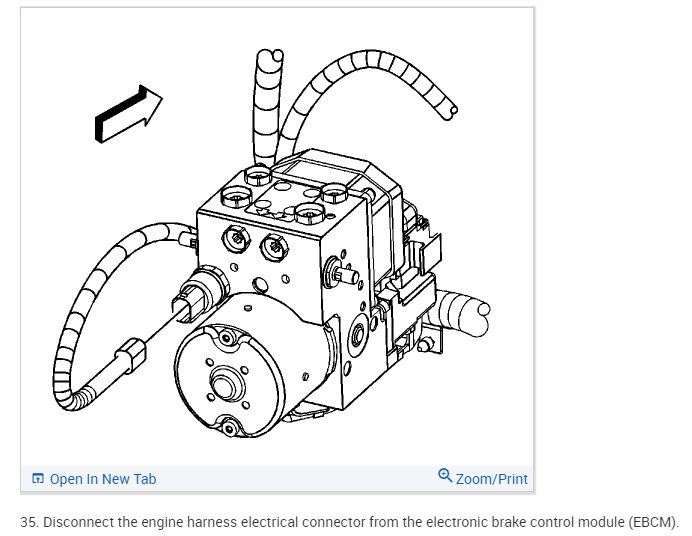

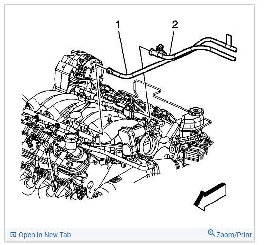

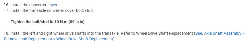

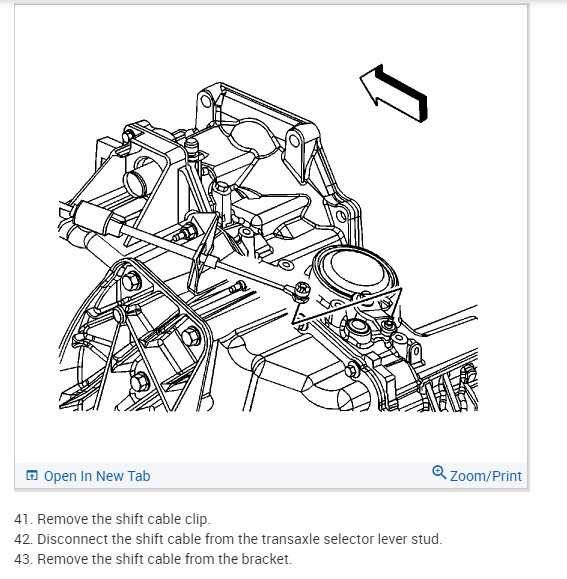

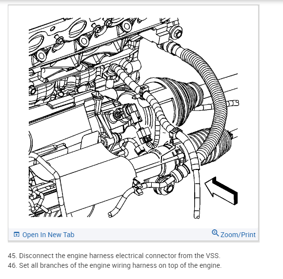

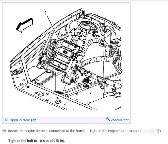

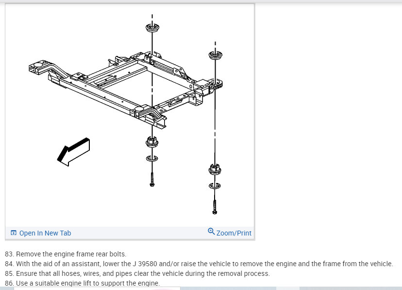

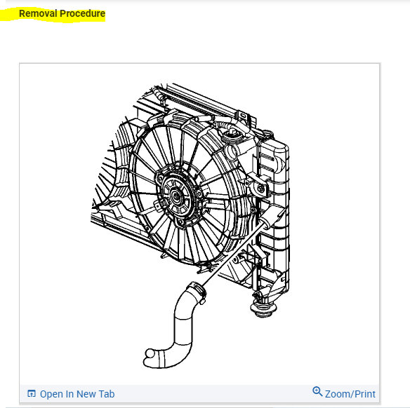

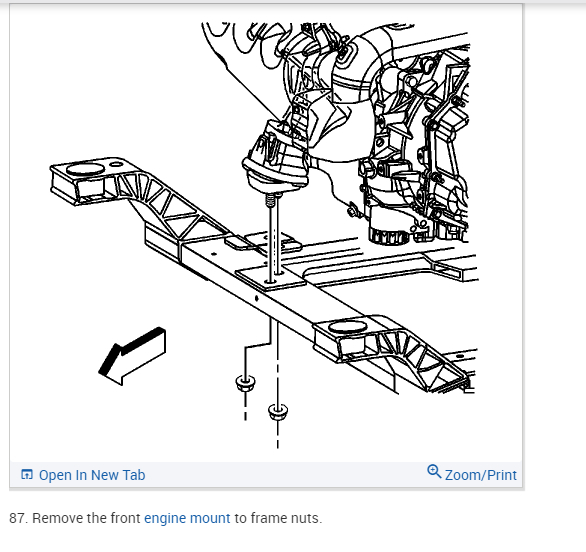

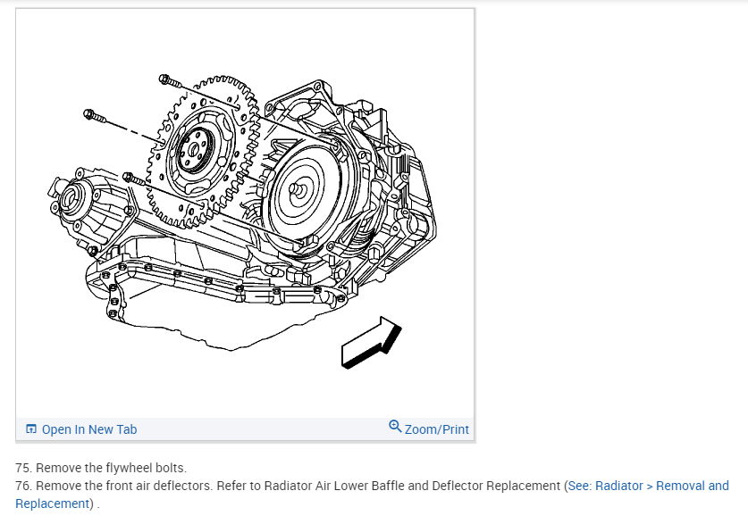

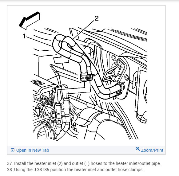

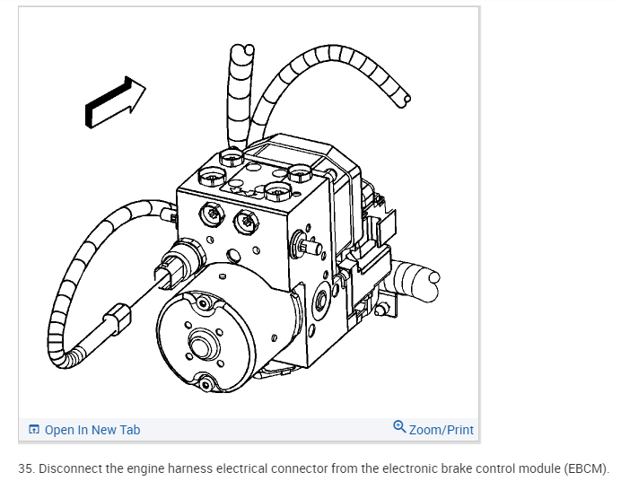

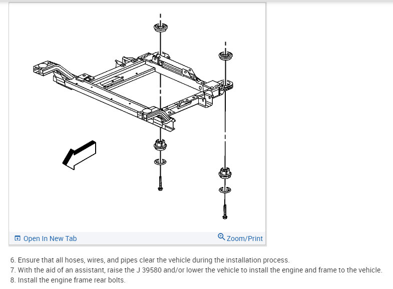

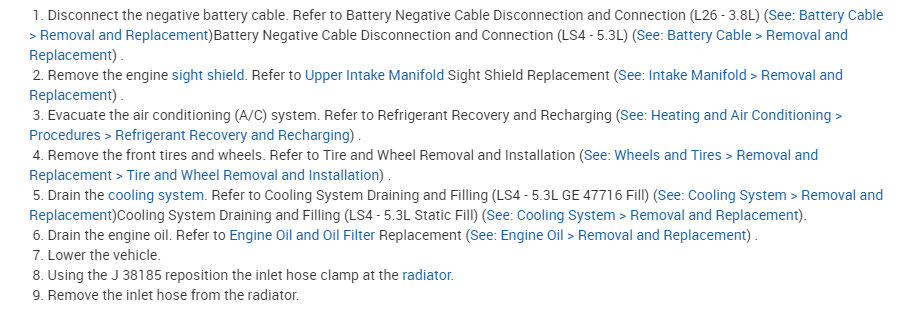

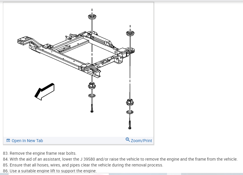

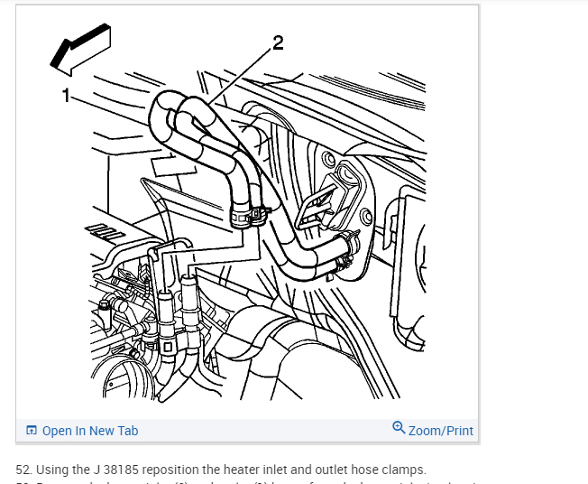

No problem. If you look below, the removal and installation procedures are provided.
Because this has a V8 engine, most everything needs to be disconnected or removed. Also, the engine and transmission will be removed as a unit through the bottom of the engine compartment. As a result, the cradle or framing under the engine is removed with the trans and engine still attached to it.
Take a look through the directions and let me know if you have questions. Also, I would recommend that you follow the order provided and remove everything it indicates.
Let me know if this helps.
