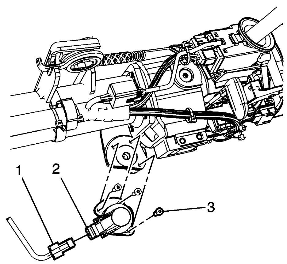

How can I start my van when in Neutral? Can't shift out of Park, which was an intermittent problem over three days, but as of yesterday (Sat 06/19/21) now van is continuously stuck in Park.We learned how to sort of trick the car so we can shift to Neutral, however, in Neutral the car cannot be started. This would allow us to both drive this car to recharge the battery that drained and requires a jump-start followed by driving this car for 60 minutes or more for completing recharging from the starting point of a very dead/drained condition, and, then, once able to start this car, we can move this car to a mechanics' for shift prob diagnosis, likely shift solenoid replacement.

Being able to shift it into neutral is simply to allow the vehicle to be towed. It doesn't allow it to start because of the way the system works. If you step on the brake and start the engine then with your foot on the brake shift out of park the system sees that as the proper operational sequence. Now in that sequence if the engine were to stall with the vehicle moving you could restart it by moving the selector to neutral. It should also start in neutral if you follow that same sequence. However when you bypass the shift lock and release the shifter using a different method it sees that as an invalid sequence and inhibits the starter using the starter relay to block it from starting as it activates part of the anti-theft system.

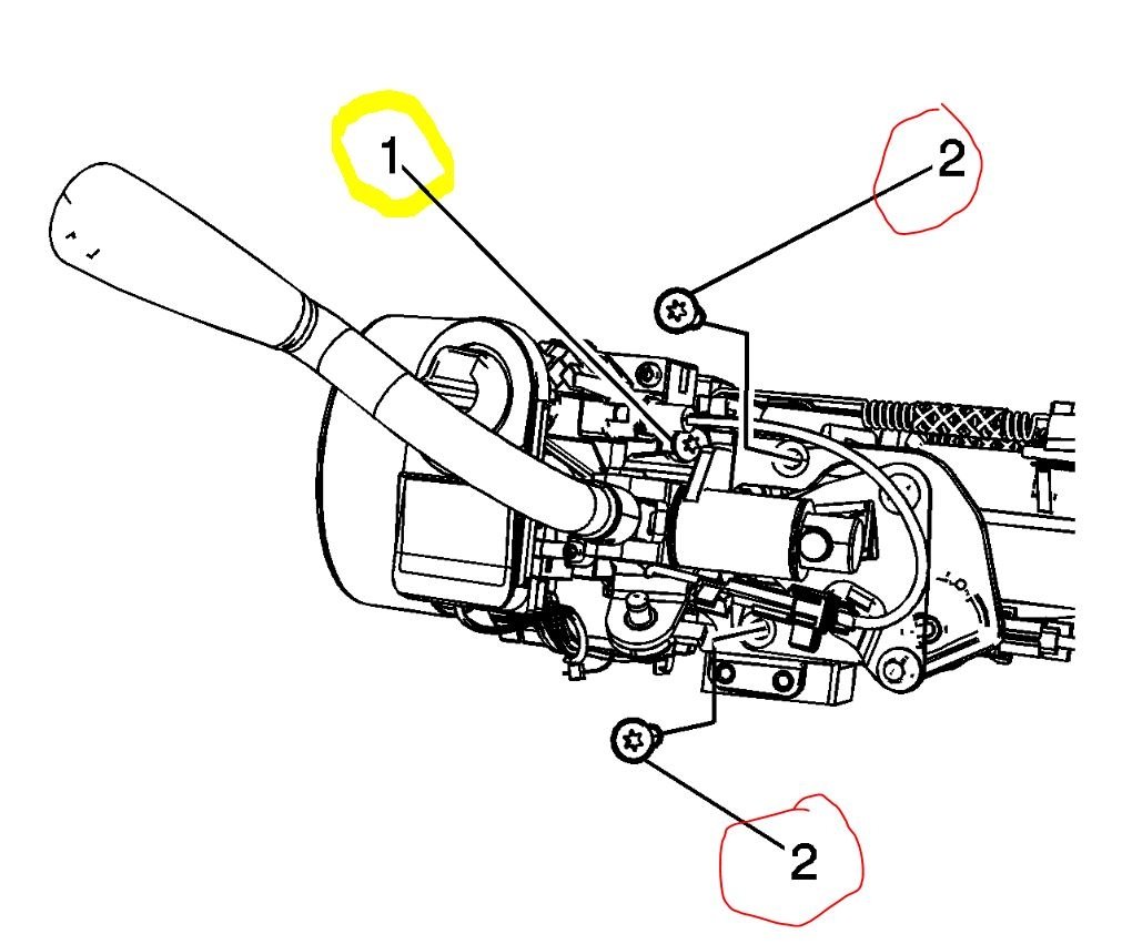

When you step on the brake with the good battery and the engine running can you hear the interlock solenoid clicking? If not it is the likely issue, but it's not a fun repair. The interlock is on the bottom of the steering column and in most cases you need to remove the column to get to it. However you could try to gain access by removing the steering column covers to get to the retainer bolts and the actuator linkage. You remove the bolts in red and loosen the one in yellow. Then the shifter rotates on that bolt until you get the piece down low enough to remove the three screws from the solenoid so you can remove it. Then you reverse the process to install the replacement.
As for starting it in neutral, I don't know of a way because of the way the PCM reads the switches. It acts sort of like step 1, 2, 3 - Start. However if you skip a step or alter it you don't get the start option.
