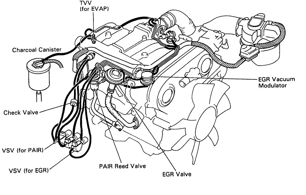

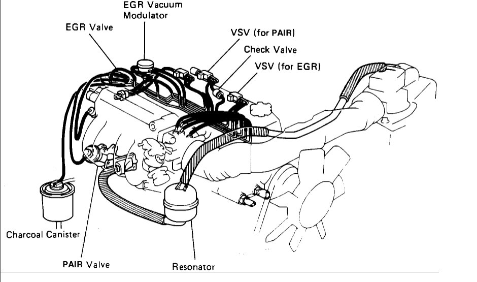

DTERREL
  • 10 POSTS
does anyone know which vacuum hose exactly i need to run my toyota and a diagram
Oct 31, 2017 at 8:08 AM
  • 55,224 POSTS
Here is both vacuum diagrams so you can see which hose goes where is this is what you needed? (below)
