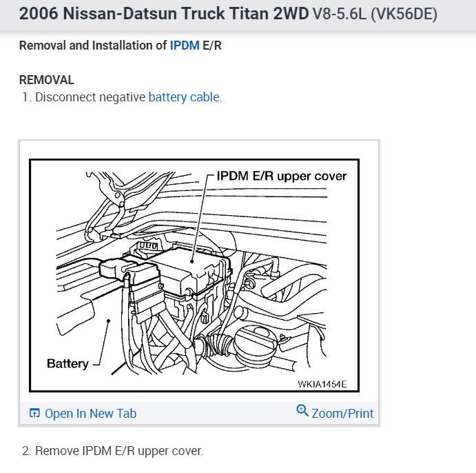

Not running, starts and stalls. New fuel pump, mass air flow sensor, new coils, new plugs, crack shift sensor, crank sensor. Why does my truck not run?

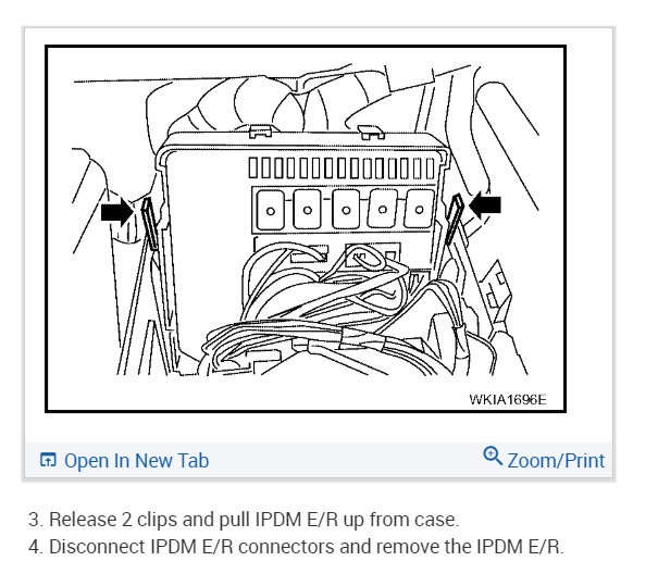

These trucks had a problem with the IPDM. to be sure here is a guide to check it with the location of the relay in the diagrams below and how to replace the IPDM:
