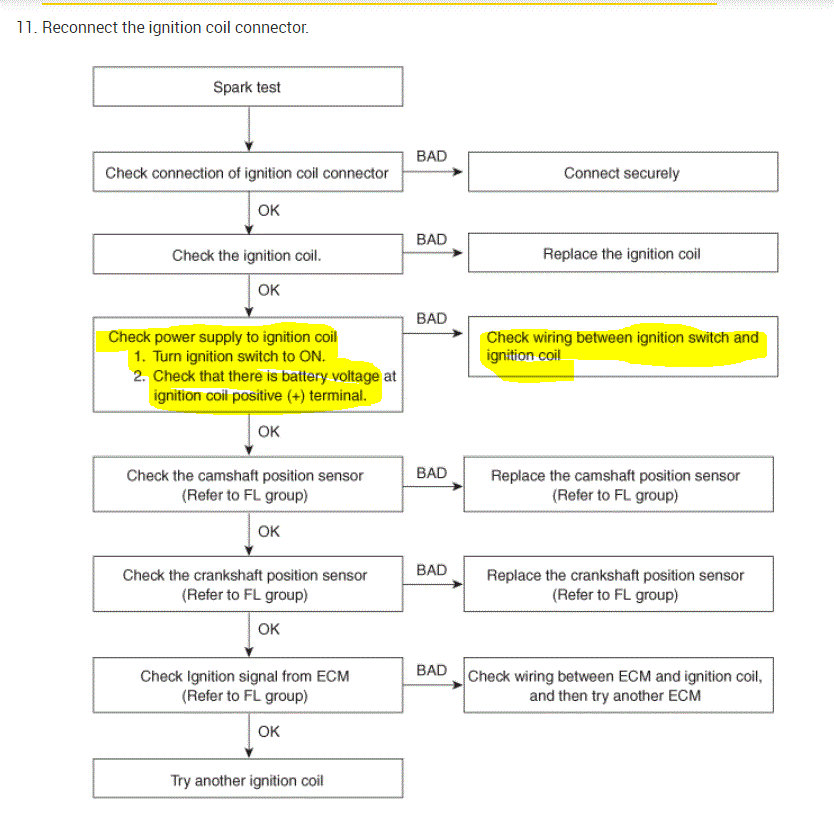

Will not stay running
2015 HYUNDAI GENESIS COUPE
70,000 MILES • V6 • 2WD • AUTOMATIC
SWILSON3828
  • 112 POSTS
Vehicle listed above is a Genesis Coupe 3.8. It stalled a few days ago, started and stalled again and eventually left me in limp mode shortly thereafter and now it will only start and then immediately shut off like ignition is being cut. Initial codes thrown were P0560, 0638, 2106, and 2110. Mechanic replaced crank sensor with an aftermarket sensor prior to all of this. I cleaned throttle body and ended up replacing with a new one to no avail. I can see the RPMs on the tachometer move when cranking so I believe the CPS is sending a signal. Cam position sensors have also been checked. Codes were cleared and now the only one that comes up is the 0560 code. Checked spark with a light and the only time the light lights up is when the engine briefly starts before shutting off. It doesn't light up when cranking. for example; when attempting to start the light will flash briefly one time when if fires, but if I continue the crank the light doesn't light up anymore. It's like this on all cylinders. Thought it might be aftermarket remote start messing ignition signal up so I traced wires and removed the device, but didn't help. Any ideas would be appreciated. Thanks!

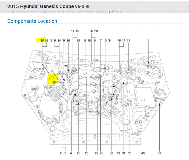

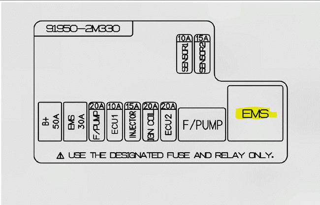

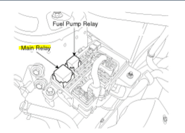

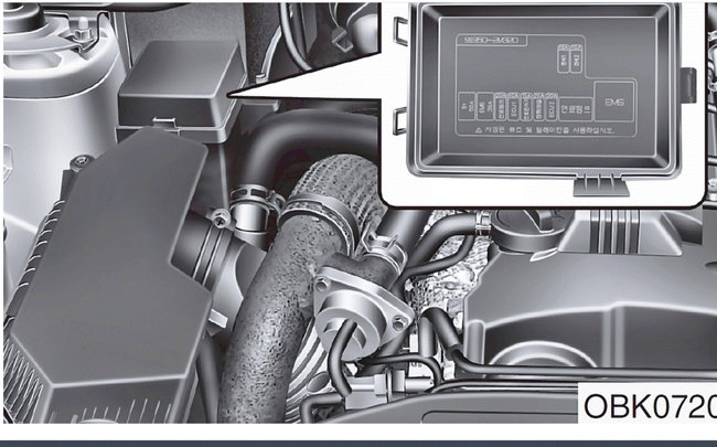

If you are seeing the tachometer move, then the crankshaft position sensor is likely working. It sounds like you are getting spark when the key is in the start position and then lose it when you turn the key to run. It could be related to the engine management system relay (main relay).
Take a look below. I attached two pics, The first is the relay location and the second is the location of the EMS relay. Remove that relay and check it. Here is a link that shows how to test the relay:
If it checks good, on each coil pack, there will be a pink wire. Disconnect one of the connectors, turn the key to the run position, and there should be power to the pink wire on all coils. A ground path is provided via the PCM when the coil should engage.
Here is a link that you may find helpful:
Let me know what you find. If the EMS relay is good and there is no power to the coils and all fuses are good, we have to move to the ignition switch.

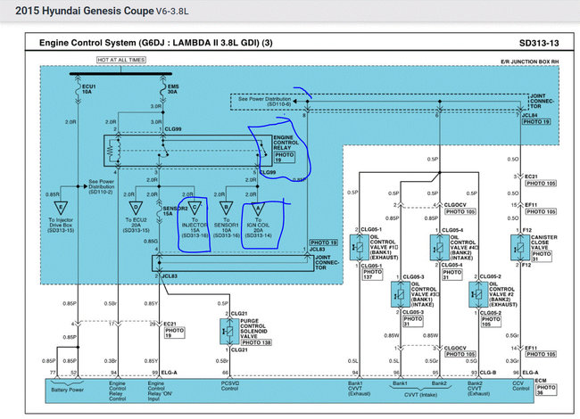

Were you able to confirm if there is power to the coils with the key in the run position? Take a look at pic 1 below. I highlighted where I feel we are at this point. If there is power, then we need to inspect the cam and crank sensor. If there is no power, then we need to check the wiring between the ignition (push button) and the coils. Just fyi, the powertrain management schematics are 7 pages long. Ugh. LOL
See pic below.

So sorry.. yes, there is an approximately 5 volt combined reference on the coil connections with the ignition on. One connection point in the harness is 3.4 and the other around 1.65. I should have included that information beforehand. Also, for both cam sensors, with the ignition on, there is a 4.7 volt reference on the signal wire, a 4.9 volt reference on the positive wire, and verified ground on the ground wire. I have tried to back probe the crank sensor but it is nearly impossible because of the gauge of the two connected wires and the location of the sensor. Also, not sure if it makes any difference, but this car is a 2015 3.8 with a 2013 3.8 engine in it. The motors are the exact same but I noticed the wiring harness part number for the 2013 car is different than the part number for the 2014 and 2015 car. (just found this out yesterday) Never have been able to figure out what the difference was. In any event the harness that came with the car is the one that is being used and since the engines are the same and everything "fits" then I'm figuring this isn't an issue as the car was driving fine before this issue started. Thanks again for the help.

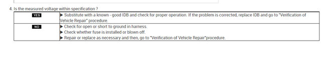

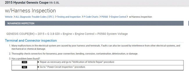

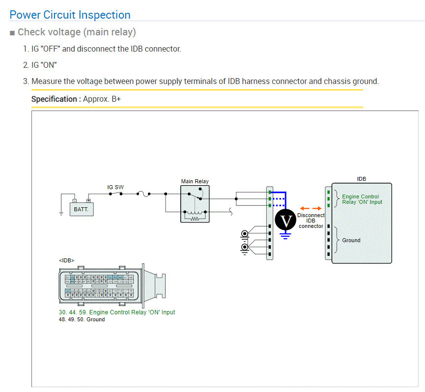

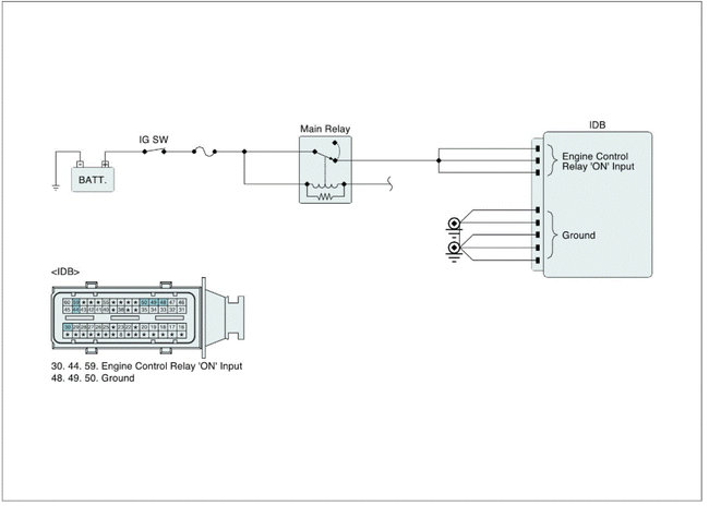

The compression sounds fine. I looked back at the code you provided (P0560). Since we know there is an issue there, let's start by checking.
The code leads us to the IDB (injector drive box). This also takes us back to the main relay I previously mentioned.
Take a look at the attachments below. That is the test procedure for the code. Let me know what you find.
Also, the voltages you mentioned above sound fine.
Jul 20, 2021 at 1:36 PM
SWILSON3828
  • 112 POSTS
Thank you again. I did verify ground to Pins #48, #49, #50 on the injector distribution box connection, and also verified voltage on pins #30, #44, #59 ....all three between 2.4v and 2.6 v.

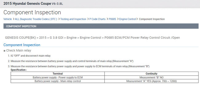

  • 110,241 POSTS

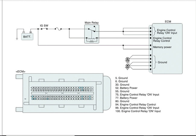

The code you have is for the power relay "open". Basically, that indicates there is a broken wire or one that isn't connecting for some reason.
Pics 1 and 2 below show the location. The remaining pics are test procedures for this code.
Let me know if this helps.

Greetings,
I checked the ECM harness per the information above and this is what I came up with, and these readings on the positive points are with the ignition in the "on" position
#'s 5,6,30,55,80 (Grounds) all measured 5.2 Ohms
#52 Battery 12.26 volts
#75 ECR Relay "on" input .87 volts
#77 Battery 12.26 volts
#94 ECR control 12.25 volts
#99 ECR "on" input .87 volts
#100 ECR "on" input .87 volts
....so it appears the ECR main relay is only transferring .87 to the to the ECR "on" inputs when energized.

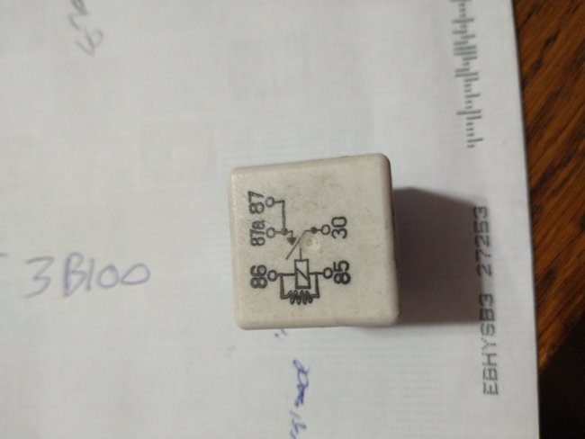

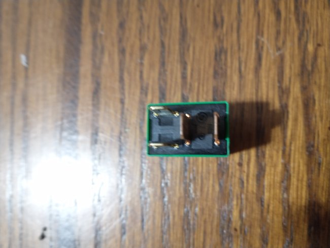

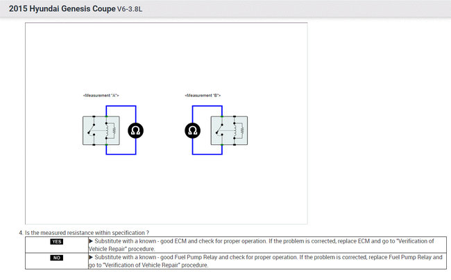

I am a bit confused on testing the ECR per instructions as on the diagram page that shows measurements A and B it mentions if "no" then replace with a known good fuel pump relay, so I tested both of the relays per the instructions. Unfortunately the fuel pump relay doesn't have a schematic diagram on it like the ECR does
For the ECR the control pins (85 & 86) are showing 16.2 ohms and the load pins (87a and 30) are showing infinity. With the ignition off there is a constant voltage at both pins 86 and 30.
The FPR the control pins ( the darker bronze pins on the picture) are showing 88 ohms and the load pins (the two lighter gold colored pins) are showing infinity. The only pin on the FPR that has a constant voltage with the ignition off is the bronze pin furthest right. Also, and finally I was unable to locate a ground on the ECR connection at the fuse box with the ignition on or off. My apologies again for the length and thank you
Jul 24, 2021 at 1:44 PM
  • 110,241 POSTS
It sounds like the ECR relay is bad. As far as the fuel pump relay, are there any markings on the bottom of the relay?
Take a look through this link and see if anything helps:
