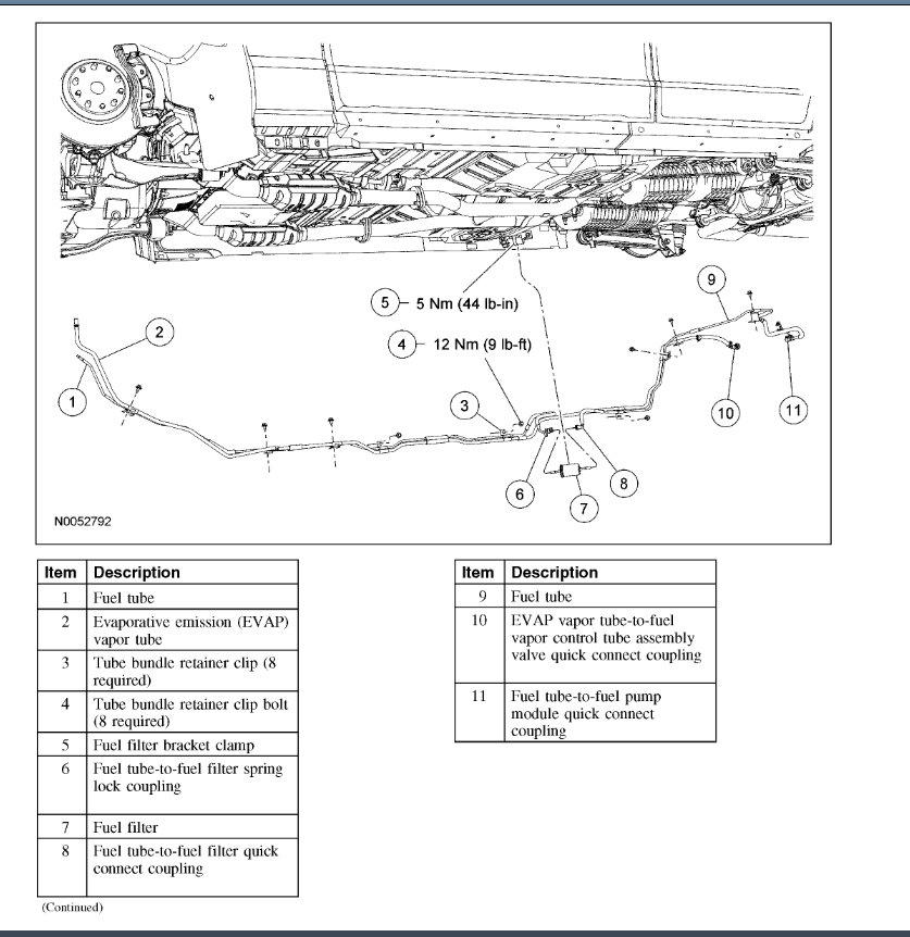

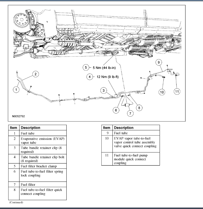

Someone on the Lincoln forums told me he had the same problem, he said it was the fuel filter, it gets clogged if you fill up right after the fuel tanker refills the gas station, he says it stirs up sediment and will clog a fuel filter.
Sep 8, 2022 at 12:41 AM
  • 55,423 POSTS
That is possible, here is a guide to help you see what you are in for and the filter location in the diagrams below also I have included the video on how to get the line off of the filter.
https://www.2carpros.com/articles/how-to-change-a-fuel-filter
and
https://youtu.be/Boi0DPXVHbM
Sep 9, 2022 at 10:18 AM
AARON
Turns out it was the fuel filter. thank you guys.
