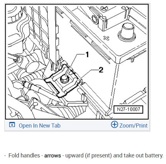

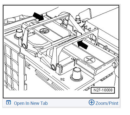

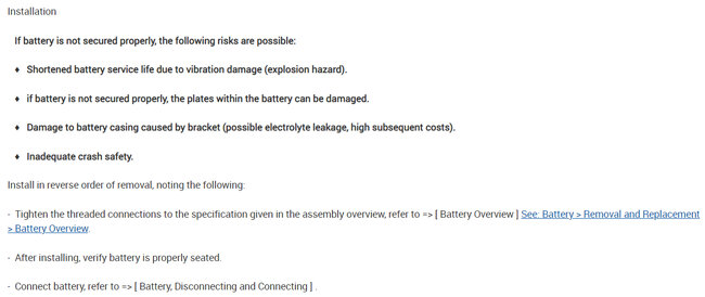

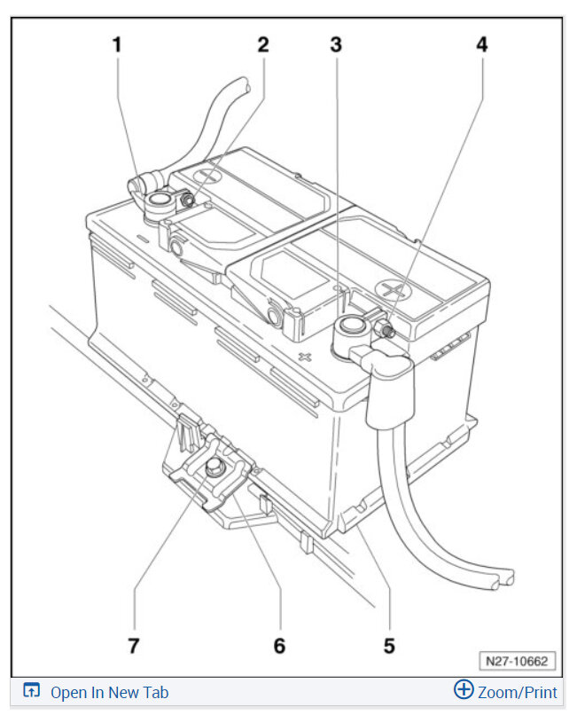

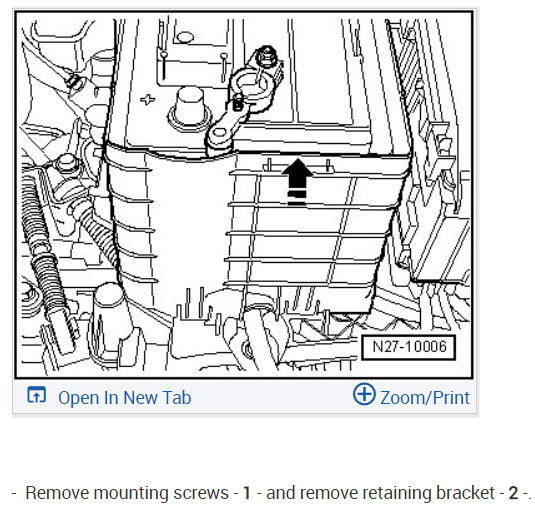

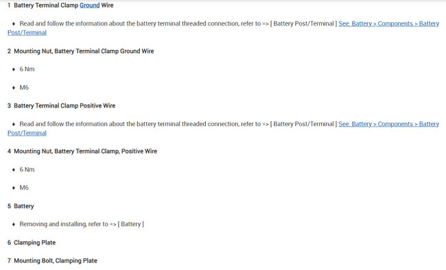

Yes, it sounds like the battery has gone bad which can happen if the battery is more than 3 or 4 years old. To be sure we can do a load test, or you can take the battery into an auto parts store for testing as well.

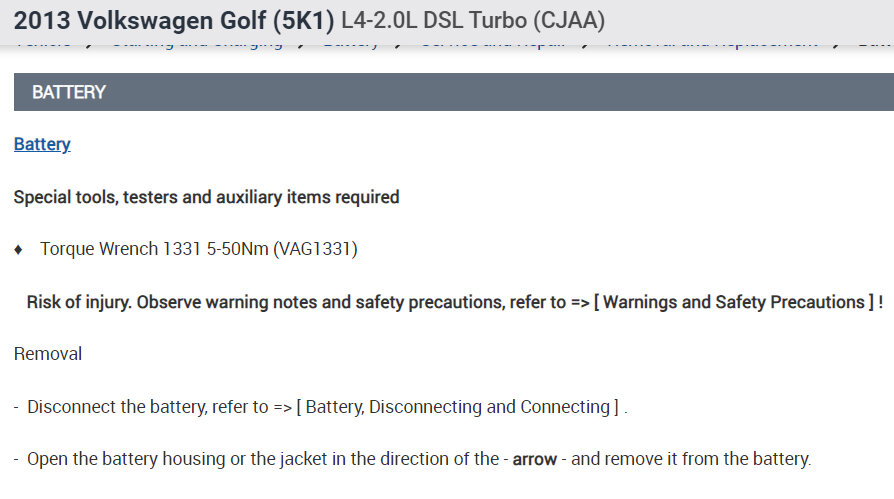

Here is how to remove the battery for testing or replacement. Where gloves and eye protection before you begin, this guide can help but please check out how the job is done on your car in the images below.
https://www.2carpros.com/articles/how-to-replace-a-car-battery
Check out the images (below). Please upload pictures or videos of the problem so we can see what's going on.
