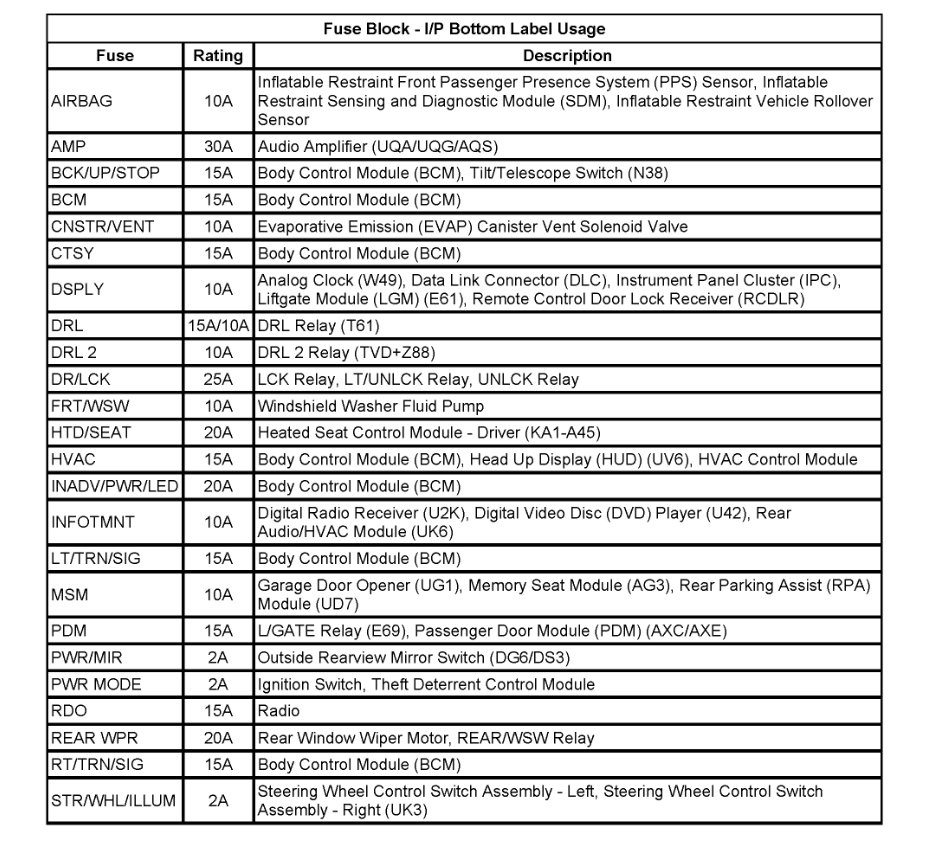

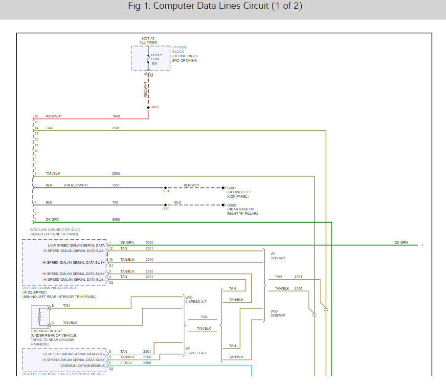

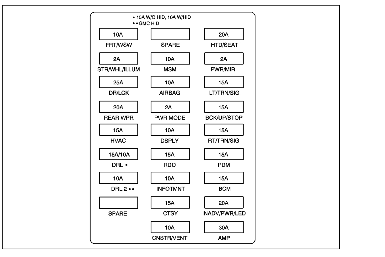

We need to check for power at the DSPLY fuse in the interior fuse panel. here is a guide to help with the fuse location in the diagram below:
Check out the diagrams (below). Please run this test and get back to us.
