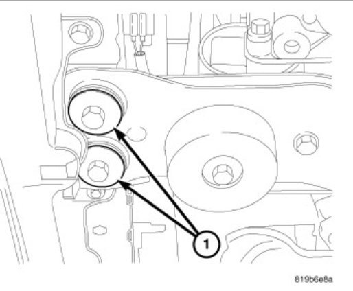

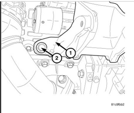

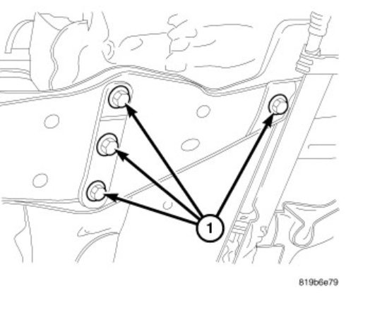

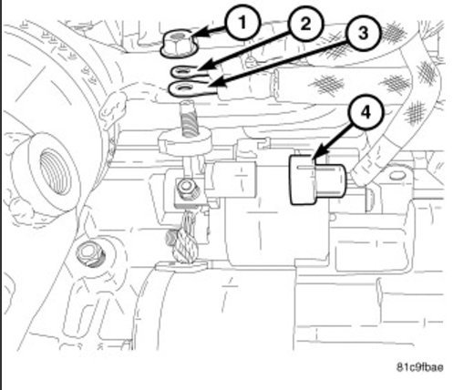

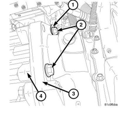

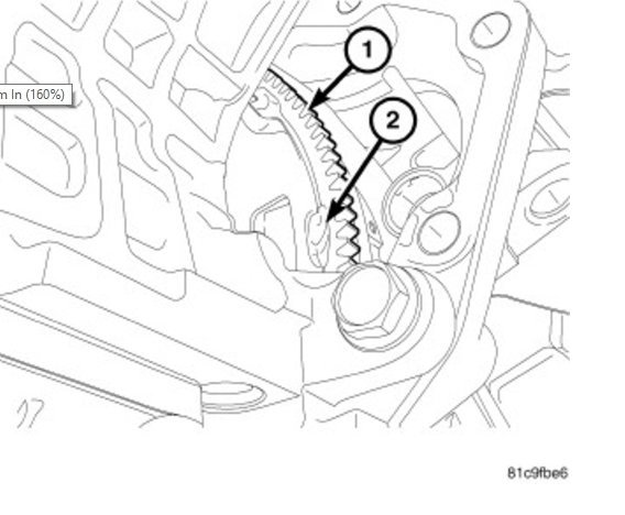

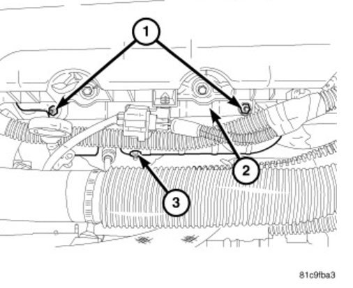

It sounds like you have a starter that is going out, here is a guide to help you confirm. Look toward the bottom of the guide.
https://www.2carpros.com/articles/car-engine-will-not-crank-over

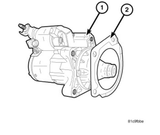

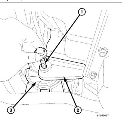

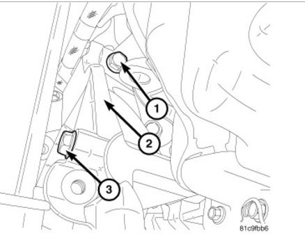

and if so here is a guide will show you what you are in for when doing the job.
you will need to jack up your car.
Please run some tests and get back to us we are interested to see what it is.
