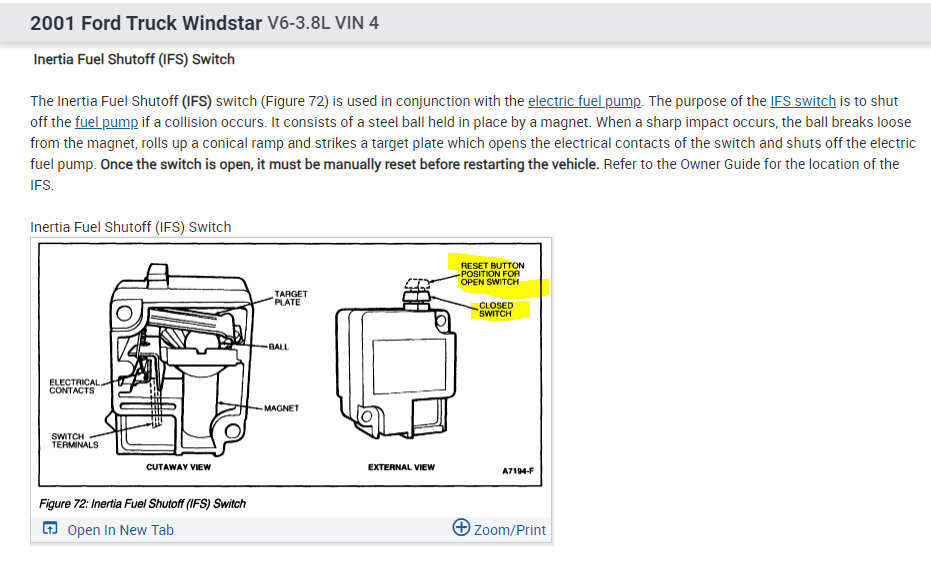

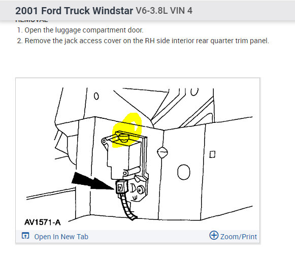

By chance, do you hear the fuel pump turn on and prime for a second or two when the key is first turned on? If not, start by resetting the inertia switch. It is located on the right rear of the vehicle behind the jack.
I attached two pics below. One explains how to access it and the other is to help you identify the switch. This switch is designed to shut down the fuel system in the event of an accident. However, they put a reset switch on it for a reason. LOL
Let me know if this helps or what you find. Also, if you hear the pump prime, let me know that as well.

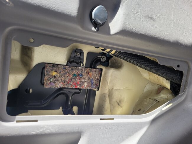

This is a picture of what's behind my jack.

The switch should be at the right rear of the vehicle. My manual indicates behind the jack, but anything is possible.
If you hear the fuel pump, the inertia switch isn't the problem. I did a little research on codes P0171 and P0174. Both are lean fuel mixture related. The other two codes are misfire codes which could be the result of a lean mixture.
