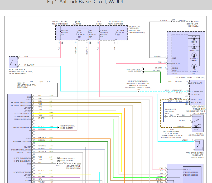

B2991 Right front door ajar circuit malfunction, C0050 Right rear wheel speed sensor circuit malfunction, P0121 Throttle/pedal position sensor/switch "A" circuit range/performance. Plus the ABS and The stabilitrac service light comes on randomly too, even just sitting idling. I changed the pedal position sensor and the right rear wheel speed sensor and erase the codes but in a few days they come back, it does seem to be more prominent in wet weather, do you suspect the PCM? I inspected wiring and connections and all looks good.

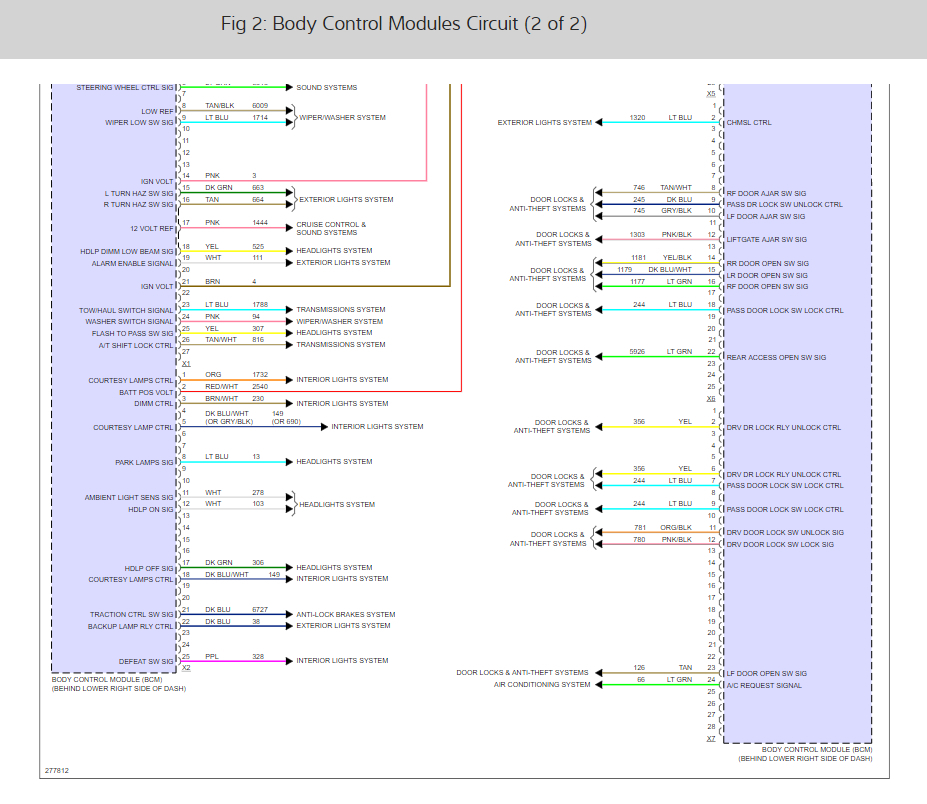

Did all of these codes come up at once? Can you clear the codes and then turn the key on and without starting the gnien see what codes come back? This sounds like two problems. I would service the throttle bore first for the P0121. I do not think PCM because the door and ABS does not go through it. BCM maybe. Please let us know what you find. We are interested to see what it is.

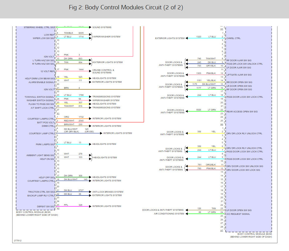

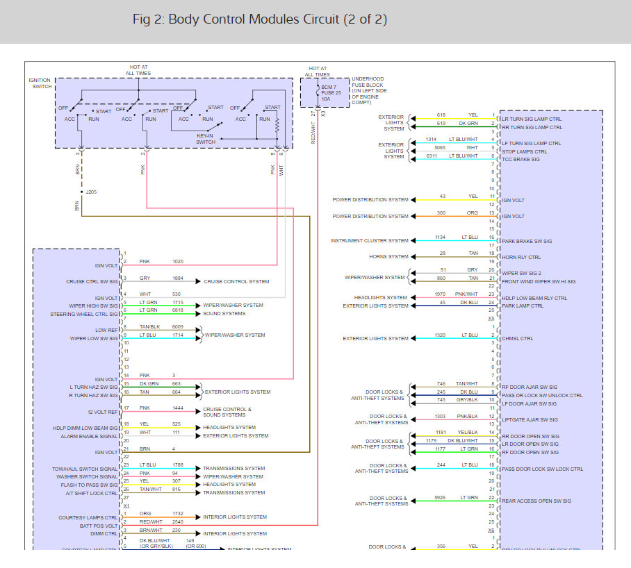

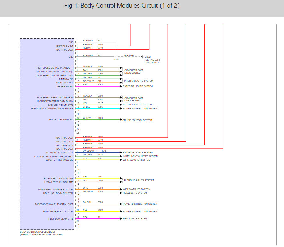

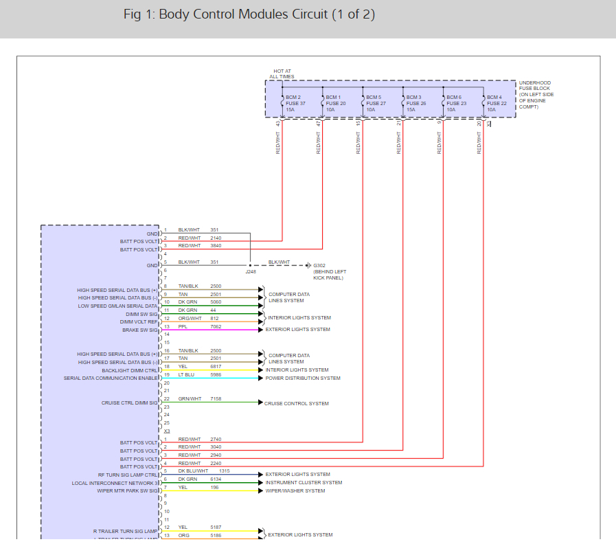

Okay please service the throttle body. It sounds like one problem or three like a bad ground in the engine or passenger compartment let's start by checking the grounds by following this guide and the BCM wiring diagrams below.
Check resistance to ground on both the BCM and ABS module. Let me know what you find.

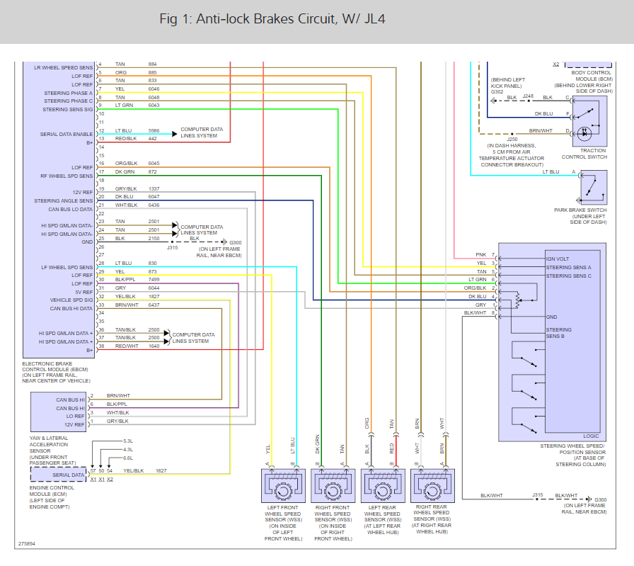

Thank you for the diagrams they will be very useful. But there are some abbreviations that I am not familiar with, What is "LOF REF" and how do I test these? And it does not show where all the grounds are so I can check them as well.
Nov 11, 2018 at 12:21 AM
  • 55,399 POSTS
The grounds are listed black/white on the first diagram and just black on the ABS module. Do not worry about the LOF REF which is a monitoring line.

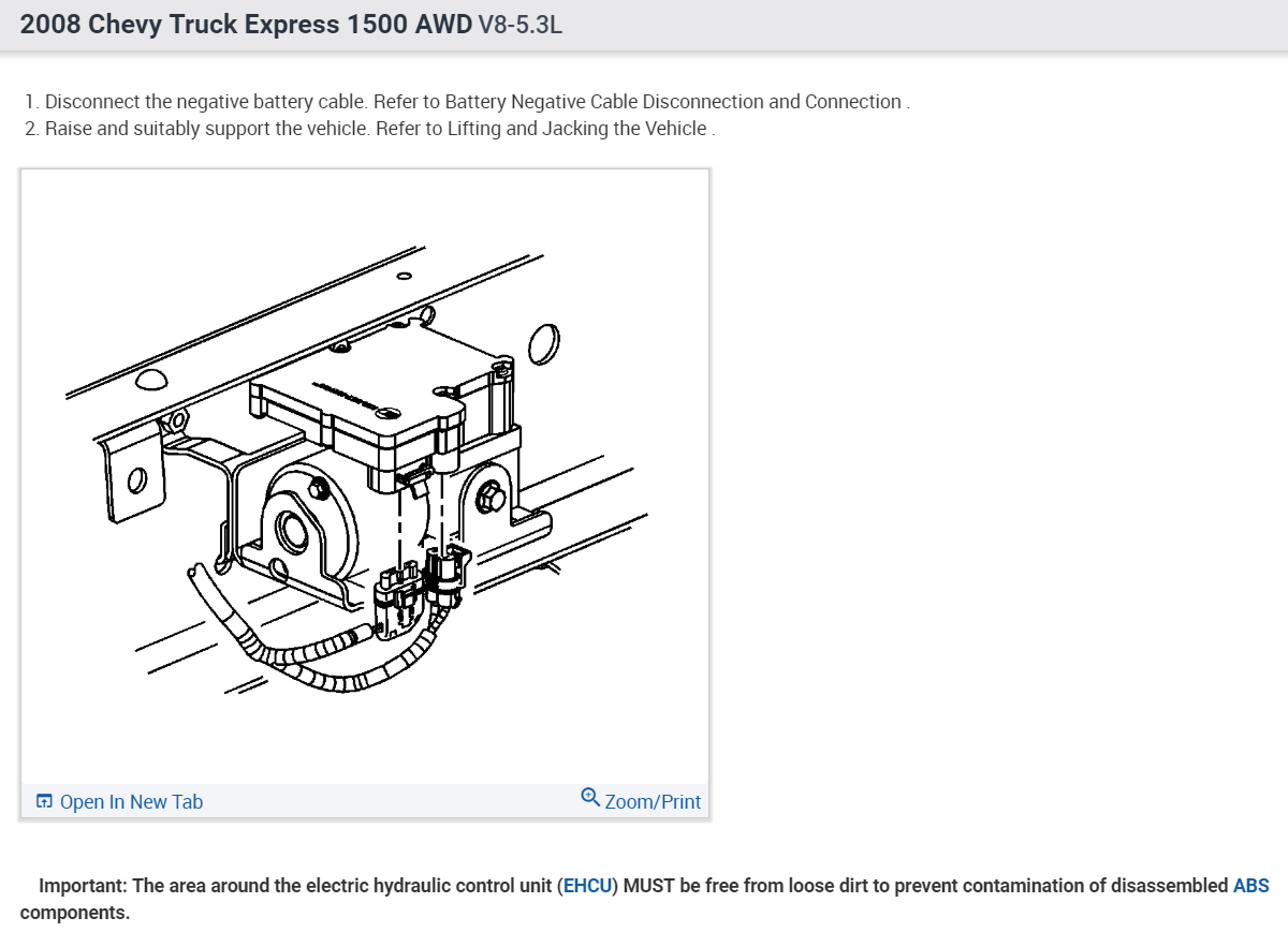

I removed and thoroughly cleaned the throttle body and performed a manual throttle body relearn procedure, then drove the van for twenty five to thirty miles and did another relearn but I am still having high idling issues, will this eventually smooth out on its own? Also, I forgot to mention this was a Texas vehicle so the under-body is amazingly clean and all grounds and wiring look great. I am still getting the P0050. I removed and inspected the ABS module but cannot see anything obvious, do you think it is a bad module?

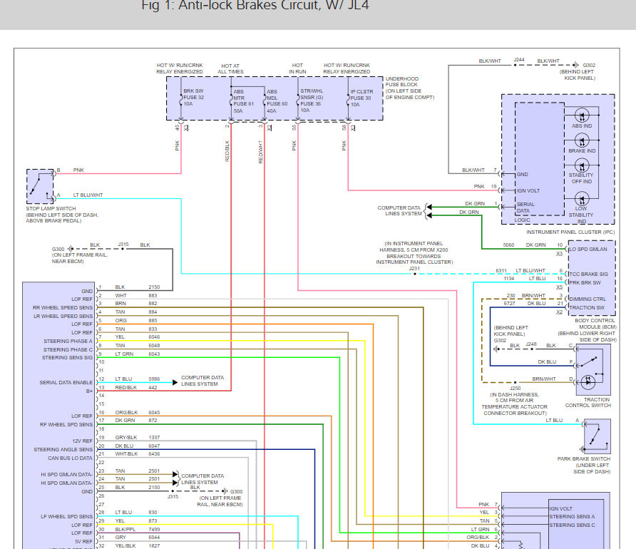

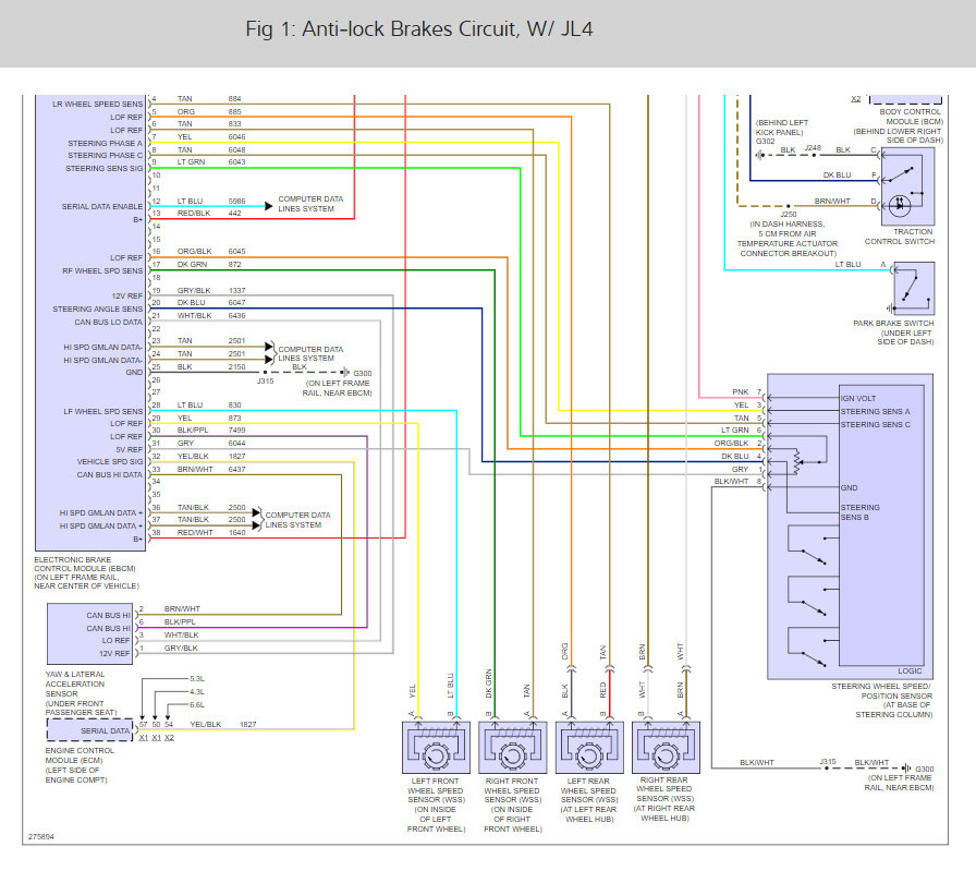

Lets check the connection between the ABS module and the sensor use the wiring diagrams for the ABS above and the guide. Here is the location of the module below.

I_MBOWTIE
  • 40 POSTS
Update, on the C0050 after a thorough inspection I found a nick in the right rear speed sensor wire leading to the EBCM about two inches "inside" the wire loom, must have been there since production since it was found inside the loom, after repairing it the code no longer returned. Thank you for all your time and references.
