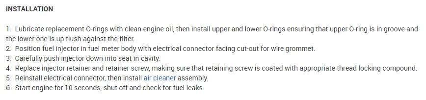

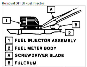

Hello, I'm Danny.

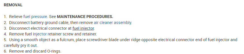

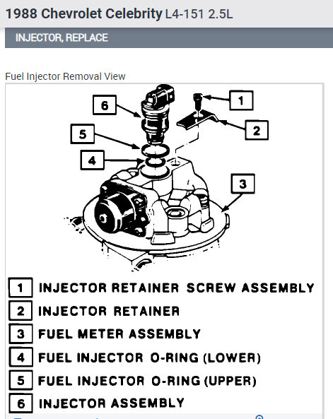

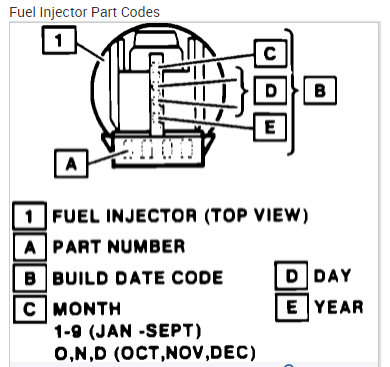

It sounds like you might have a defective, clogged, or weak fuel injector in the throttle body. I've attached picture steps below on how to change the throttle body fuel injector on your Celebrity. Keep us updated. Hope this helps and thanks for using 2CarPros.

fuel injector is fine swap out with a good one. still doing the same thing. just really at a lost with this car .

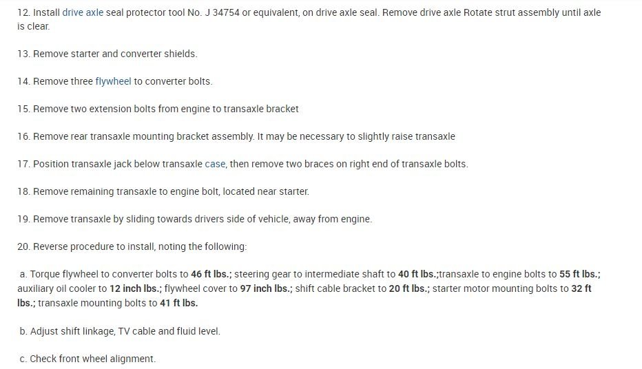

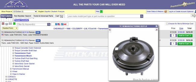

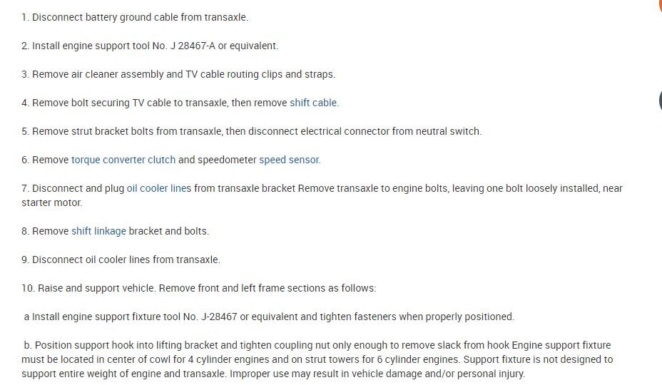

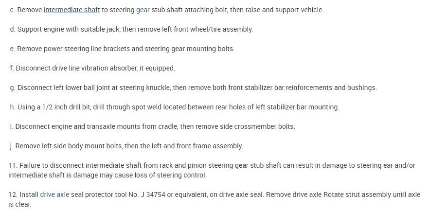

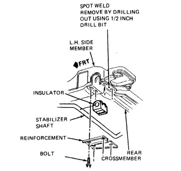

Okay, you confirmed it needs a torque converter. You need to replace the torque converter before going any further.
The transmission must be removed to gain access to the converter. I attached the procedure below for you to view.
