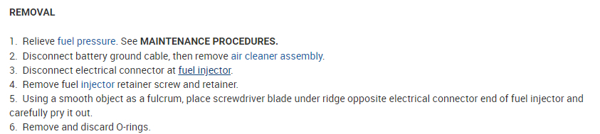

I have been having problem from day 1 got the car for $150.00 With 55,000 miles but can't seem to find out the problem. it'll start fine try to rev it up it'll some times rev up no problem other times it'll act like it only half power try to put in gear and drive it'll bog out and shut off. restart runs rev it up a little and put in gear it'll move but keeps bogging down until it shuts off. just put a new fuel filter and fuel pump thinking that'll be the problem but it's not list of all parts that been put on over the time of hunting this problem out etc., any idea let me know.

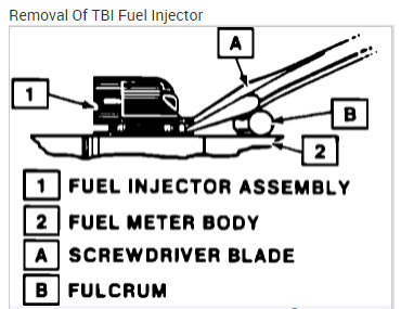

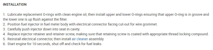

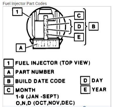

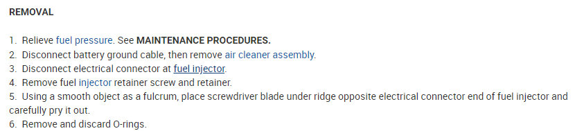

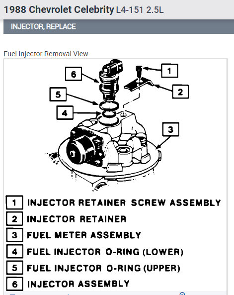

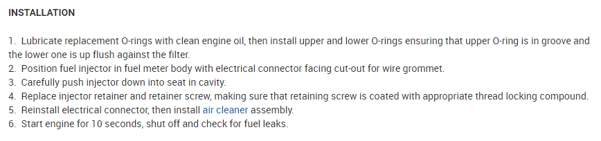

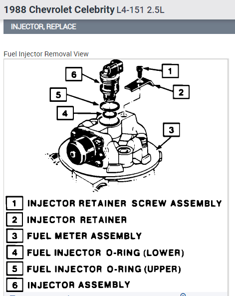

Hello, I'm Danny.
It sounds like you might have a defective, clogged, or weak fuel injector in the throttle body. I've attached picture steps below on how to change the throttle body fuel injector on your Celebrity. Keep us updated. Hope this helps and thanks for using 2CarPros.
Sep 13, 2021 at 11:26 PM
BIGD94
  • 13 POSTS
fuel injector is fine swap out with a good one. still doing the same thing. just really at a lost with this car .

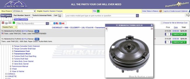

I still believe that you have a bad torque converter in the transmission. It is locked up internally.
Sep 19, 2021 at 8:53 PM
BIGD94
  • 13 POSTS
Well, it drives now I unplugged the TTC but can't give gas more than half way it not it'll stutter real bad and start missing out until I left off.
Sep 20, 2021 at 1:22 PM

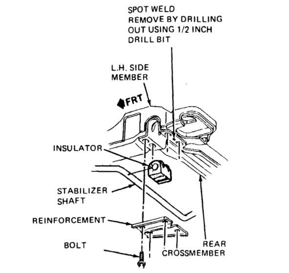

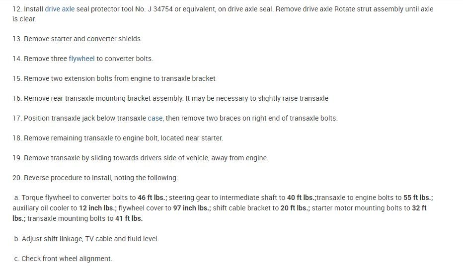

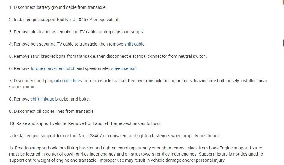

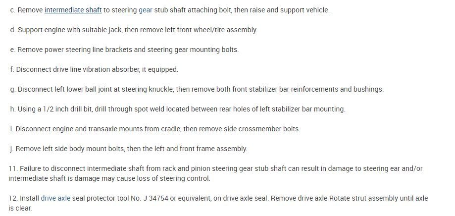

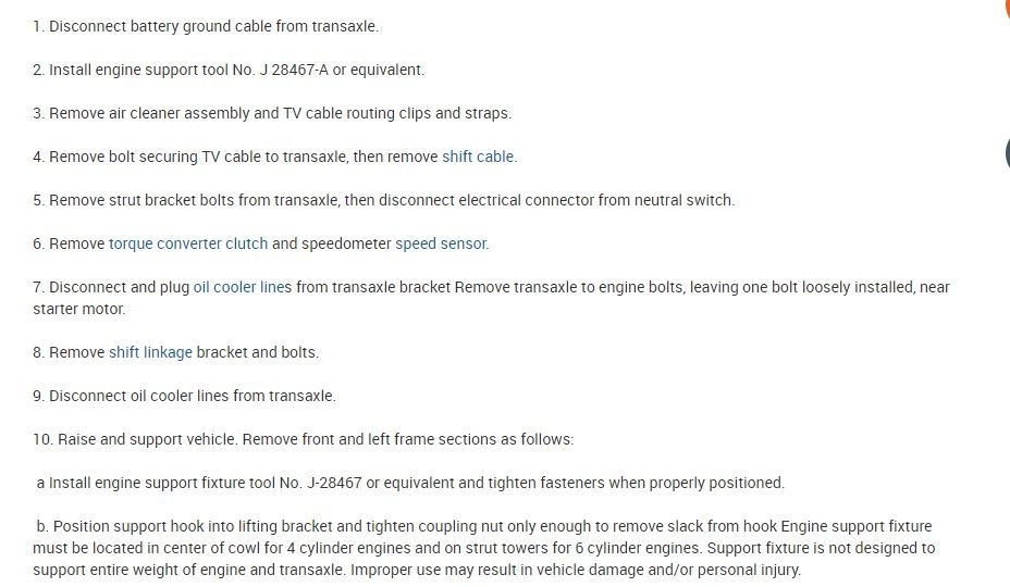

Okay, you confirmed it needs a torque converter. You need to replace the torque converter before going any further.
The transmission must be removed to gain access to the converter. I attached the procedure below for you to view.
Let us know if you have any other questions.
