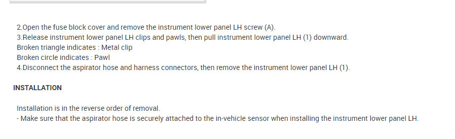

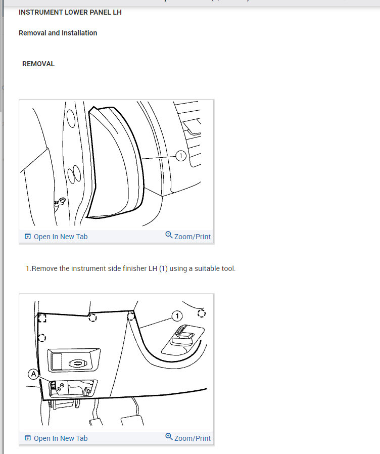

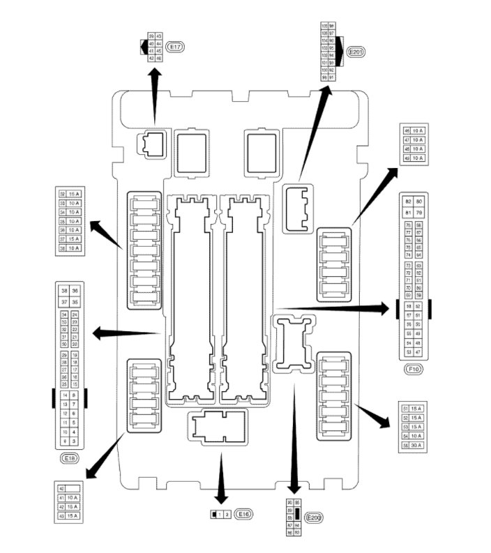

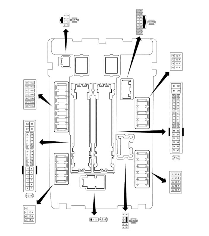

You have a fuse panel under the hood and in the dash.
Here is a guide that will help with testing and replacing the fuses as it gives step by step instructions:
Below you will find the location and layout of the fuses. Please run through this material and let us know if you have other questions.
