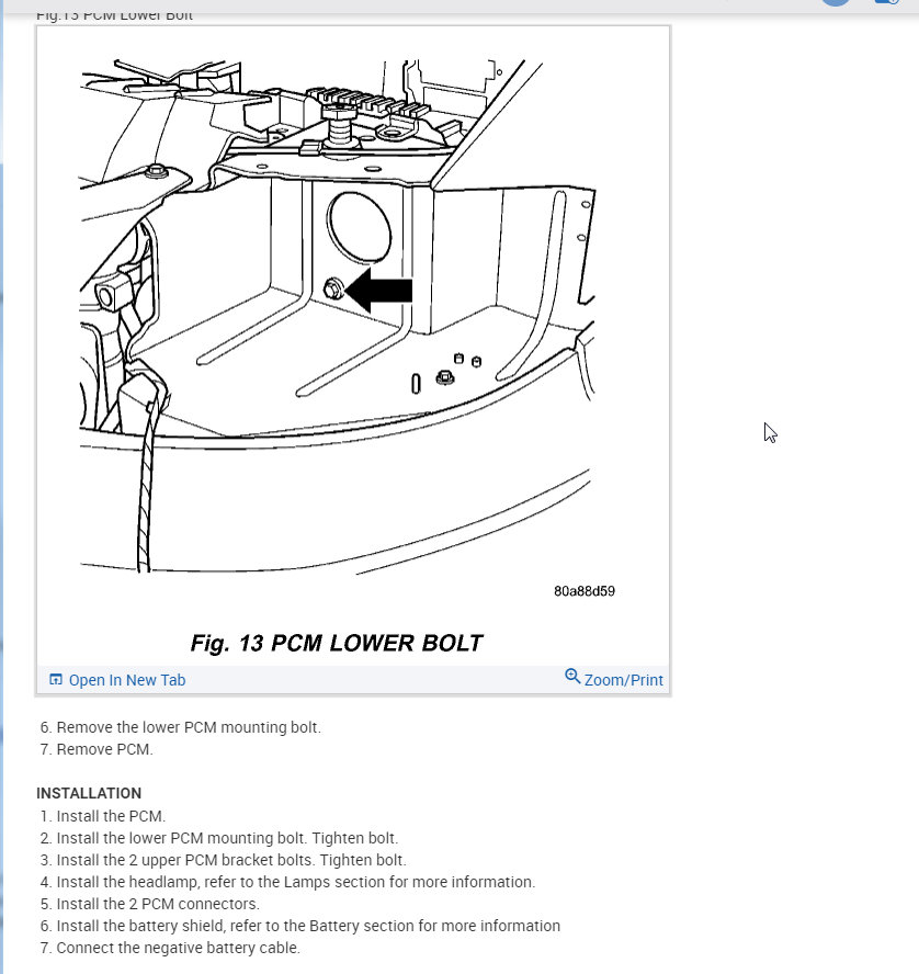

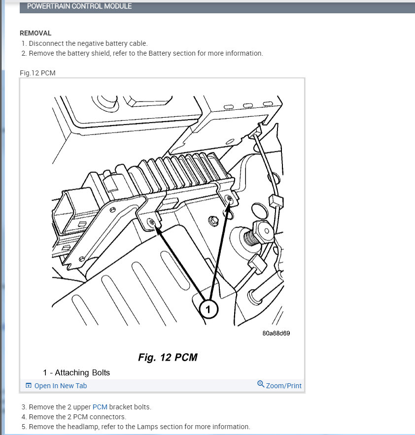

Stalls when it gets up to temperature and wont start until it cools or unhook battery 5 minutes. gets Dtc's p0123, p1193, p0118 and p1598.
Also if I tap on PCM it will stall also, so I'm sure it's bad.
Sep 3, 2020 at 8:47 AM

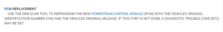

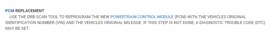

This was a pretty common thing on these older Chrysler vehicles. The PCM gets a loose solder joint and it causes this issue. The telltale is tapping the PCM. We need to replace this and then retest all the other issues however, I am sure this will fix them.
I attached the process. You need to program the PCM after replacement unless you find one that the company programs it for you prior to sending it.
