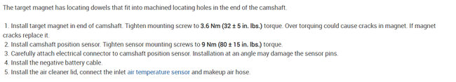

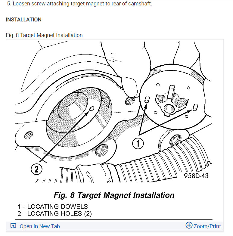

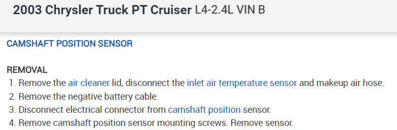

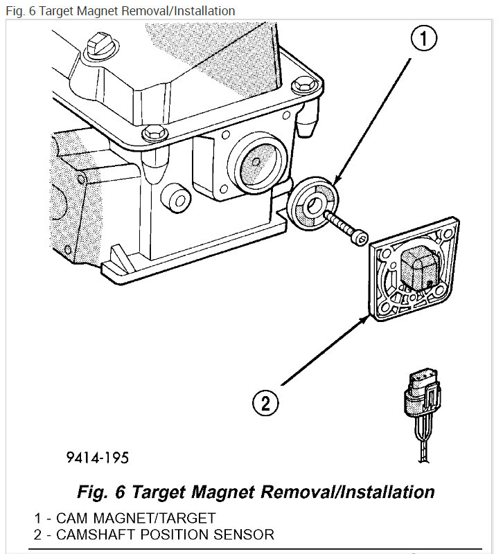

Now I have a P0344 and P0339 code, Cam Shaft Position sensor A circuit intermittent Bank 1 or single sensor, sensor A circuit intermittent. Where is the sensor circuit located, any idea? (I've already changed the crankshaft position sensor)

This can be a timing belt that is getting ready to let go and not keeping the correct timing for the camshaft to crankshaft orientation.
P0344 - Camshaft Position Sensor Circuit Intermittent
P0339 - Crankshaft Position Sensor A Circuit Intermittent
Them camshaft sensor is under a cap at the rear of the cylinder head, here is the location and how to replace it. If it doesn't help I would replace the timing belt. Check out the images (below). Please let us know what happens.
