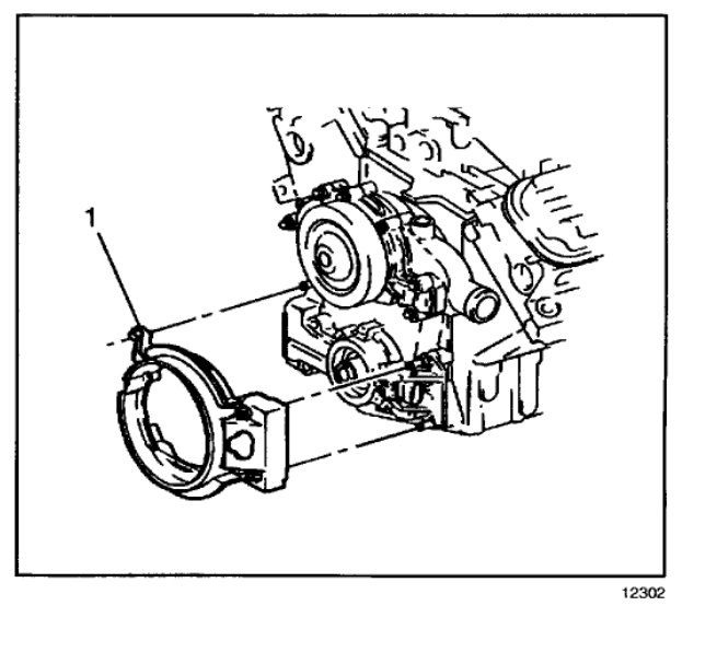

After driving for about thirty minutes it stalls then high rpm on restart. turn key off then restart rpm normal. Then drive and stalls then high rpm on restart. Had code po133 replaced upper o2 sensor. Problem not solved.
Oct 5, 2017 at 8:52 PM
  • 55,691 POSTS

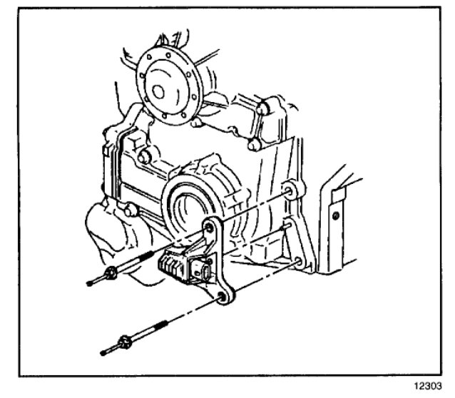

This sounds like a classic crankshaft angle sensor that is no good.
Here is a guide to show you what you are in for when doing the repair:
Below is what it will be like on your car.
