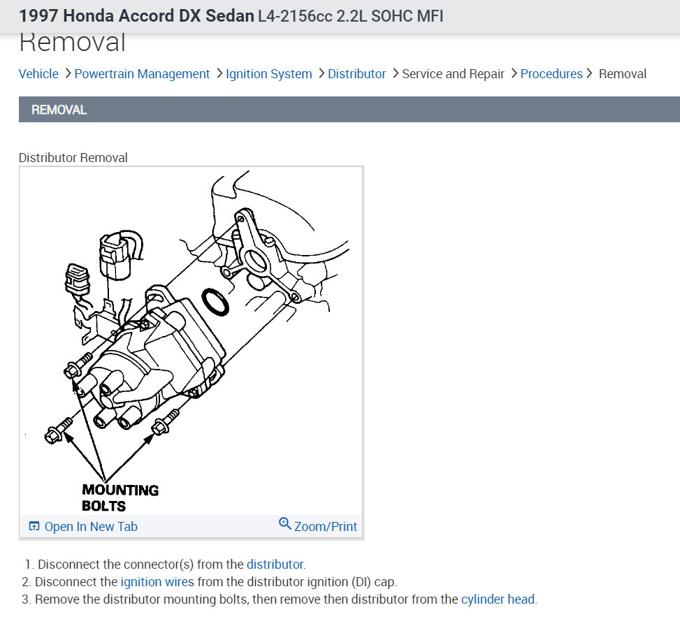

Stalls out when driving, intermittent, occurred maybe 7 times?
150,000 MILES • 2.2L • 4 CYL • 2WD • AUTOMATIC
JOHN.A.NADAI
side street speed, e.g. 10-35 MPH.
May stall and car rolls to a stop, or engine may restart while rolling, on its own (tachometer at zero for short time then recovers).
No check engine light.
Almost always restarts by putting in P or N and turning the key. A couple of times it cranked but did not start immediately but did on the second try.
No loss of power, no rough idle, no misfire, nothing wrong while car is running. Idle is 700-750 once warmed up.
Main relay (2 in the box) replaced but did not fix the problem.
No smell of gas.

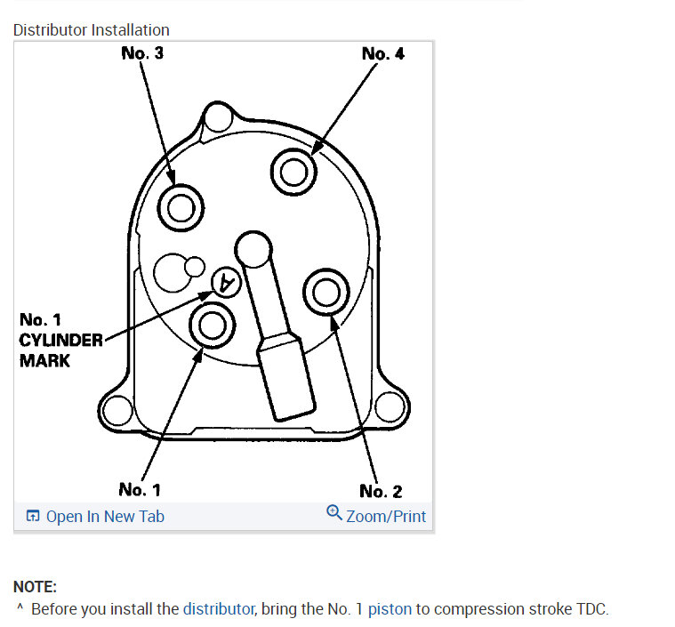

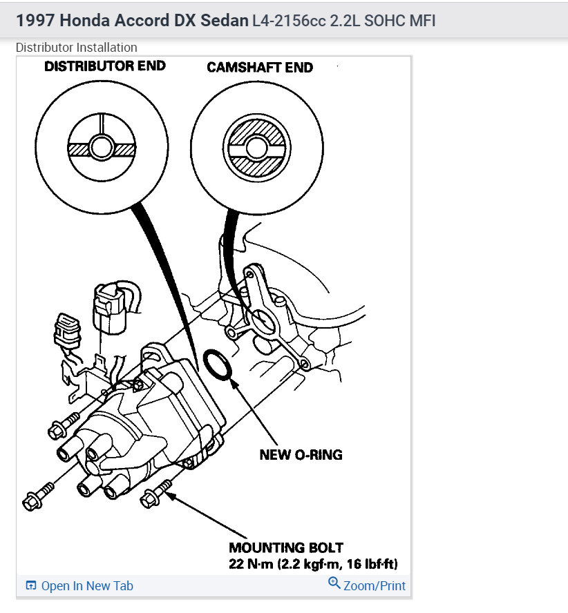

This is common when the distributor goes out. here is how to change it out in the images below, you can get a rebuilt unit by searching amazon. Here is a link:
https://amzn.to/3XGb72R
Check out the images (below). Please let us know if you need anything else to get the problem fixed.
