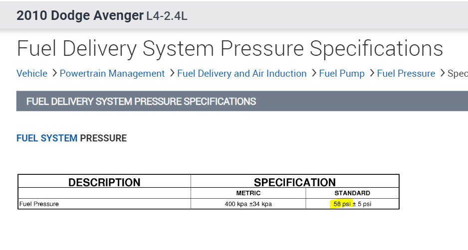

What you described could be a couple of things. For example, low fuel pressure, a partially plugged catalytic converter, or even an engine vacuum leak can cause this.
Personally, I feel it is most likely low fuel pressure. When you press the throttle to accelerate, there is more of a demand on the pump. Based on your description, that is what it seems to be.
The fuel filter is in the tank with the fuel pump module. However, this vehicle has an access port under the rear seat to access the pump. That makes it a little easier.
Here is what I suggest. I would start by testing the fuel pump pressure. That will tell us if that is a concern.
Here is a link that explains in general how it's done:
You will need a fuel pressure gauge, but most parts stores will lend one to you. Additionally, I attached the manufacturer's fuel pressure specifications specific to this vehicle below.
Let me know if you have questions or what you find.
joe
See pic.
