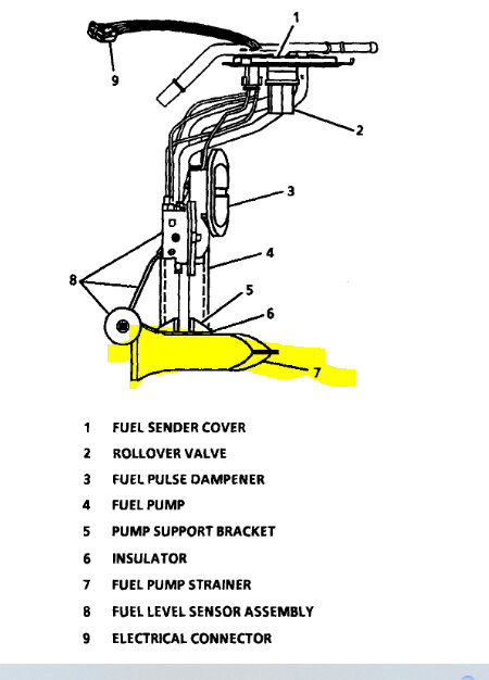

Engine stumbles and stalls in right turns seldom left but sometimes. Restarts easily. My first thought is fuel pick up, but the issue happens at half tank. Or the tank baffles aren't doing what they do. The car is in good repair given its age never wrecked.

That is an odd one. As far as baffles, I don't feel that is an issue. Does this happen when the tank is full or above half tank? Has the check engine light ever stayed on when the engine is running?
As far as the fuel tank is concerned, there is a strainer that prevents dirt from reaching the pump itself. Fuel stoppage at this point would indicate that the fuel tank contains an abnormal amount of sediment or water. However, turning could cause it to get blocked if it is dirty enough. In this case, the tank should be thoroughly cleaned, and the strainer replaced. (See pic below)
Let me know your thoughts on my ideas.
joe
See pic below.

I just started to siphon some gas out and I found the trunk half full of water from recent rain. When it dries up, I'm confident the issue will bite me on the nose. Got to say your advice is great left me with no questions easy to understand and knowledgeable. nice. Well done. Thanks again I'll find out very soon if it's debris or water. (likely water). I should've known that. Glad you did.

Hi yeah, I got a lot of water sloshing around. I dumped the tank flushed it out (that was a chore. Glad it's only once) heated it up a little bit to evap any moisture out, a new seal on the bracket/ cover and it started ran and went for some excessive and unsafe cornering without any stumbling or stalling. That was a lot of work but it paid off well. I am not walking, and I get to drive like a madman for a few minutes. Thanks a lot.
