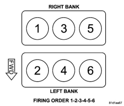

Based on the diagnostic trouble codes you listed, this has nothing to do with the transmission.
First, the P0201 and 202 are fuel injector issues with cylinders 1 and 2. The other codes, P0301 and 302 are cylinder misfires. Since the two problems are related to the same cylinders, chances are there is a problem with the fuel injectors on those cylinders. Thus, they are causing a misfire on the same cylinder.
Diagnostics can become involved because either you have an open circuit (meaning power can't make it to the injector) or a short to power (meaning constant power goes to the injector).
Regardless, replacing plugs may be necessary, but will not fix the problem. The first thing I need you to do is check the wiring to numbers 1 and 2 injectors. Make sure there is no evidence of damage, disconnect them and check for corrosion...
I attached a picture of cylinder location. The arrow on the left side of the picture points to the front of the vehicle.
