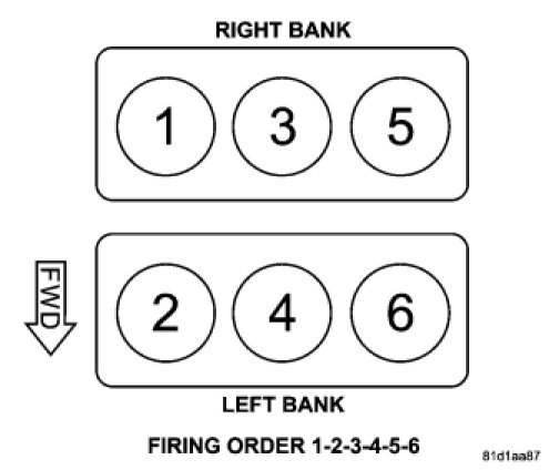

Based on the diagnostic trouble codes you listed, this has nothing to do with the transmission.
First, the P0201 and 202 are fuel injector issues with cylinders 1 and 2. The other codes, P0301 and 302 are cylinder misfires. Since the two problems are related to the same cylinders, chances are there is a problem with the fuel injectors on those cylinders. Thus, they are causing a misfire on the same cylinder.
Diagnostics can become involved because either you have an open circuit (meaning power can't make it to the injector) or a short to power (meaning constant power goes to the injector).
Regardless, replacing plugs may be necessary, but will not fix the problem. The first thing I need you to do is check the wiring to numbers 1 and 2 injectors. Make sure there is no evidence of damage, disconnect them and check for corrosion...
I attached a picture of cylinder location. The arrow on the left side of the picture points to the front of the vehicle.
If all looks good as far as wiring and condition, then I need you to test for an injector pulse. Basically, you are checking to see if there is power to each injector. You will use a test light for this process. I will provide directions on how one is used as well as how to check an injector. Note: When you check the injector, the test light should pulse on and off.
https://www.2carpros.com/articles/how-to-test-a-fuel-injector
Here is another link you may find helpful:
As I mentioned, the cylinder misfire codes (301 and 302) are the result of the injector issue (201 and 202). Once we figure out the problem with the injector, the misfire will go away.
